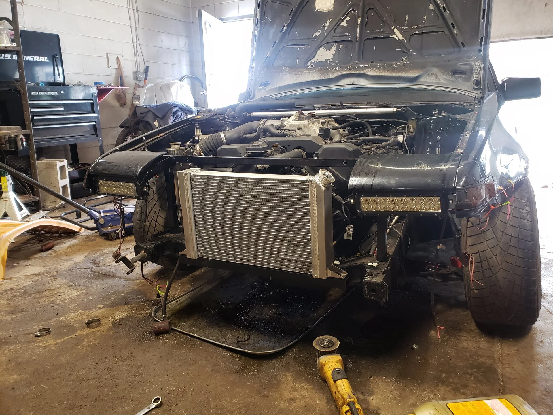

A stock FJ40 cooling system is plenty adequate for a 2F. Chances are the radiator itself is not flowing sufficient water. Because it is a vertical downflow rad, all the sand and gasket debris ends up layered in the top tank of the radiator, restricting flow down through the tubes. Have a rad shop open the top tank, "rod out" the tubes and dispose of gunk. Or just get a new HD radiator to cool the pending 1FZ.
Done. Ordered the mid-level alum Champion Rad Monday. The 500 hp version. Be here Saturday.
Like you said Jim, with the 1FZ around the corner, I would need to do it anyway.

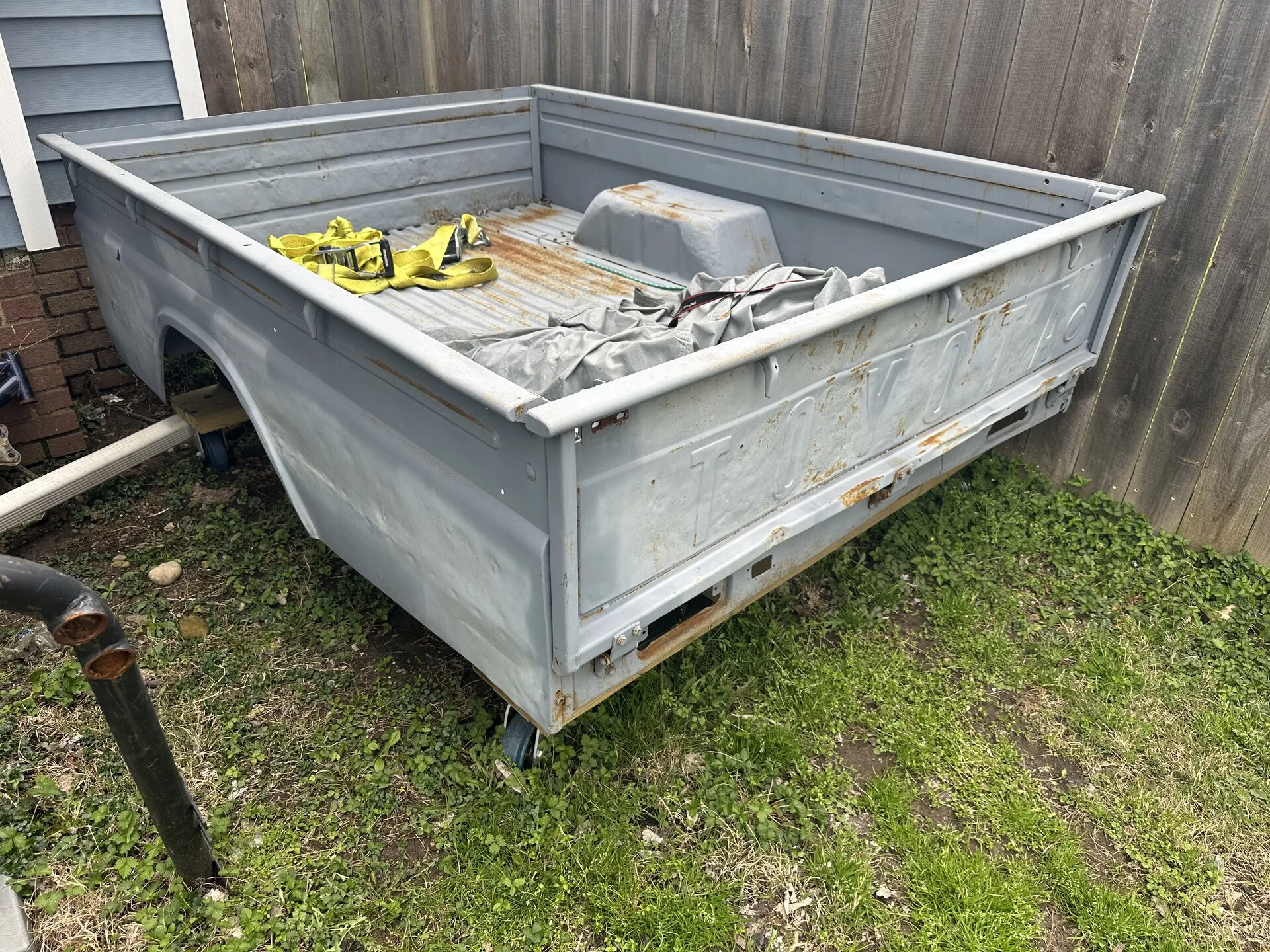

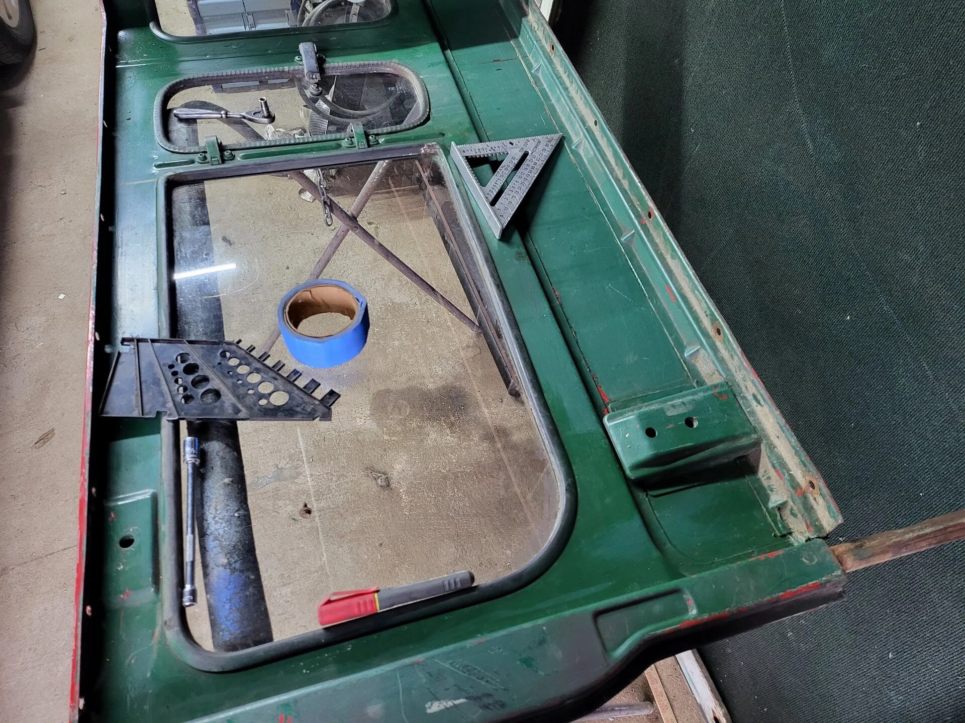

The 40 was in desperate need of a new tub and I always wanted to build a pickup. So that’s what I’m doing.

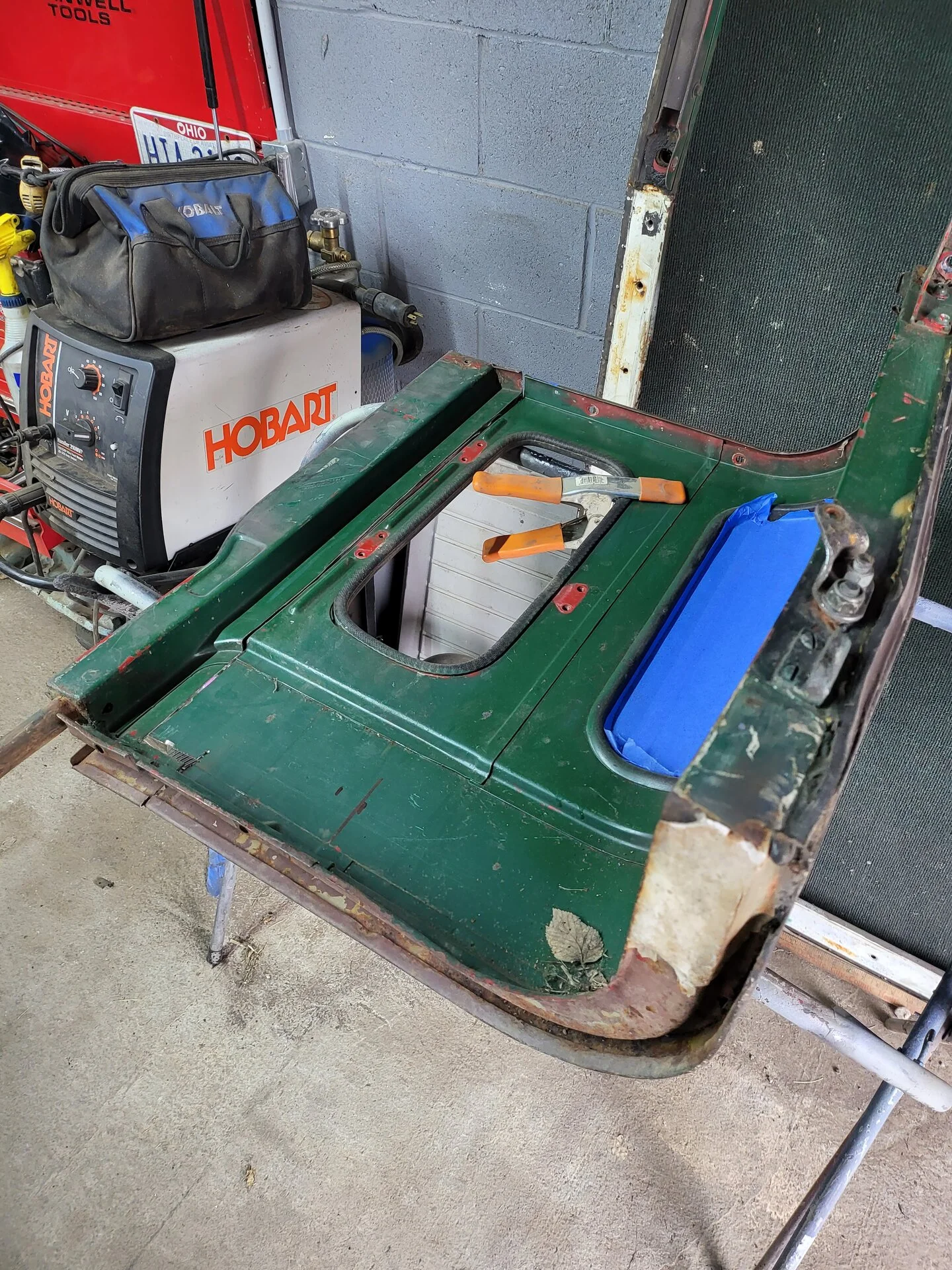

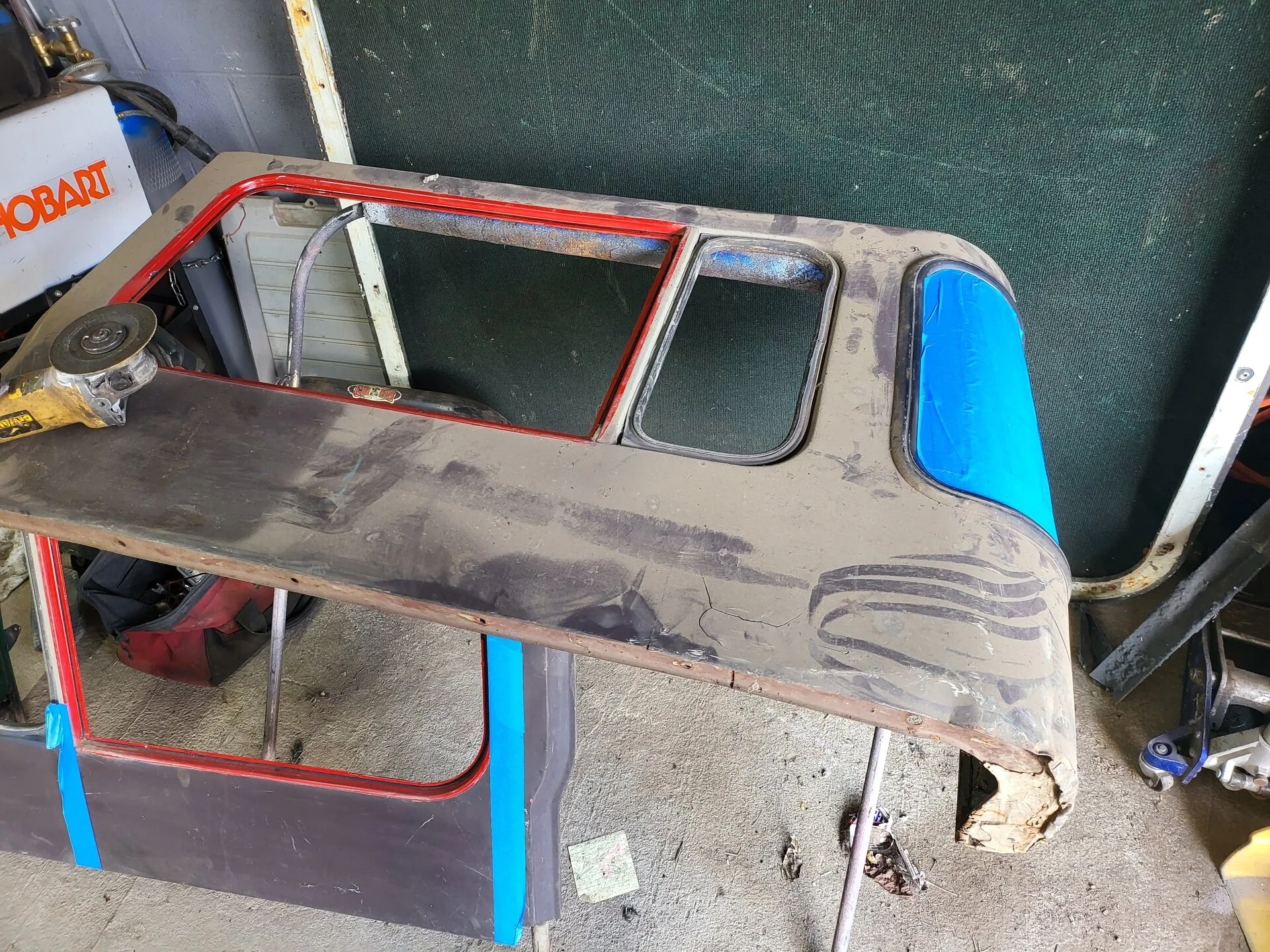

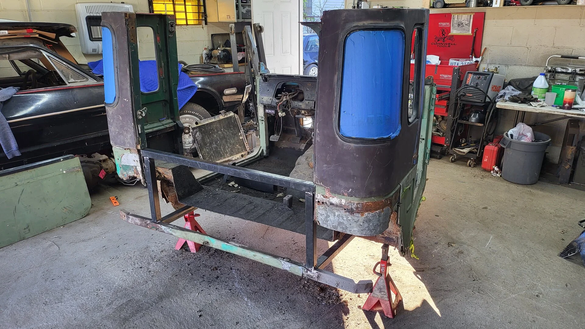

I have cut the 40 and frame and top. Slowly but surely piecing it all back together. I cut the body up at my old shop before I got rid of it. From the door back there wasn’t much of the original tub left.

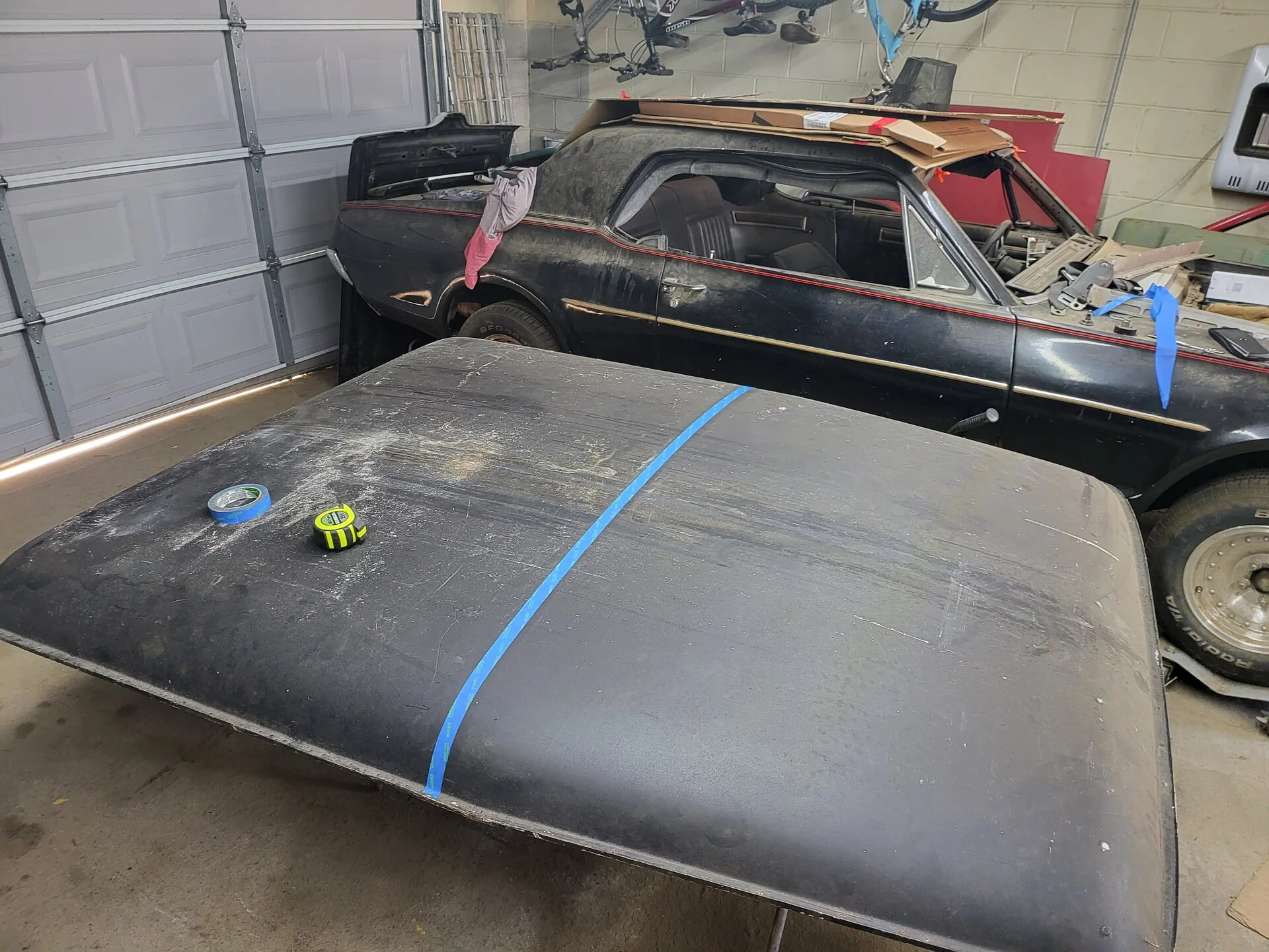

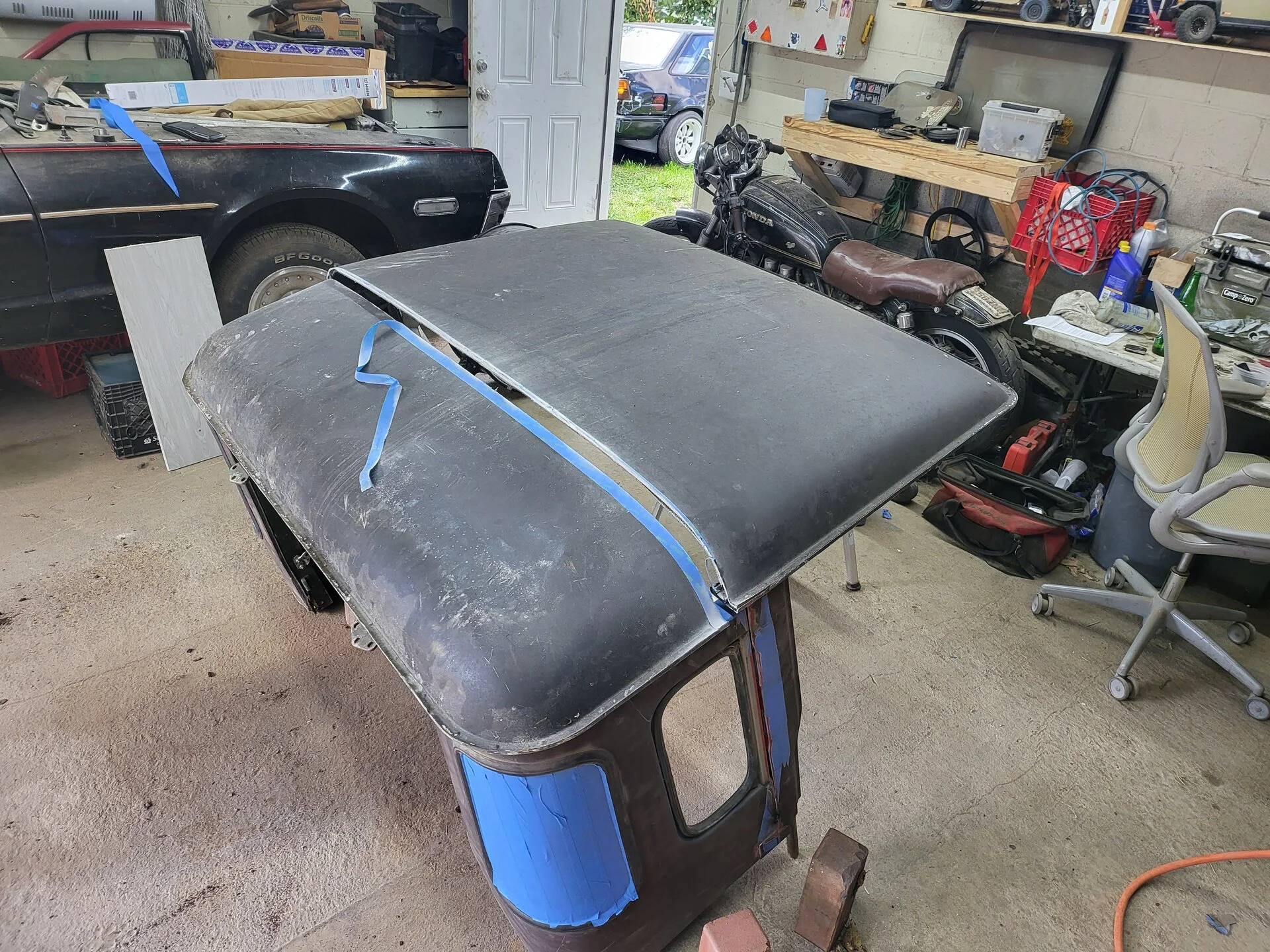

I then started on the top. I basically just took out the large side window.
and cut the fiberglass and fitted it together.
Sorting out the rear. Still using the rear hatch.
And a shot of it all together.

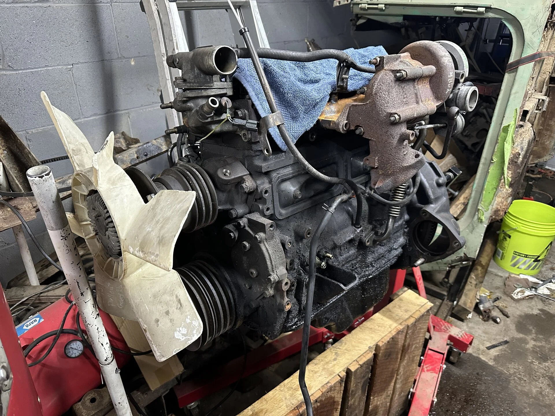

Engine: 4bd2t
And what will bring it all together
