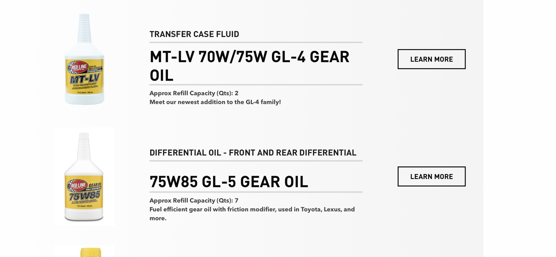

Much more info and some interesting physical observations of the official toyota stuff here:
meets Toyota specs - not crazy priced
I bought Redline for both the diffs and t-case like these listed above. I'll be swapping the factory stuff out for the Redline goo next week at 60K miles.
I did the 2nd change with Redline last week.. no forbidden glitter was found from either Diff or the Transfer Case when I dumped them.

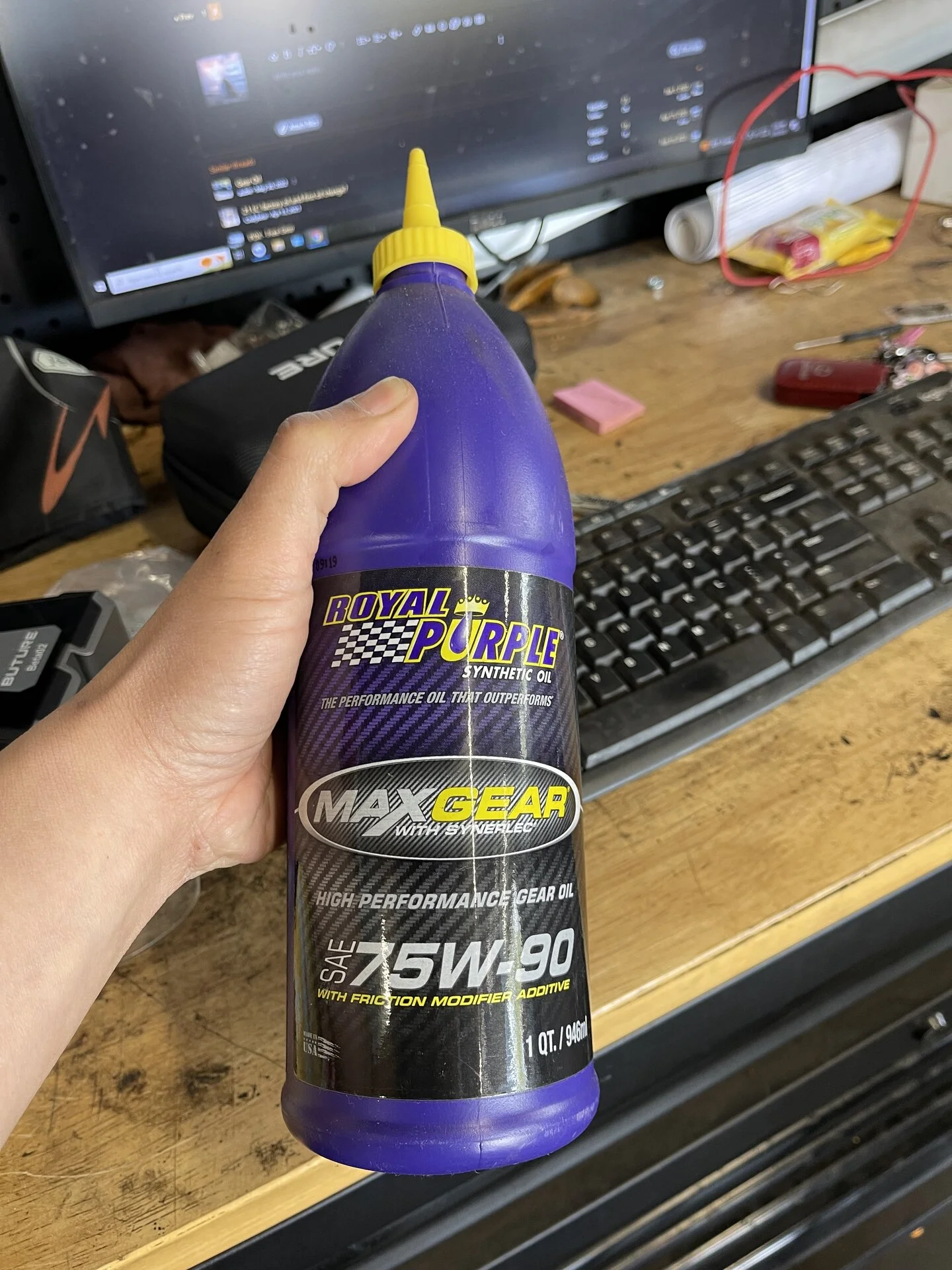

I’m getting ready to do my 2013 LX570 rear diff and TC. I have this lying around from my last 100 series, is it okay to use? What’s friction modifier is that like limited slip additive ?
I have only been able to het my hands on Valvoline 75w-90 but it has the limited slip additive. I don’t have LS diffs but truing to find a gear oil minus this additive is crazy!
Did you ever proceed with the Valvoline? It's the only one available to me locally too. Altho I suppose I can wait a few days to order online from redline or so. I have a 2008 that straight up calls for 75w90 GL5. So none of this 75w issue for me. Would like to use the Valvoline 75w90 if it means I can buy two gallons and get Tcase and both diffs done.
I can’t speak to the tcase, but don’t think our diffs are sensitive to limited slip additive vs not.
