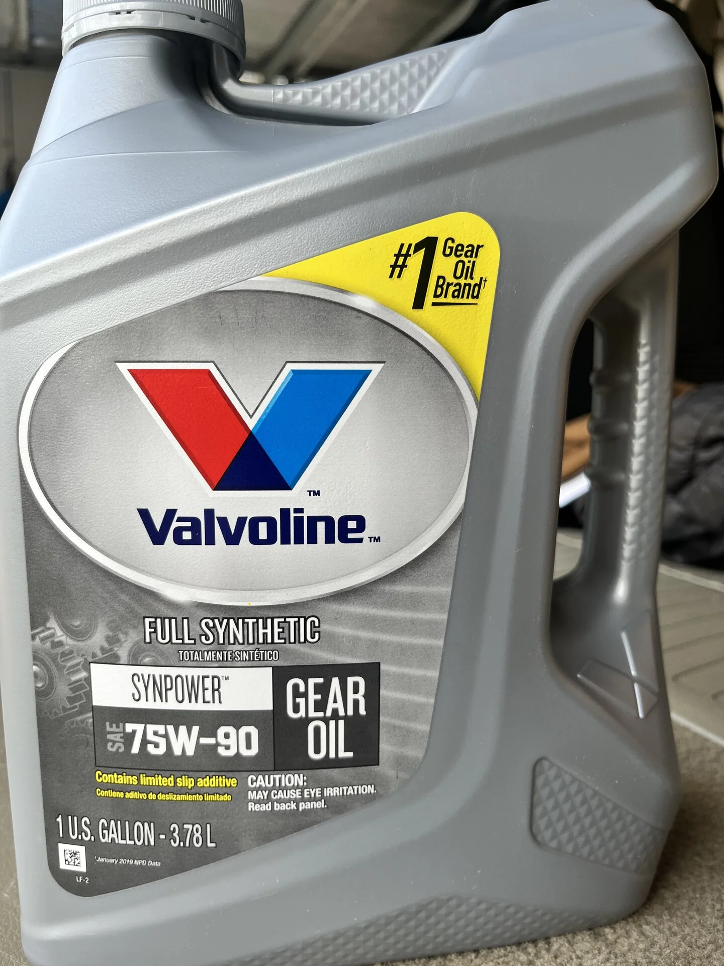

What are you guys using for gear oil for diffs and transfer case. I have only been able to het my hands on Valvoline 75w-90 but it has the limited slip additive. I don’t have LS diffs but truing to find a gear oil minus this additive is crazy! Also, is it suitable for the transfer case? I believe it is, just trying to get confirmation from people who have used it!

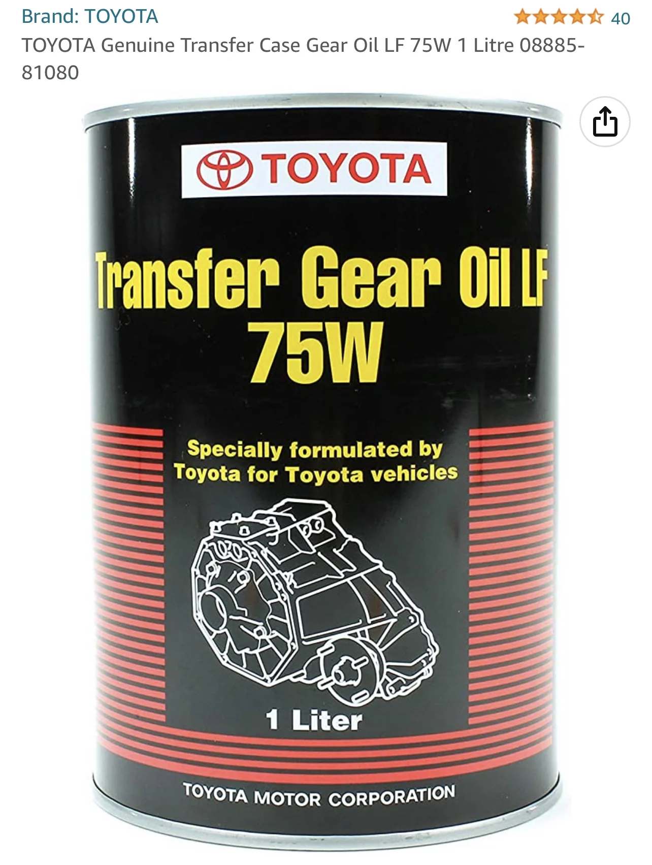

Lots of guys use this in their transfer case and differentials. Some swear that the Toyota transfer case LF fluid is the only one that's safe for the transfer case. I think most dealerships are using 75W90 when they change the Transfer case, rather than the very expensive Toyota LF fluid. Personally, I use 75w90 in the diffs and Toyota's fancy sauce in the Transfer case.
I have no idea what fancy additives are in the Toyota LF 75w, but I'll take their engineers judgement over my own. At the same time, I don't think you'll destroy your transfer case with 75w90

Does it say GL5 on it somewhere?
Yes it is GL-5

Toyota magic 75W for the transfer case and Amsoil for the diff's. I too would suggest using the search as there's MUCH more detail (and alternative products) buried in those pre-existing threads.

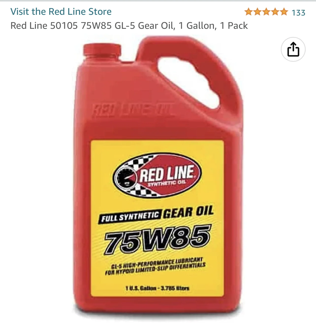

Local Toyota dealer here in Denver uses 75w90 for all diffs/transfer case. So I put in GL5 redline in mine at 30k miles. Seems to be working just fine.

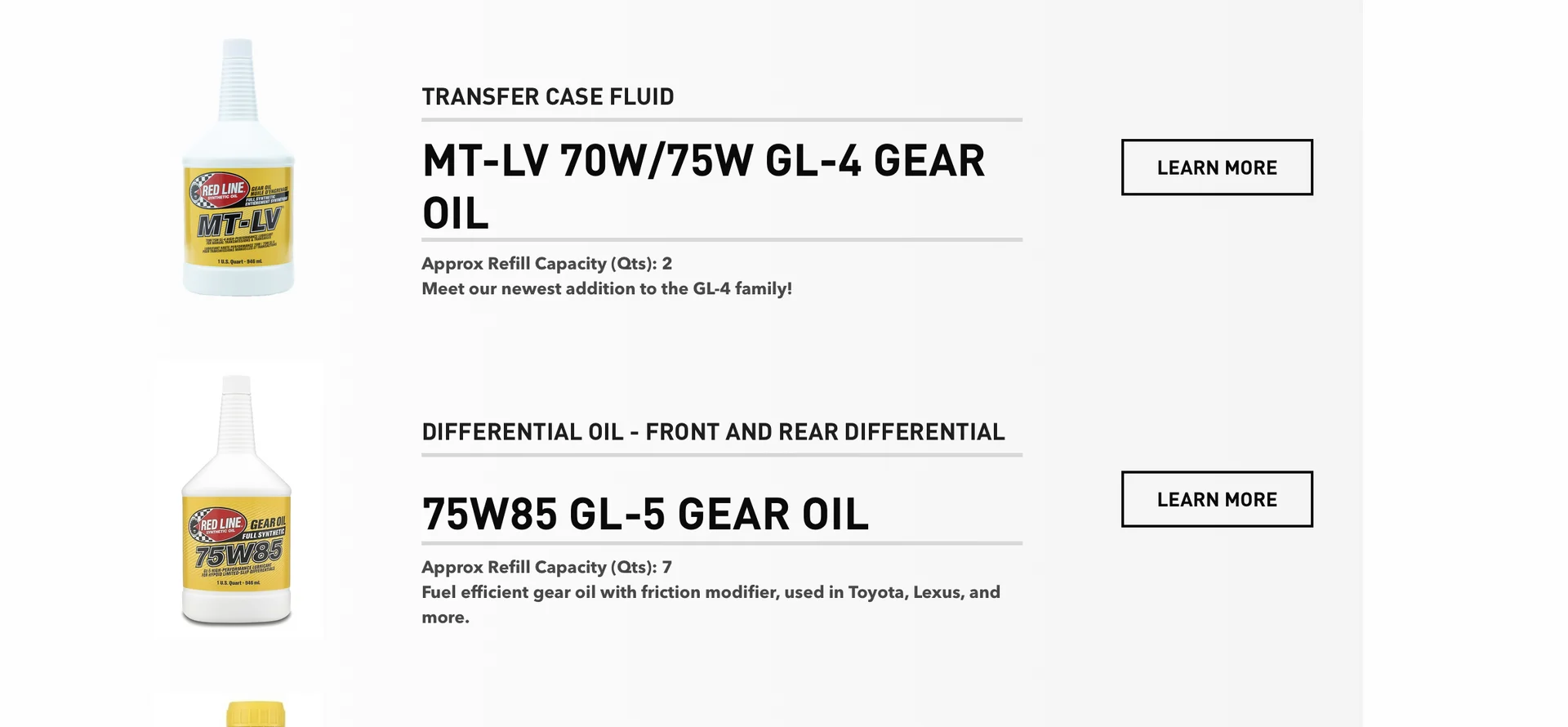

meets Toyota specs - not crazy priced

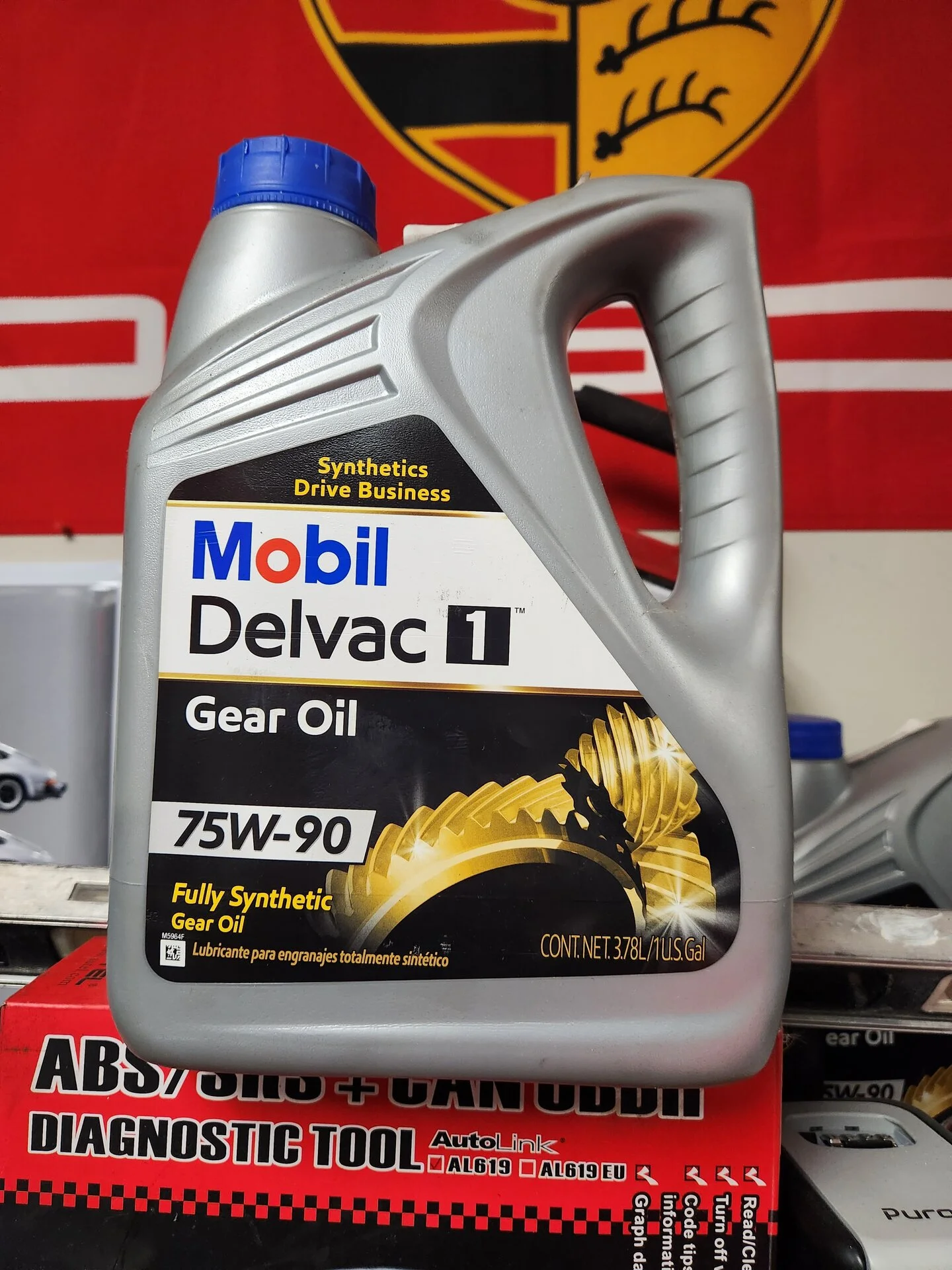

Always this:
