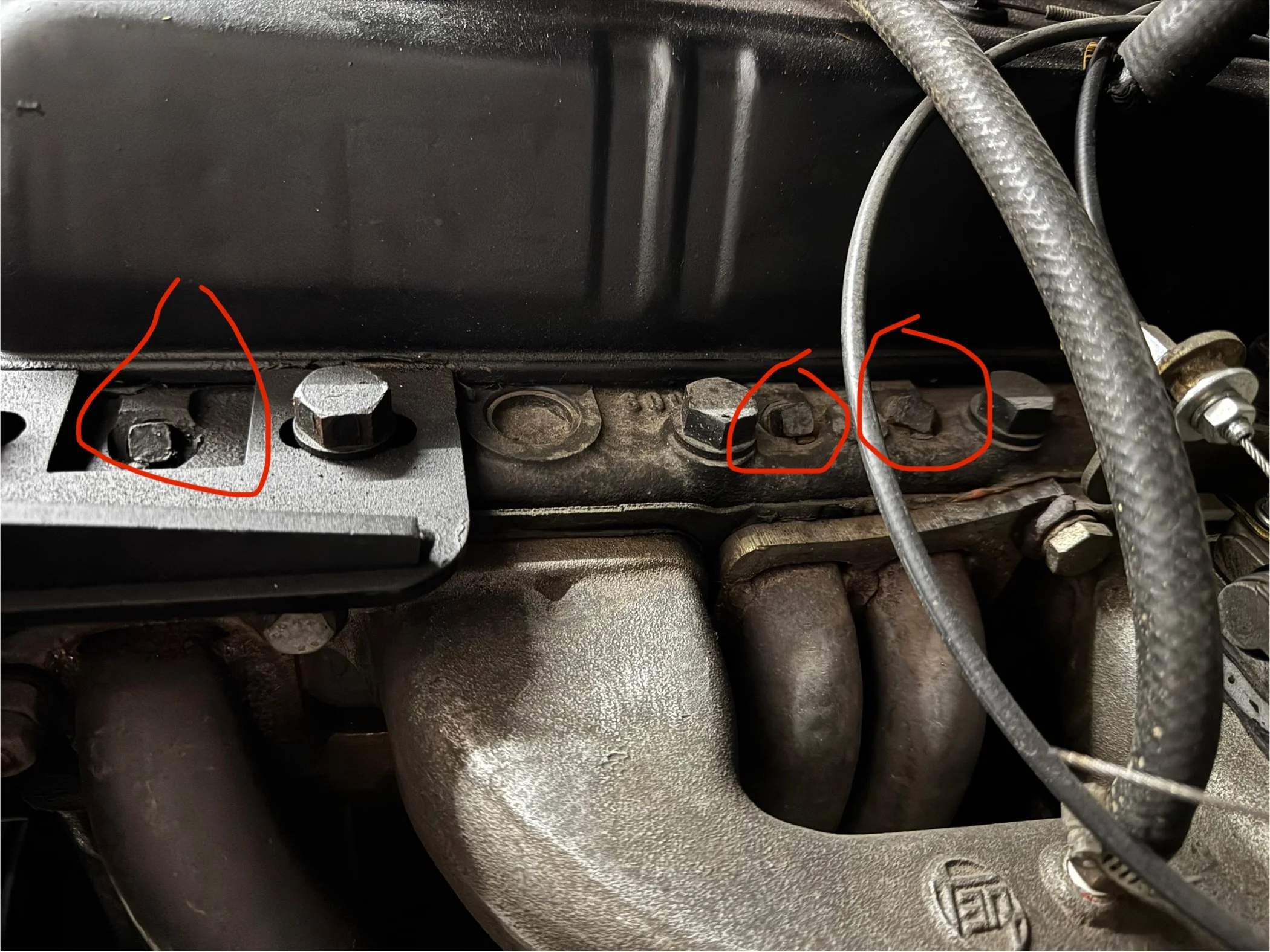

Those holes are for the air injection into the exhaust gasses for emissions reduction, they don't communicate with the combustion chambers. There's kits for blocking off those holes, that's about it.

The picture below shows the plugs circled in red there are 6 of them.

The picture below shows the plugs circled in red there are 6 of them.View attachment 3871181
Note how they're inline with the exhaust.

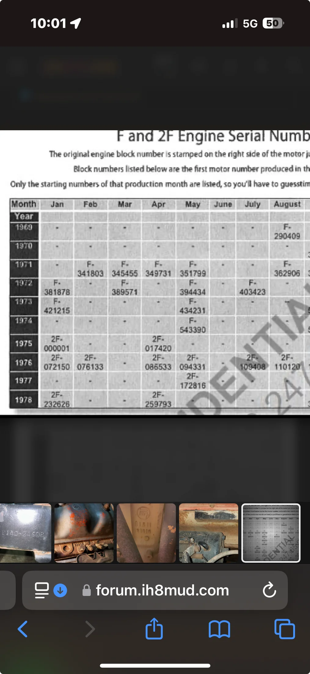

I checked with the serial number against the Toyota serial number reference.
This from the midstream sheet July 74 there is a 2f engine. I was surprised but I can hardly read the id plate. There is too much caked on grease to take a pic of the engine number on the block. I'll take some either to it or acetone to cut through 5the grease.

Note how the 2f serial numbers start at 000001 in jan 75.

Hommie, it's your chart, that you posted, that showes 2F serial number 1.. jan 75.

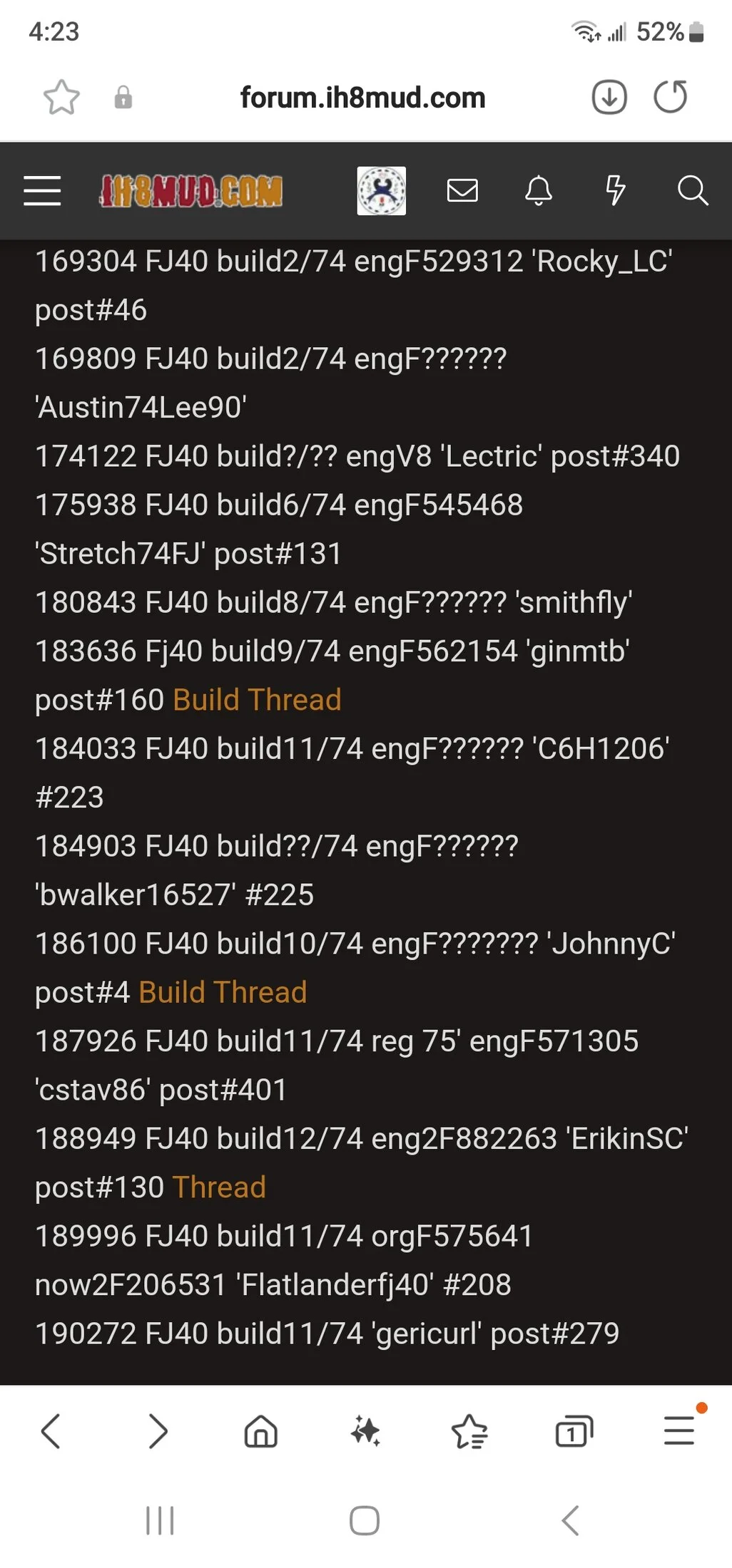

If you would also reffer to the 40 series registry, located in this forum, you would notice that there are roughly a dozen 74s on the list made after July 74 through Dec 74, that all have f engines.
Post the serial number of the engine, and you'll see real quick when it was made.
There's even a date code on the head.
