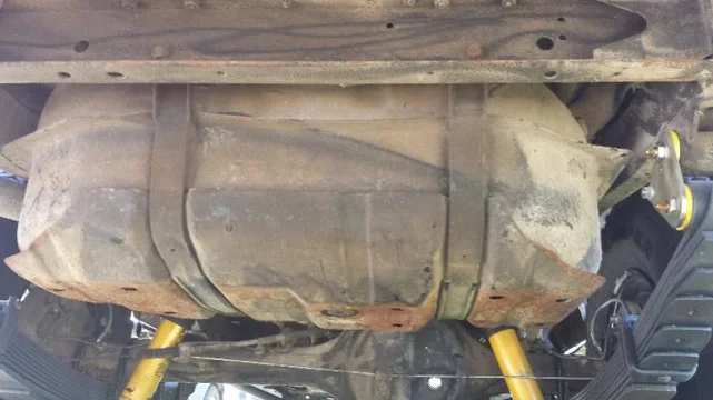

That's correct. People rotate the 70 series tank so the filler will end up to the LH of the vehicle when they mount it on an 80 series. I just double checked this information with a couple of friends from Venezuela.
I will ask my friends to see if they can find some good photos of the install.
Excellent pics Clint, thank you. As stated already, by rotating the tank, it appears as though the fill position is slightly aft of the center of the tank. Shouldn't be too big of a deal for the dual filler neck to work with this scenario.

I have a 70 series tank AND an 80 series frame I will be visiting tomorrow and can take a photo of it mocked up for you.

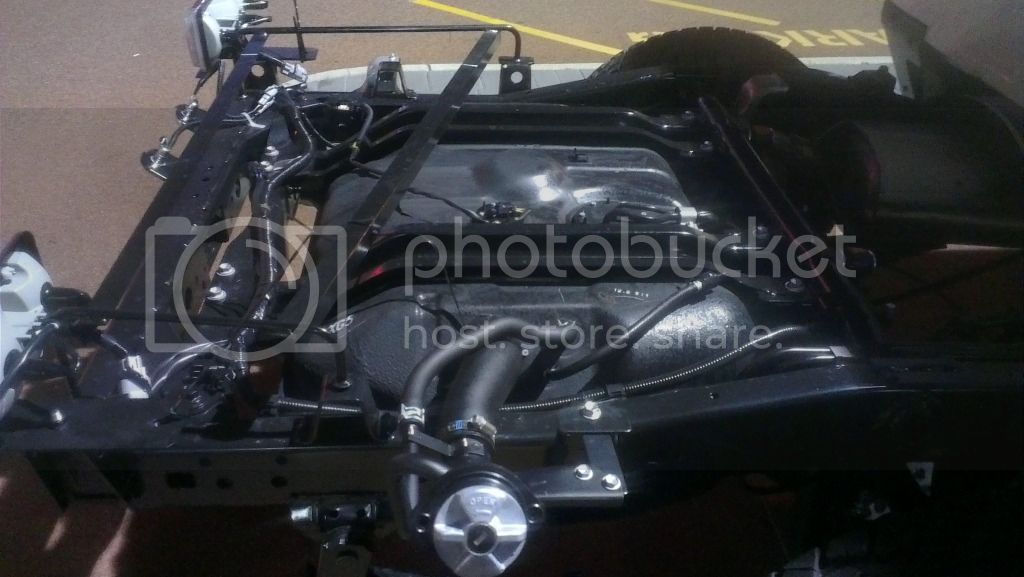

In addition to Clint's photo I also found this:
Awesome, thank you!!
Thanks for the pic, helps out a TON!!!

The rear tank I posted is a 130ltr tank
Ayyy, carramba - that's like 34 gallons US :eek: With the two tanks, I'll be like Exon Valdez on wheels in Canyonlands :bounce:
Unless your getting a tank from a brand new dual cab it will be the 90 ltr one
