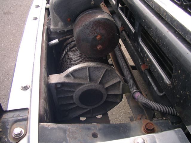

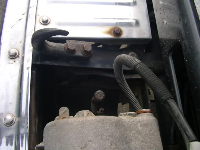

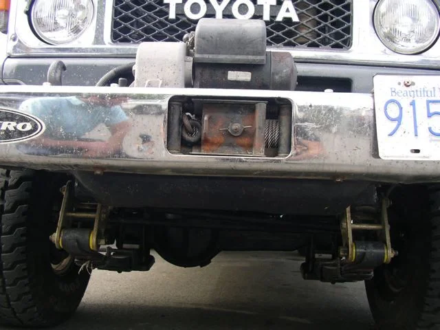

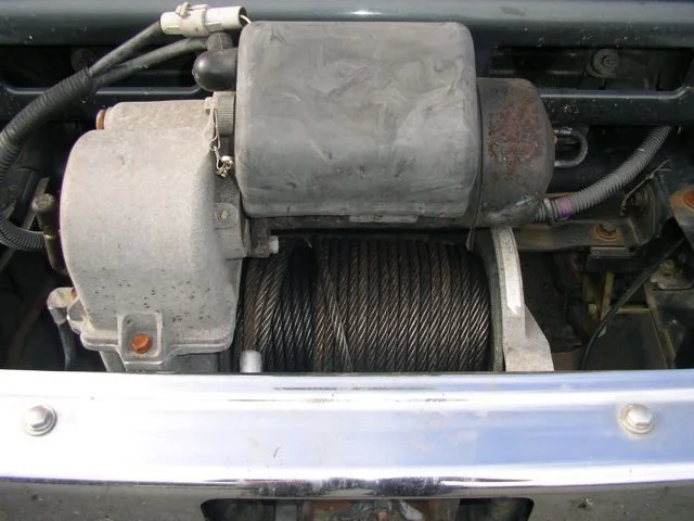

Are we talking about the upright electric here (should be, judging by the vintage).
The winch rating from Toyota is based on something other than the "normal" standard of winch ratings. The upright Aisin 1000 is good for about 8000 lbs (using similar values to something like Warn as a comparison).
Look for my BJ74 trail truck thread, there is a picture of the Aisin upright there.
If you want more pix, I can post some for you.
The winch sits in the bumper.
~John

This is the exact same winch! I checked your pics (only one shows the winch from the sides) Would you pls post a few more? Thank you.

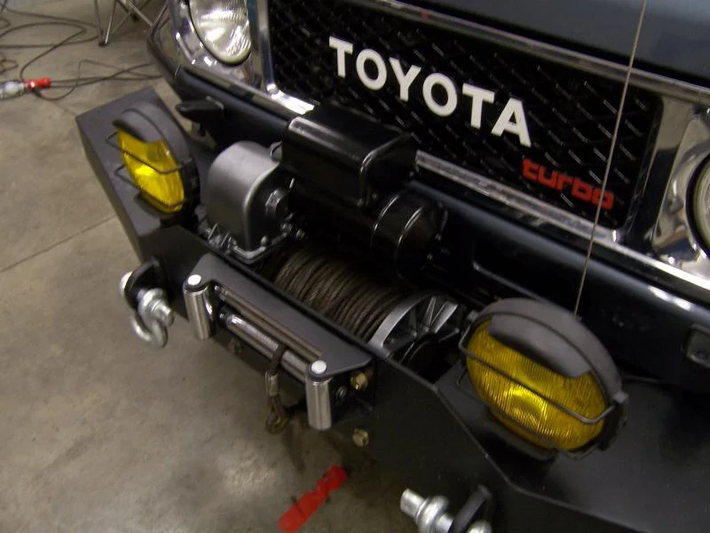

Here are some pictures as mounted on an BJ74
Thanks a ton guys!!!
These pics really help me out to figure it out how it originally fit in a 70 series. :)
