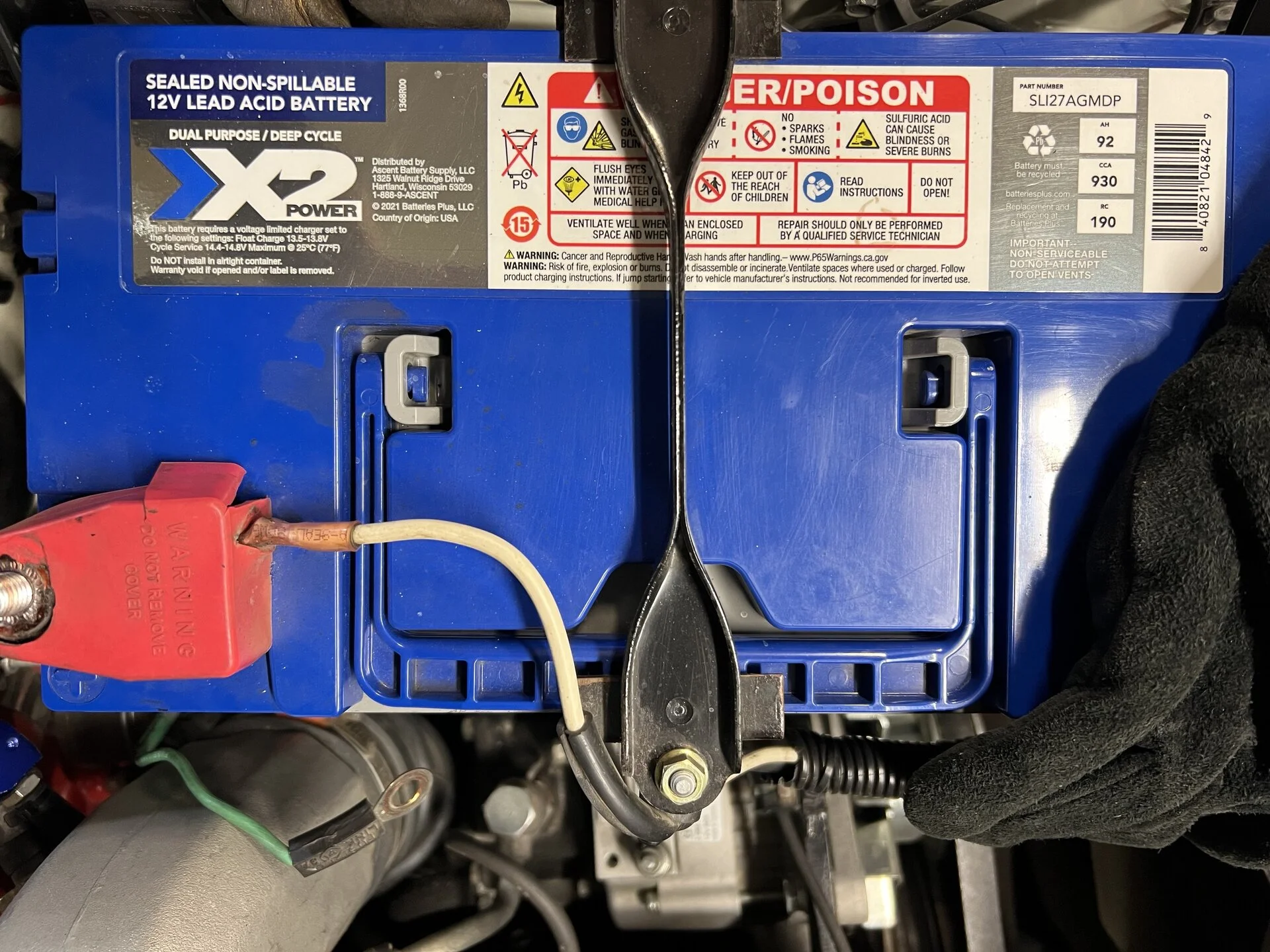

My Interstate, Group 27 battery gave up the ghost this morning (less than 3 years old).
I’m assuming it had a bad cell and would drop to approximately 9 volts when the starter was engaged. That life span seems very short to me. ☹️
Has any other 70 Series owners had the same experience?
My Interstate, Group 27 battery gave up the ghost this morning (less than 3 years old). I’m assuming it had a bad cell and would drop to approximately 9 volts when the starter was engaged. That life span seems very short to me. ☹️

At the current price point, I foolishly expected better. 😊
Same deal with my 2 Interstates.
I bought NAPA “AAA Premium” since they have a 3 year warranty.

It's the harsh winters you have where you live. They are hard on batteries. I still have the original japanese lead-acid flooded batteries that my cruiser came with. They are over 3 years old now and still going strong.... knock on wood.
The conditions here in Panama are brutal on tires and batteries. Very common for normal batteries to last only 2-3 years. I pay a bit more for the Optima yellow top, which mule-kicks the 1HZ to life nicely and lasts a year or two longer.
I find regular reconditioning with a ctek very beneficial for battery life. They all die eventually though. If the crank is a bit slow, it is probably the battery, the first sign.

I'm not clear on the science but I think inducing some frequency on the DC cleans the sulfate off the plates and revives the battery. I had a very inexpensive Aliexpress smart charger that seemed to breath life back into bad batteries until I killed it trying to charge a 170a/h AGM battery. It might be the reason I still have an 12 year old Costco battery on the bench that I use to boost stuff. I thought it was dead but it came back and is working fine whenever I need it.
It isn't humidity that kills batteries but heat. Lots of southern folks go through batteries more regularly than those of us who get frigid temps. I managed battery backup systems for an ISP for years and the batteries that were in outdoor cabinets lasted longer than those that were in the data closets. They just didn't have the runtime when they were very cold.

Once a month I recondition unless I have consciously de charged the battery running something else. I do the normal charge on the ctek at the drop of the hat as it is totally regulated. The first year or two of a battery is pretty safe, but they do die and have to. Heat kills them, in the cold they have to crank harder to start so stresses them in another way.
I go remote, 50 km from anyone, every week for half the week. I use a regulated solar trickle charger when bush, hardkore brand,it has been ok, it has been very much exposed to the elements for 4 years now. Often there are parasitic drains on batteries, from the car, that also kills them.

Battery companies appear to change ownership fairly often, so they are not always the same quality over the years, unfortunately. In oz optima and century have been better than supercharge from my experience. I have also found the dual purpose batteries of crank and amp hours have been a bit better like yellow tops or marine batteries. Some folks swear by caterpillar batteries. A good guide is getting the most cca, cold crank amps, biggest battery that fits. Look for the longest warranty, fwiw. 42 months is the best I can see at a glance. For 100 bucks more over 3 year time period, probably worth it. But I don't hear people saying the battery lasted 10 years like they use to say.
I would also add upon batteries and diesels, 2h for me, that the el cheapo cig lighter volt meters are quite a handy gauge.
When I glow with my wilson switch my volts drop from 12.7-8 to 11.3v on a healthy battery, volts rise again as the volts rise. Crank has good kick.
My current el cheapo battery, a supercharge which was on special (I knew it was not going to be good as shops put them on sale rather than recondition them all in store, got it because it was cheap, instant and needed right away) . After 2 years, when I glow coming into colder season here, not as cold as you guys, the volts drop from 12.7v (even after reconditioning) to 10.3v rises back up to 10.8v, the crank has little gusto.
A sure sign I need a new crank battery coming soon. I am going to give endurant a go, made in usa, 42 month warranty 810 cca. Often feel it is a leap of faith.
I also deeply suspect, maybe wrong, that an unhealthy battery can not be good for the starter.
