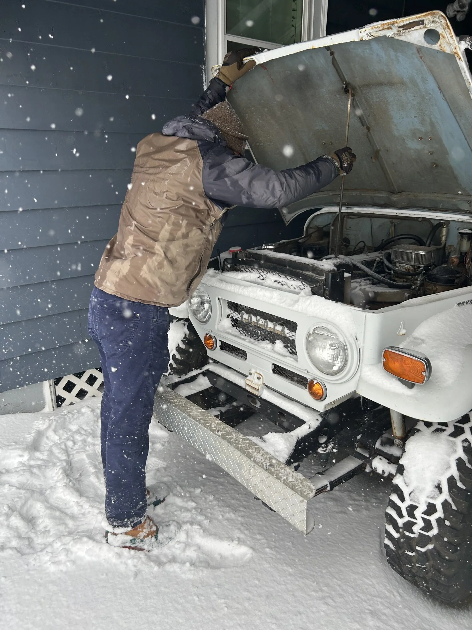

I have an electric carb on my 69 FJ40, believe it’s a Weber (two square butterfly plates).
I wanted to back it up before the freeze. But when I went to start it, no dice. Never had an issue until this year.
When I went to spray some starter fluid in the carb, thinking it was just the cold weather, I realized there was no tension on the plates. No movement at all when pulling the throttle line or physically moving the plates.
Any suggestions? Maybe a clip or spring popped? I didn’t have time to assess, because it was about to snow and was trying to prep… in New Orleans. Yes, 12” of snow in my backyard in New Orleans.

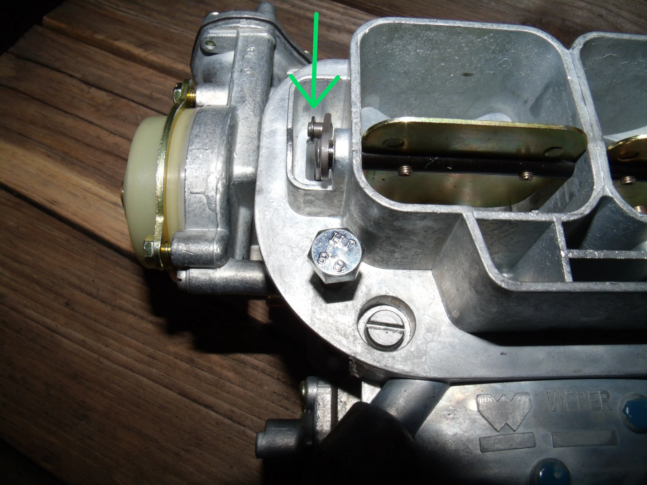

So, the electric choke seems to have disconnected or become damaged? If you loosen the three screws holding the choke housing, you probably should note the position of the housing, to make it assemble without having to figure out the cold-start setting.
There is linkage on the side of the rectangular butterflies (green arrow). I think it was a hitch pin or an e-clip. I lost that part on mine early on, and a tiny wire makes the connection, iirc. The manual-choke Weber is now on my Nissan Z24 4-cylinder.
