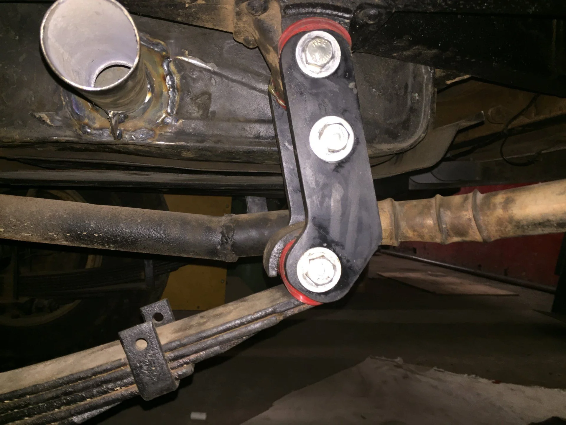

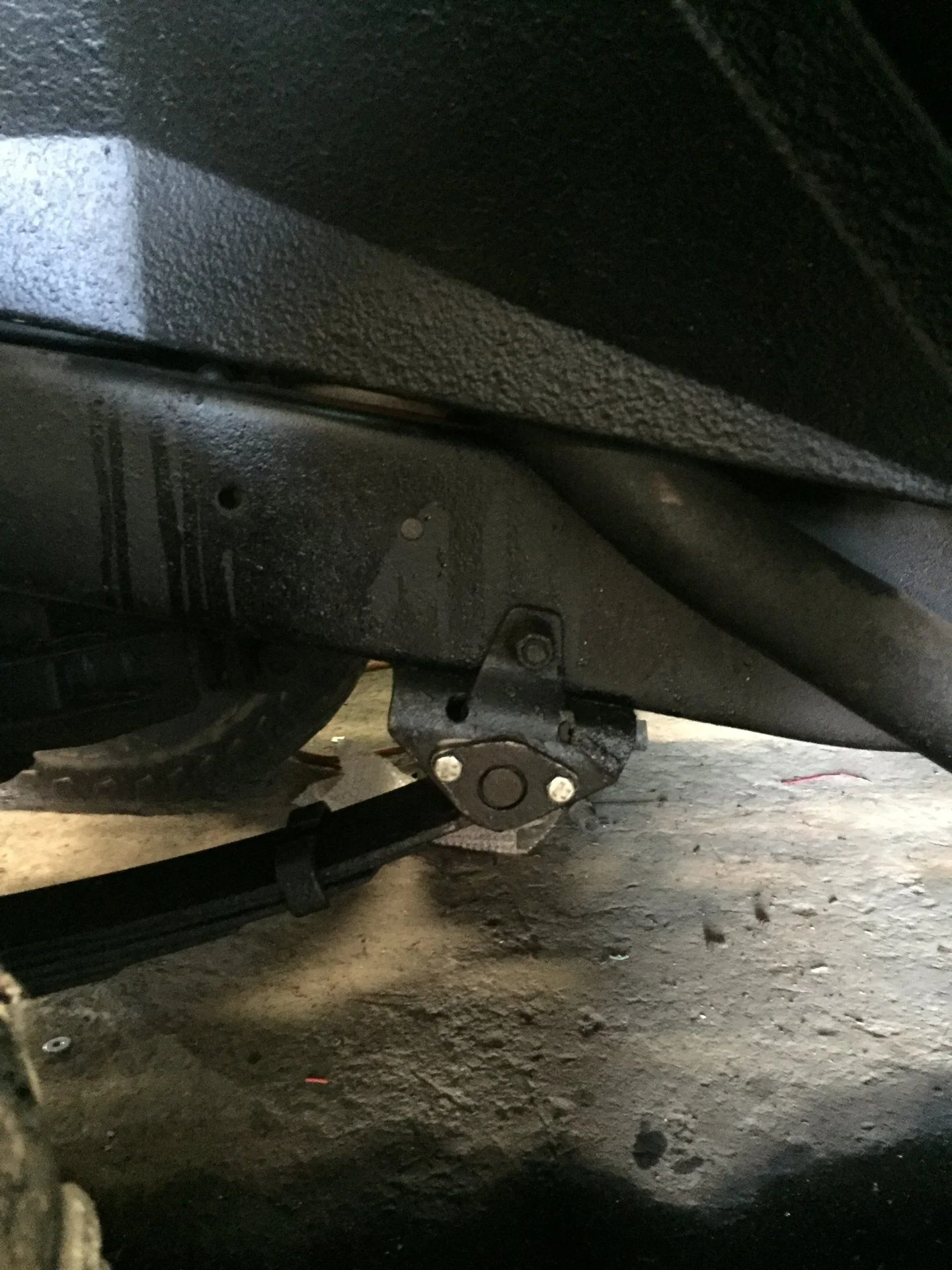

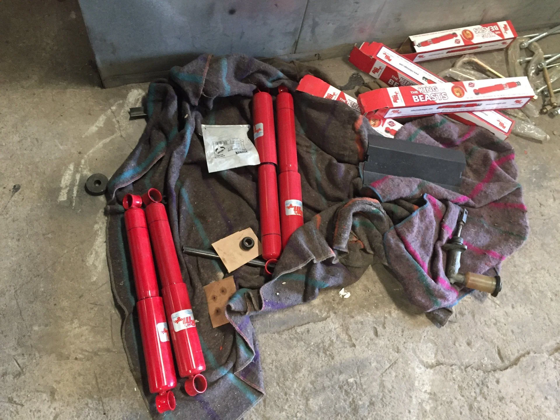

Suspension work is all but done. New shackles with bushing and heavy duty shocks. Also found out the the rear had no shocks at all so the truck was running on leaf springs and different length shocks up front. Nevertheless, made the 350km journey across Kenya.
New custom made radiator with OEM look. Clutch and brake cylinders are replaced.

A word of caution: scanning your suspension photos, it appears you may have used stainless steel bolts at certain locations. While I understand the desire to avoid future rust and corrosion, stainless bolts have several lesser strength specifications than the original factory bolts that were used there. In non-critical areas, stainless is fine; other places-- a safety concern.
I apologize for the alarm if yours are not stainless, but if they are, some careful reading of bolt specs might be warranted.

Thanks for the concern and the warning. Metallurgy is not something we practice here, but I double checked the bolts and nuts and the are cadmium coated steel but not stainless. I’m not planning any hard core off-roading but it’s better be safe than sorry. Thanks again.
