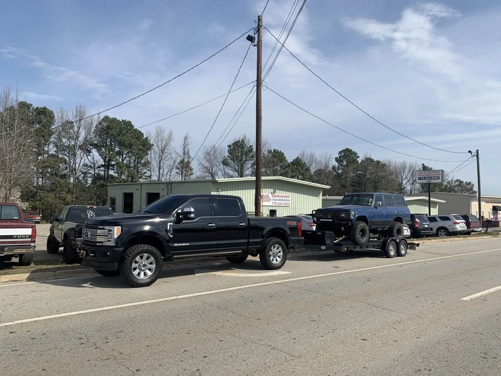

Ok so time for an update on this. I performed several adjustments to the kick down cable before replacing it along with the filter due to the transmission not shifting correctly....consistently. I would go for a while without problems and then all of a sudden it wouldn’t get out of first on its own. so I decided to call Tim at Abercrombie Transmission. These guys are top notch and definitely know what they are doing. I dropped it off a week ago and picked it up today. I drove it around town a little today and it has never shifted so well. I highly recommend them and thanks @bcart1991 for suggesting them.
