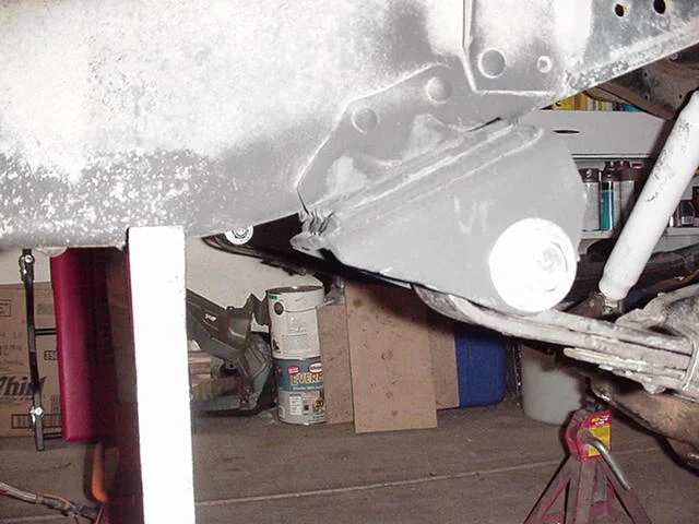

i made a new hanger.
attachment.php
i also added a gusset to the top of this mount

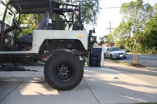

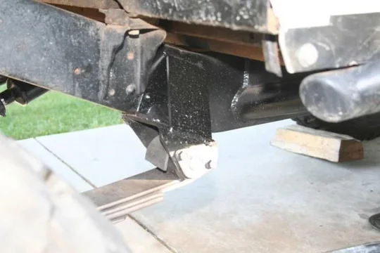

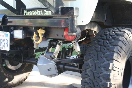

Well Finally took Pictures..
Stock Hangers Gusseted
Rear shackle hangers flipped and moved forward an inch
Side shot
