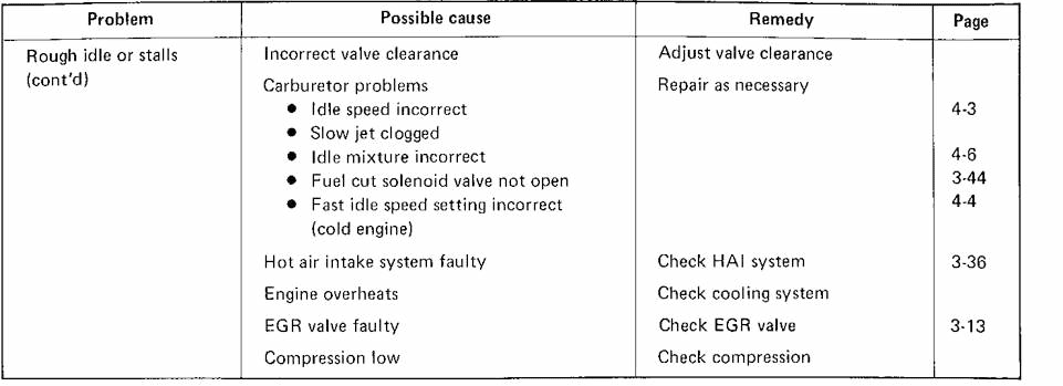

I might have had this backwards in my head this whole time...have the FSM out for a resmog and looked at the HAI system just now.
Might help

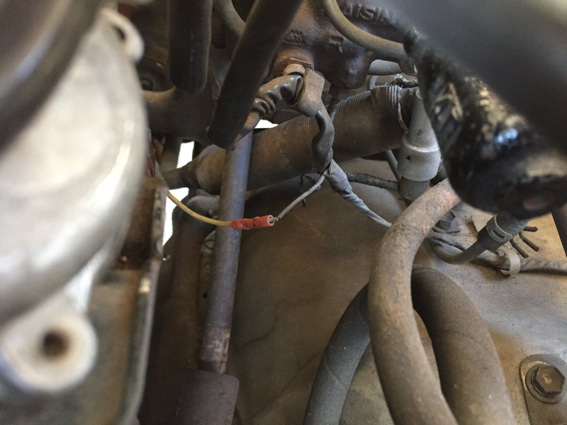

Most likely that is the wire that goes to thermosensor that controls the carb cooling fan.
Edit: you could look underneath up to the manifold to verify this, I doubt it has any effect on idle. Certainly could be cleaned up with a heatshrink wrap or elect. tape?

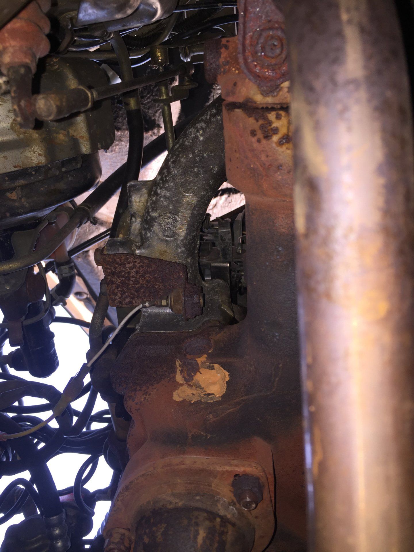

Looks sooty under the exhaust manifold, could be / probably a leak, causing the erratic idle and with the amount of rust on the j-pipe connection at the top-right of foto in post#36, I would recommend PB blastering (several times with pause of a day or so) that pair o' nuts and get the desmog kit with blockoff plate.

What I see in that photo is the funky yellow blob. I zoomed in but still can’t get a good look. Could that be a shoddy crack repair?
