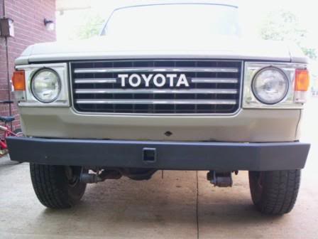

I had mine made by Chris at CRBoffroad in Ohio. Here's the front, $100 range

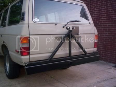

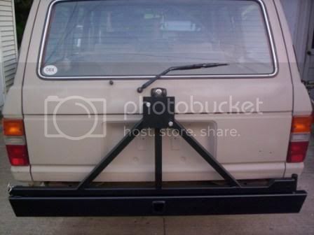

and the rear, in the $250 ballpark.
I fabbed the mounting brackets and welded them over a weekend. Bumpers were built from a sketch and measurements I provided Chris.

SAS: the front one is almost exactly what i am looking for... i want to know how exactly you anchored it to the frame for pulling the vehicle out of the mess you drove into? any attachment pics? also, wouldn't be happy without some kind of D-ring recovery points to smash my knees & shins on.

i have also been trying to work thru some kind of swing - away that fits the existing receiver and has a receiver in it for mounting my spare on the back of the car with a storage box that can function as a table of sorts for after the extended gas tank install. Instead of mounting the hinge to the bumper as your bumper is built. that way i can mount the tire / gas can and /or the storage box depending upon what i was gonna do that weekend.

SRPLUS: I used 3/16 2x4 angle iron, about 5" in length parallel along the frame rail (removed factory bumper horns).
The 2" part goes over the top of the frame, and the 4" part on the inside of frame...looks like inverted "L".
Drilled one hole per frame rail, but will do a second on each side, and secured it with a short fat hardened steel bolt.
These mounts are butt-welded to the bumper, and I plan to gusset them (horizontally) before any trail use.
