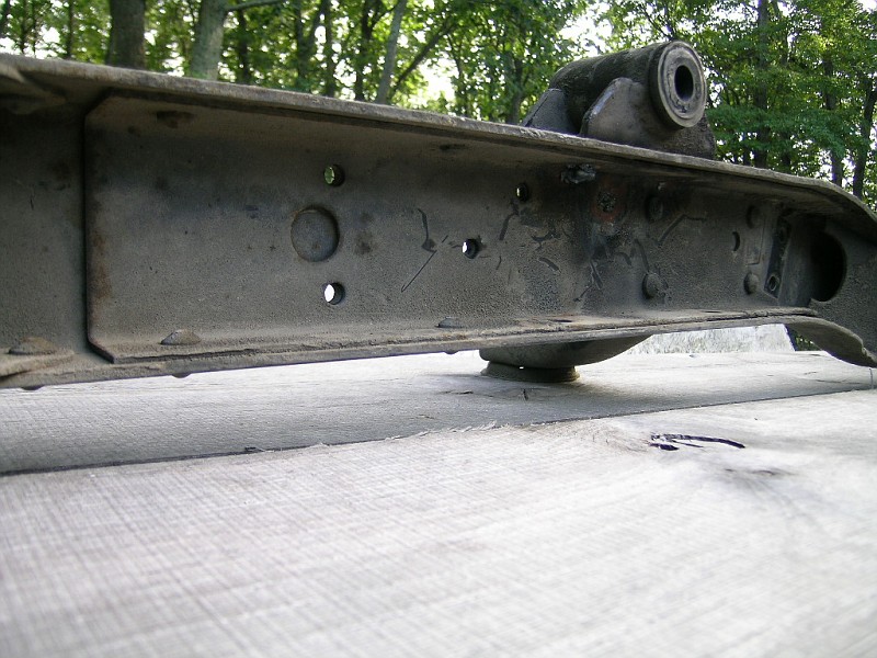

Here are some pics..
Nice troopy at the Walmart near Rumney....
Nice utility pick up at Cruiserparts...
My nice east coast rot frame problems..
The nice solution...
