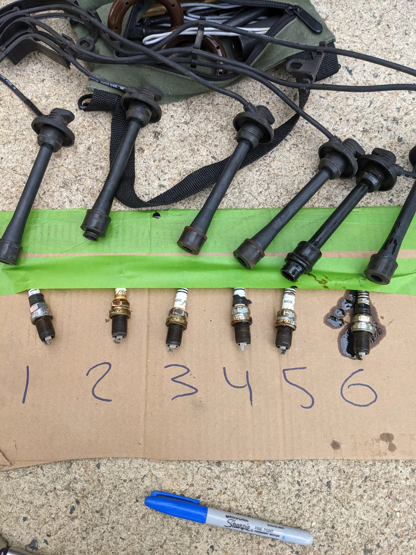

Did the distro,plugs, wires today and found # 6 basically filled with oil...
Rig ran like a champ prior and after all the PM, seems to run even better.
Should I be concerned with #6 and it deluge of life juice??
I'm reading about different seals and such. But is this bad? Need immediate attention? What's the severity here

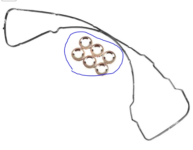

It needs a new valve cover gasket kit.
No rush, but don't ignore it either.
The circled items are what is failing, but you change the outer gasket too.
You could just leave that spark plug out so that the oil drains back into the engine....oh wat I'm not my father just yet. 🙄
Well when changing plugs it all drained back in...gave it an additional yoink after 14# tq. Hoping that kept it snug.
Will look into the new gasket kit.

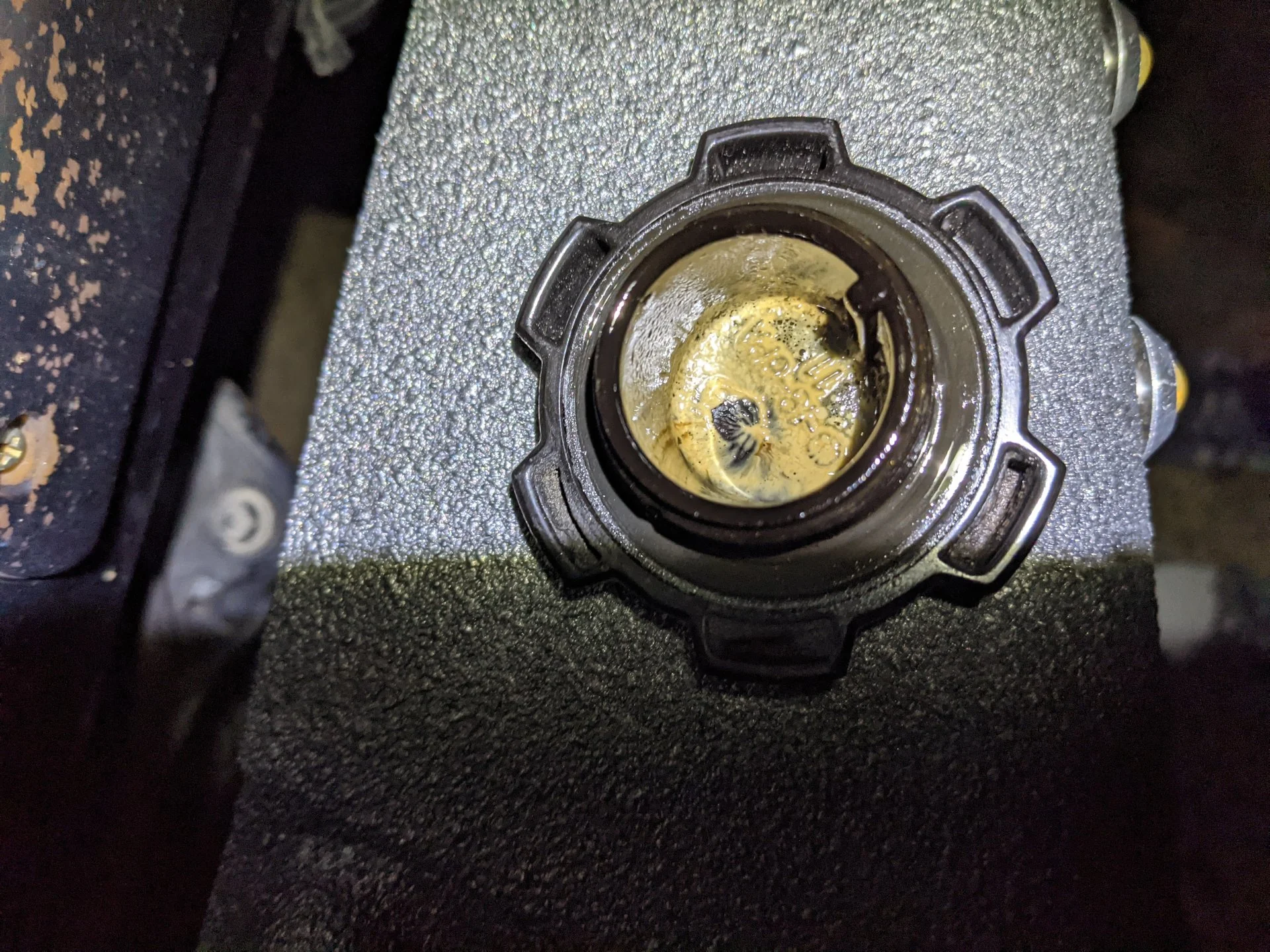

Unscrewed oil cap and saw something I do not like:
so now I'm thinking HG....:( I fired up the car again and horrible stuttering and again smoke.
View attachment 2833692so now I'm thinking HG....:( I fired up the car again and horrible stuttering and again smoke.
How the heck did a valve cover gasket change lead to all this!!
Just to be clear; The milky colored stuff on the bottom of the oil cap means absolutely nothing, other than you have not driven it enough. There is condensation inside the crank case and since that plastic is the first place to cool, the moisture condenses on that and mixes with the oil. This "My HG is blown!" myth is continually proliferated by the interwebs. It is NOT an accurate indicator.
If you're that concerned, go down the compression test / leak down test / exhaust gases in the coolant test rabbit hole.
