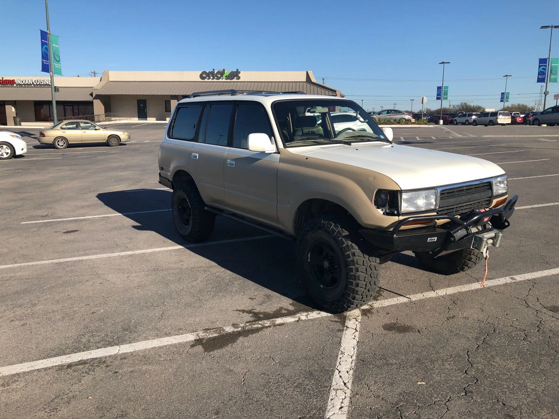

Some of you may be familiar with this rig, but for those that aren't, a synopsis:
I originally bought this rig as a 280k mile burgundy 1994 FZJ80, converted to locked axles, installed a TJM 50mm lift with fox shocks and 315 KM2s, then low-speed flopped it in Colorado. Righted it and got it running, drove off the mountain under its own power. Trailered it home, bought a white 97 LX450 that had front end damage and put that body on the frame. Did complex wiring to get the 94 and 97 harnesses to talk (complicated bit is all now gone), bought new front panels, ripped off the molding and bedlined the sides, installed a slee shortbus and warn 9.5XP, built a 4x4labs rear dual swingout and installed.. and drove it all over the place. Then wanting more power and always liking an automechanical challenge, I decided to swap in a 6.2L all-aluminum L92 and 6-speed 6L80 out of a 2008 Escalade. 403hp in that application, probably less in mine considering the stock intake, but trust me.. it's plenty.
it is awesome.. but, I've done a couple big trips and living in Texas I'm looking at 900 miles minimum to get to the areas I want to be in, and frankly the lift/tires/noise is more fatiguing and less safe than it needs to be considering how I wheel when I'm that far from home.

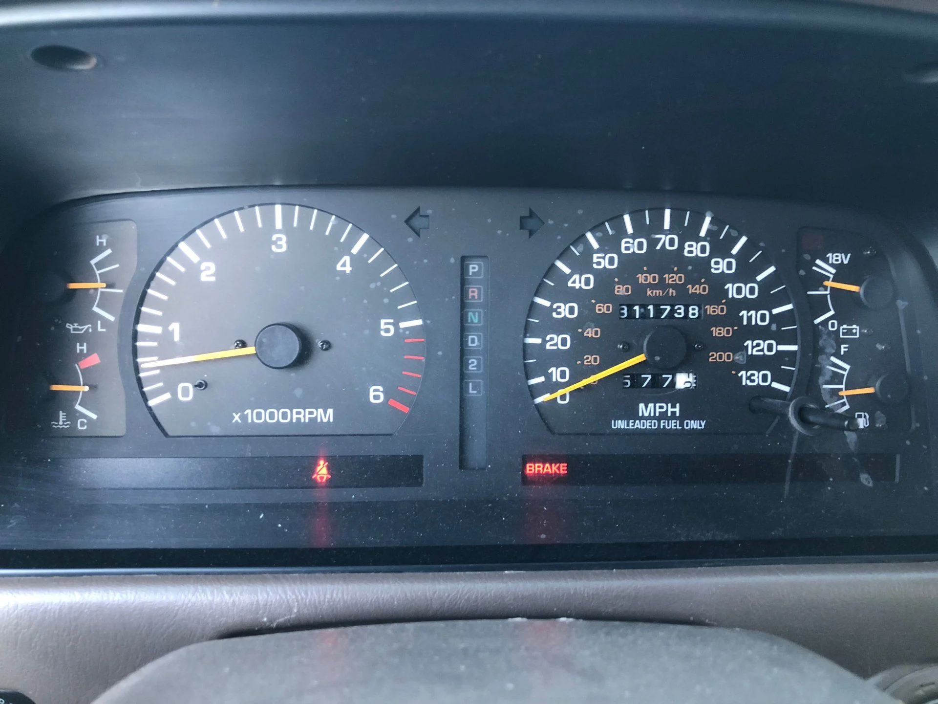

~311,780 miles

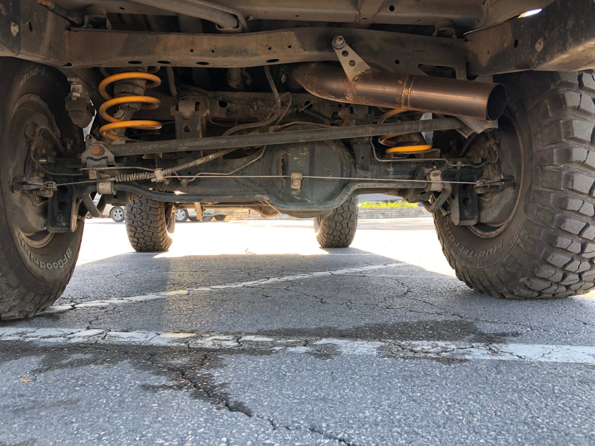

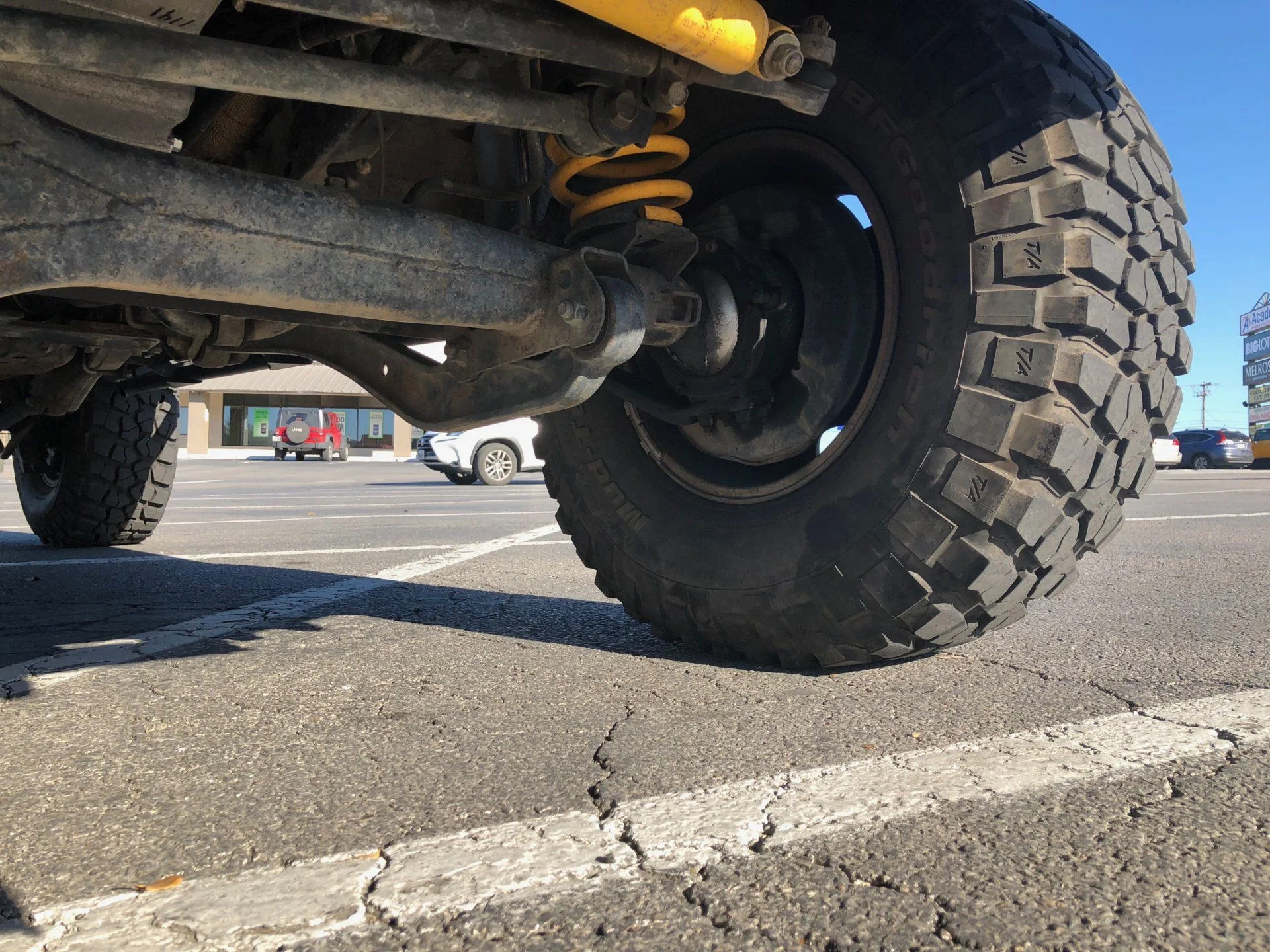

TJM 50mm progressive lift, fox 2.0 shocks (no leaks, 25k miles)
Slee shortbus front bumper with Warn 9.5XP winch
Built-from-kit 4x4labs rear bumper, dual swingout, spare on one, other not set up yet

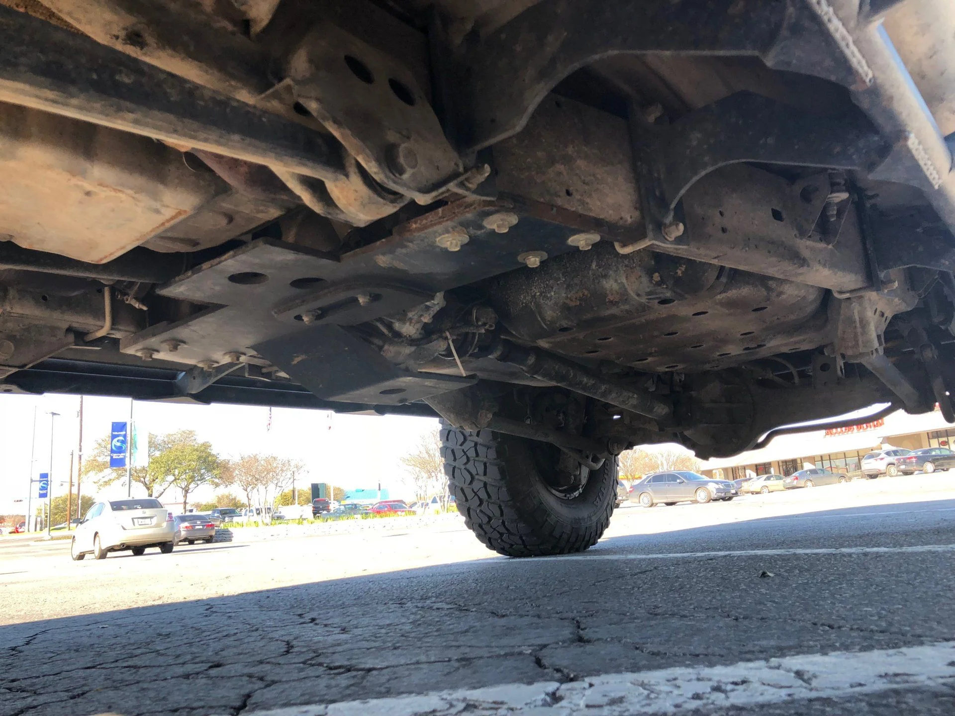

IPOR skid plate/crossmember
4x4labs sliders
Lokka part-time
spool, OEM 80-series locking hubs
315 KM2s
on 94 wheels spraypainted flat black, approx 60% tread left, spare has a non-leaking sidewall cut, another has a very slow leak
Dakota Digital SGI-5 odometer corrector (stock 4.10 gears)

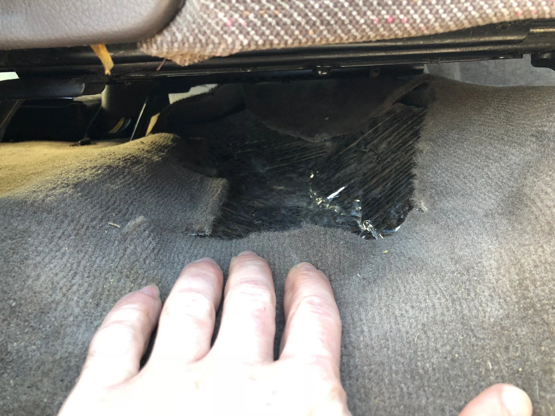

additional heat/sound insulation added to floor

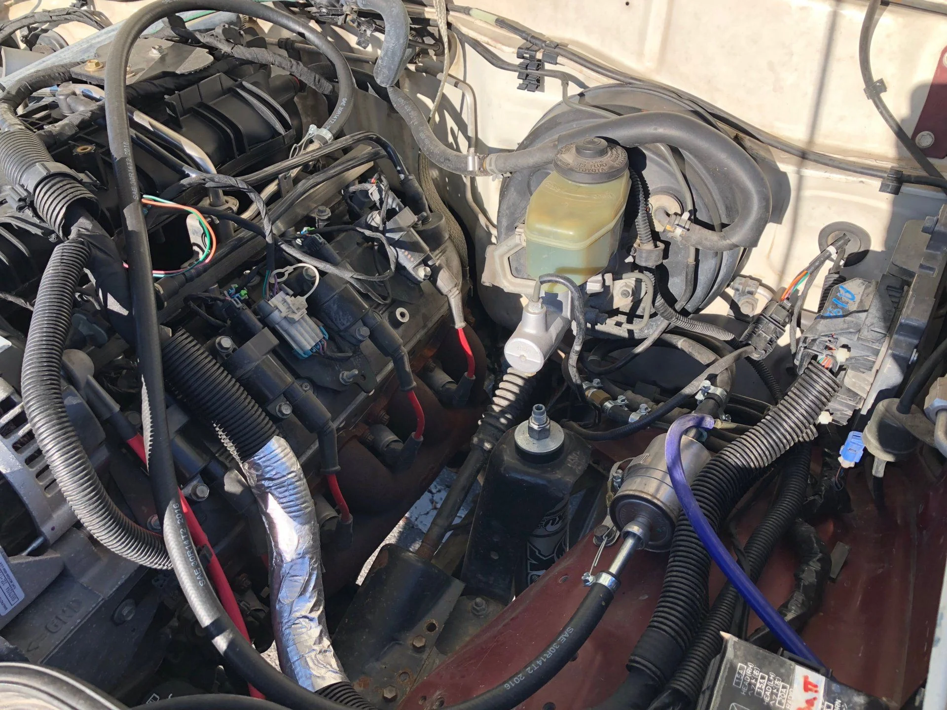

blue line is the fuel tank vent. Just runs inside the front fender for now. Also visible is the corvette fuel filter with built in regulator.

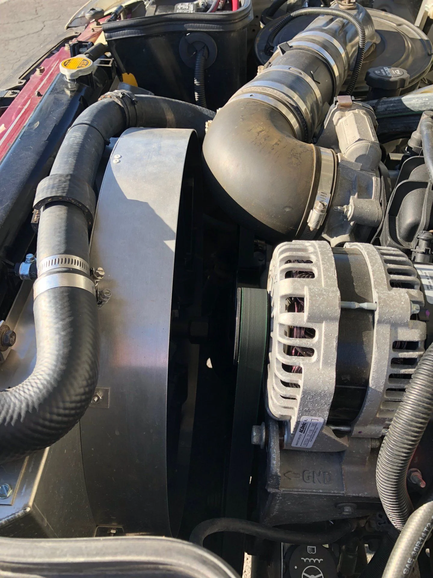

Summit custom fan shroud and I maintained the full 4" intake after the FZJ80 filter canister

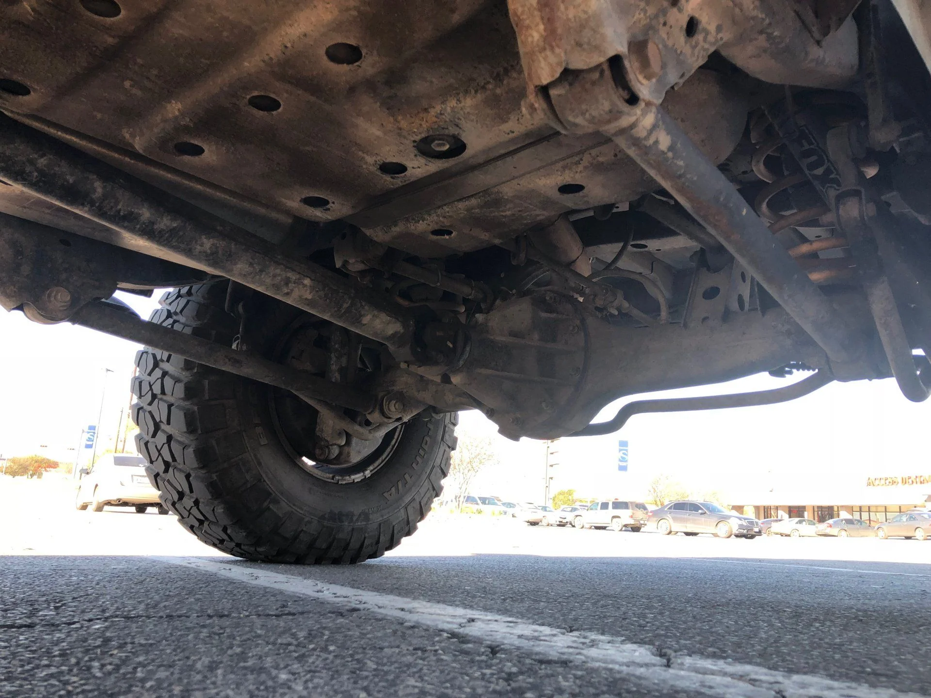

I had to cut down the front leg of the IPOR skid to clear the 6L80 pan
Not quite visible but I got the rock guards for the rear fox shocks. Not sure why these are sold without.. the shafts would be screwed hanging down that low unprotected.

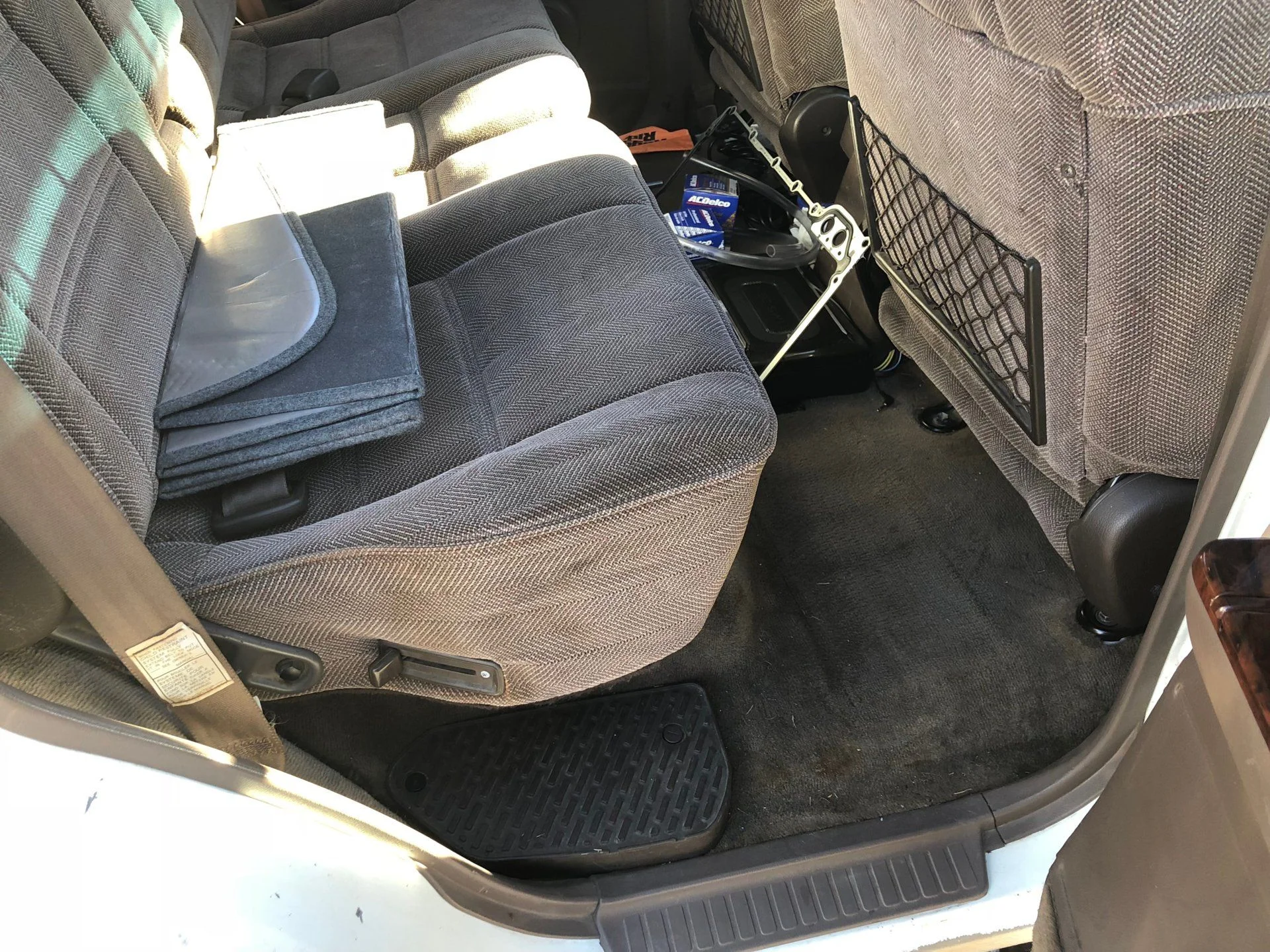

Rear heat removed, mylar bubble wrap and jute added to deal with the significant heat there. Good for storing stuff like rachet straps.
Somehow forgot to get a pic of the driver's seat. it is in good shape, no tears, and as mentioned it has a new lower cushion.
Parts on the floor are spare LS stuff I have after the swap. Few gaskets and oil filters.

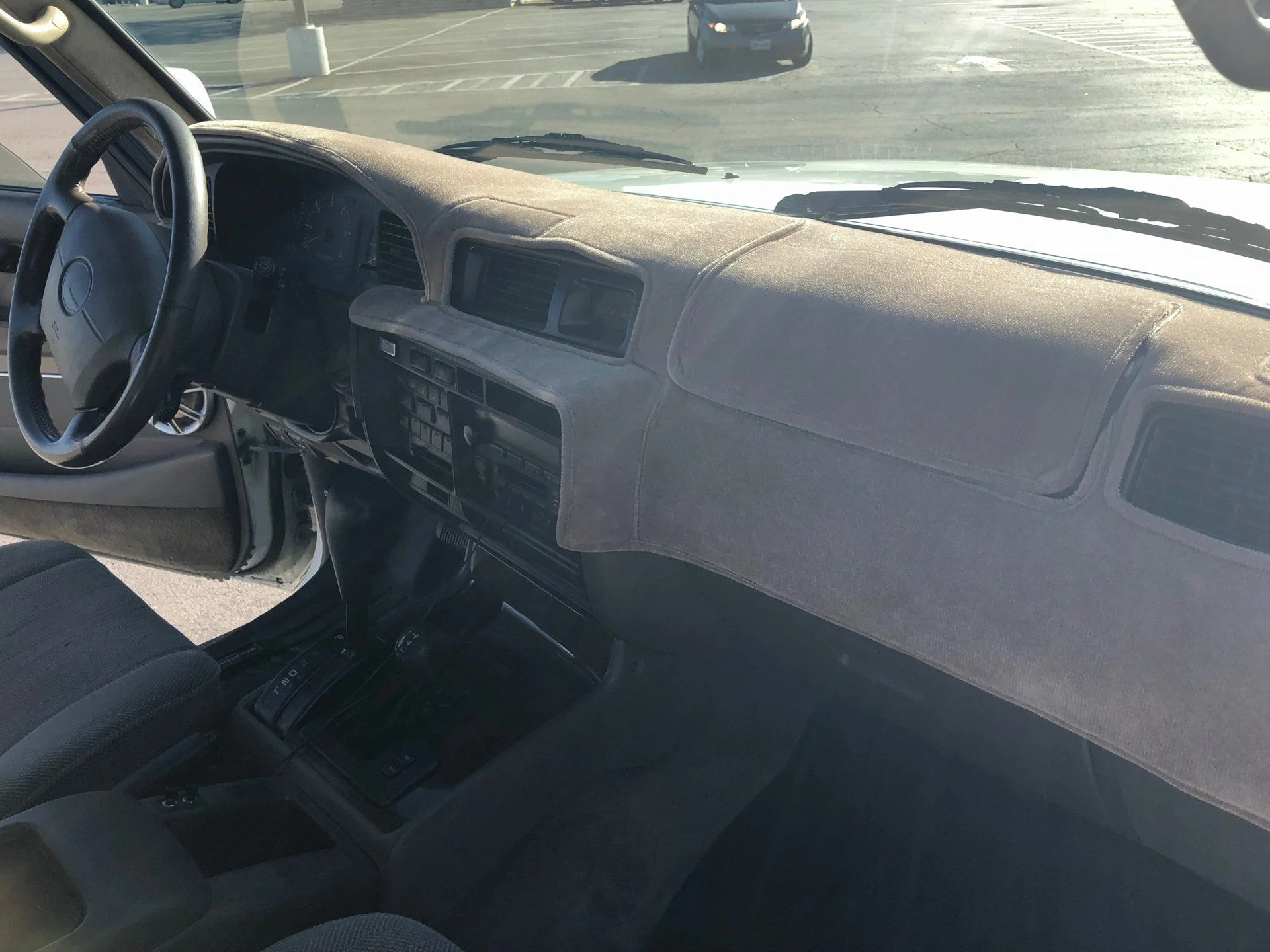

Steering wheel is OK.. the brown has come off but so far no tears in the leather. The silver button next to the hazard switch is for engaging the front driveline.
Note that the driver's airbag is there, but deactivated. I pulled the propellant charge and set it off then reinstalled the casing to give the airbag support. The passenger unit has been removed completely, only the cover remains.
Here you can also see the tap shifting switches on the console. Forward is downshift, rearward is upshift.
