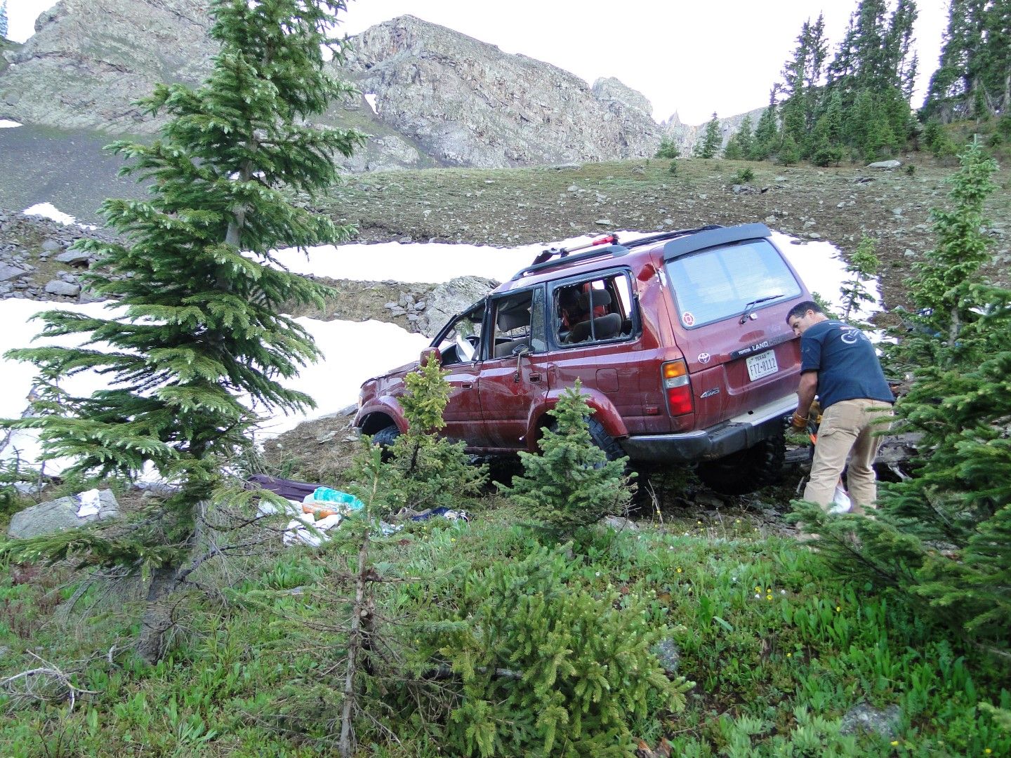

HUGE props to total strangers. A guy in a 4runner down the hill heard the sounds of the roller and came speeding up. He made sure I was ok, then helped clean up the yard sale a bit, then broke the news that he had no recovery gear. So we went into Ouray to find help.
In town I found out a tow would be about $2500 just to get the wrecker up there and flip the truck onto the wheels. Getting it back down the mountain would be on me.

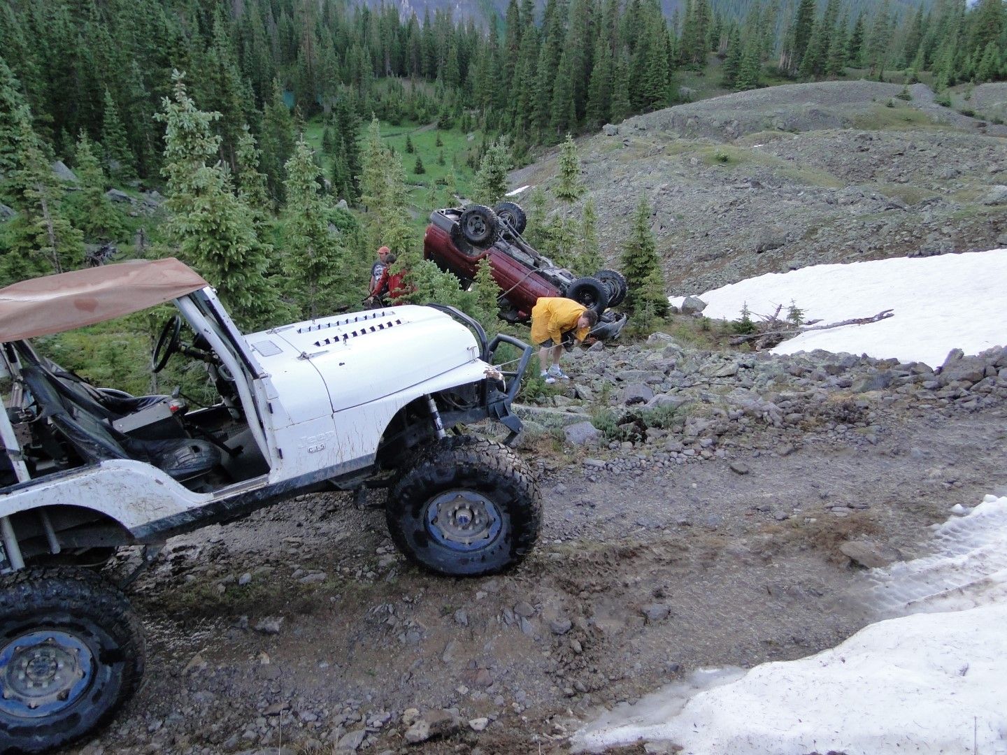

So a great local put me in touch with a local landcruiser guy, and another of his friends and we went back up the mountain.

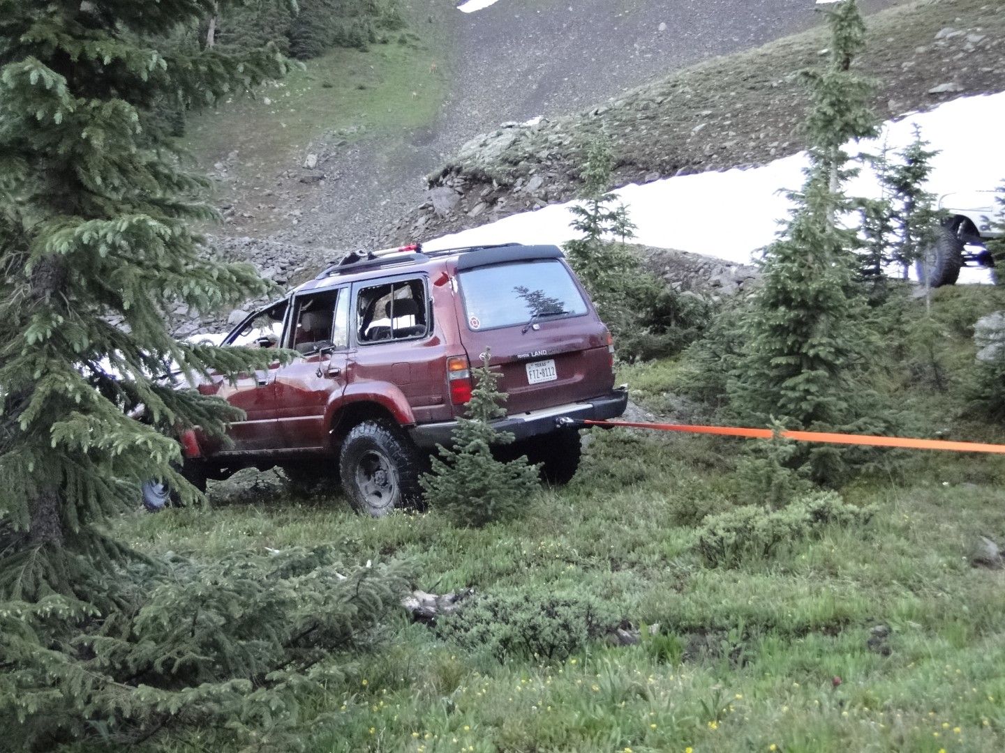

The jeep driver had all the experience, but the 100 had the big winch and necessary weight. We set it up with two lines.. one to do the work and the other to keep the rig from rotating further down the mountain.
Being afraid it'd start to roll when it got onto the driver's side wheels, I crawled into it while upside down and engaged both diff locks. Between that plus the transmission being in park, and the parking brake.. it shouldn't go anywhere.

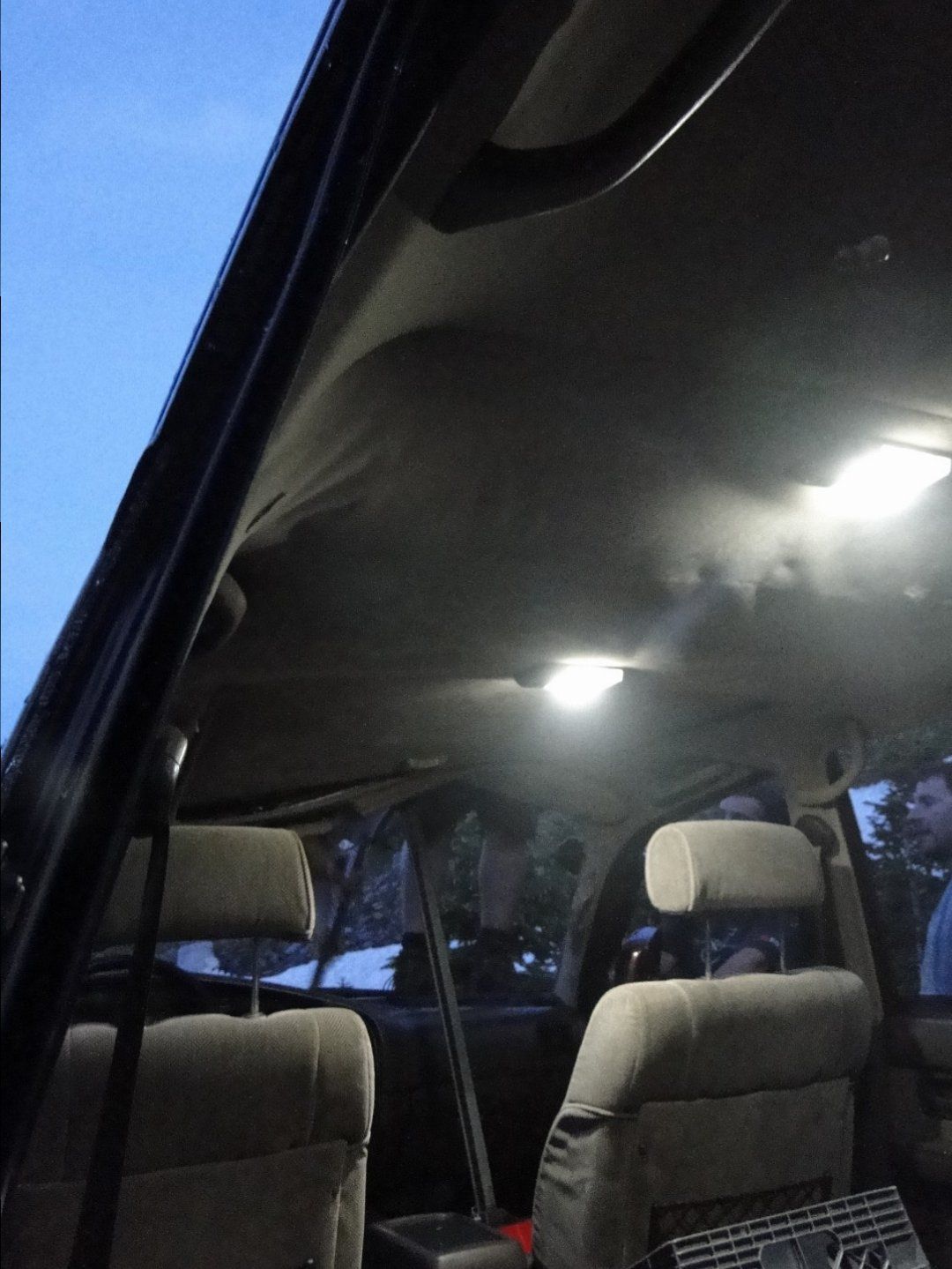

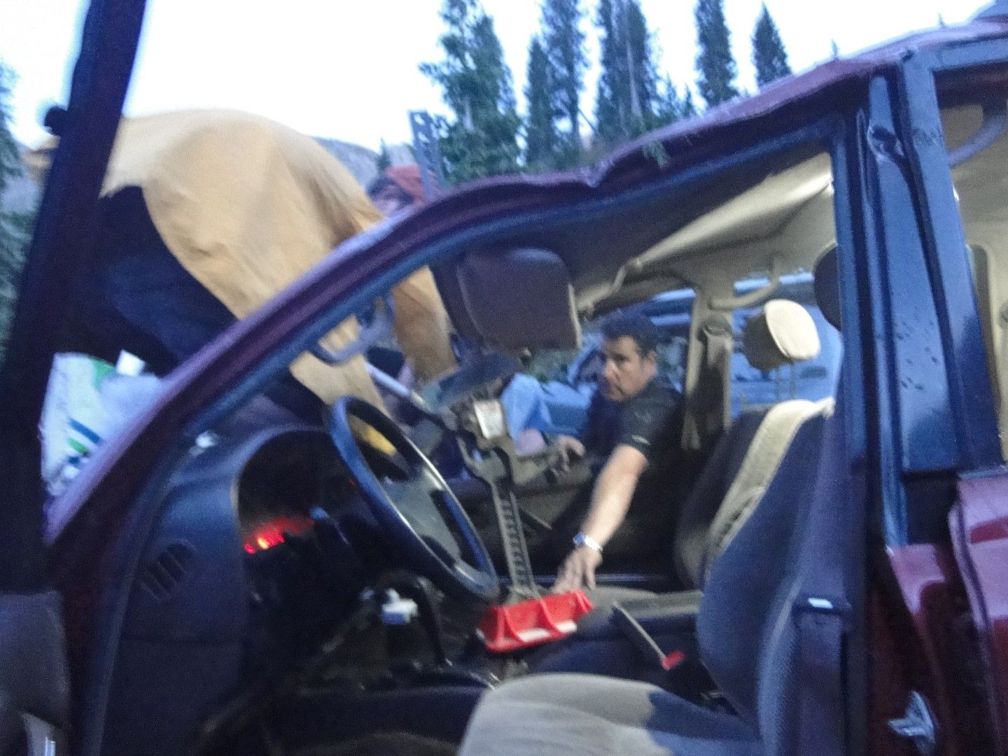

Stock seats are TOUGH. Hi-lift to the seat to lift the smashed windshield frame so I could see. That seat cushion is still in the rig and working fine.

The cloud lasted about an hour.. and I drove it off the mountain. We kept the hundred behind me in case I lost brakes.. jeep in front if it needed a pull. Nearly everything was downhill so the reduced weight of the jeep wasnt an issue.
