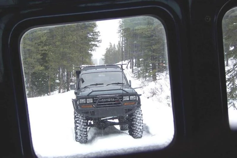

I got a ride in Brad Taylor's HJ61 with the shift kit at River Shiver and I really, really like it. I wouldn't hesitate to buy a Cruiser with an auto if it was bolted to a diesel with a turbo.
Brad's HJ61...
Brad's HJ61...[/QUOTE]
That 61 is very cool looking, is that front bumper a Camrock built?
