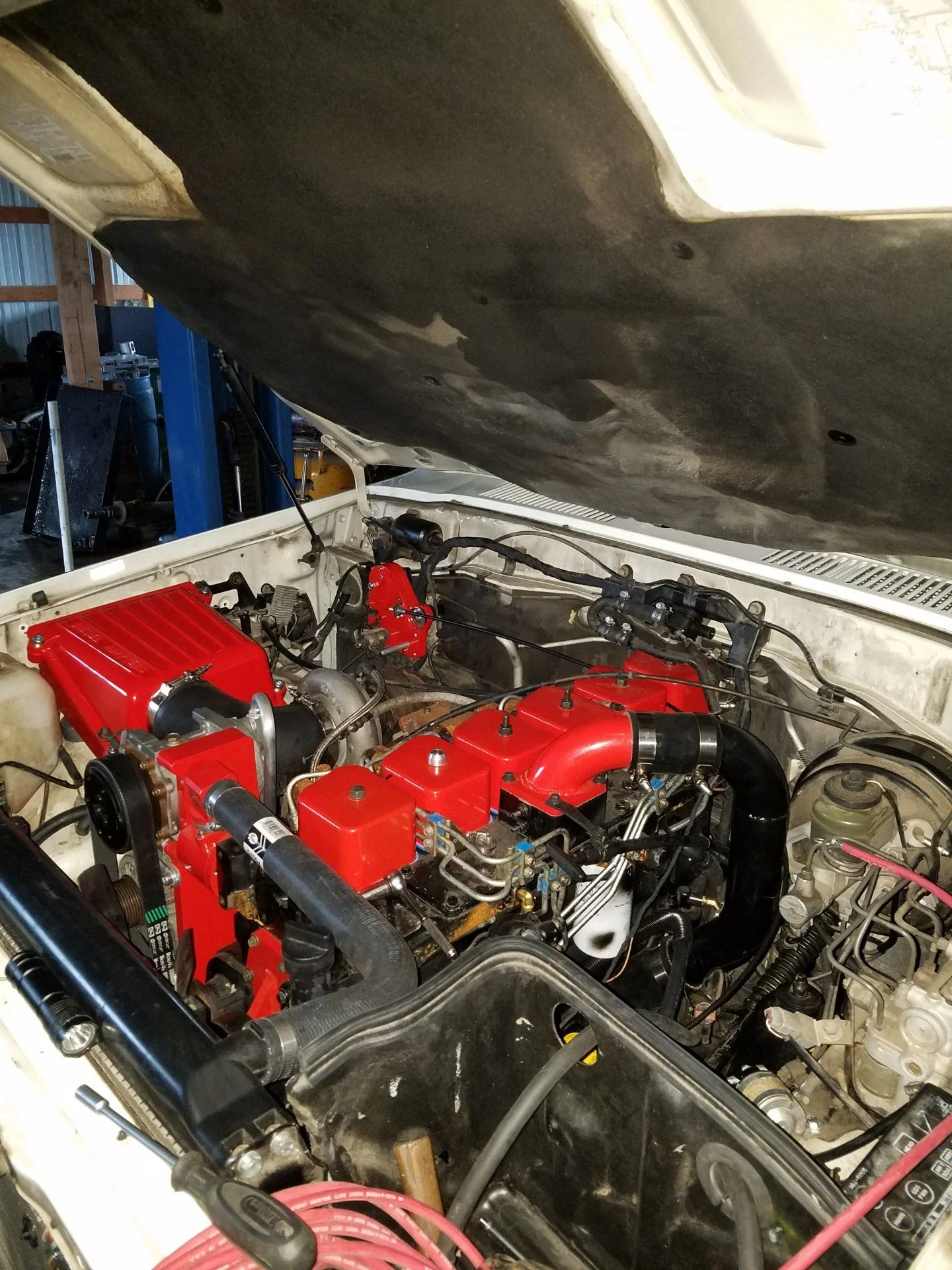

Yes I did mine this year, I love the way it put's the 6bt in the engine bay and the controller for my 343
How many miles have you put on it so far? Good quality parts? Would love to see more pictures if you have any
I just did 428 today and I have about 10K since the swap, and yes the parts make it look like it is factory search for my son's senior project
