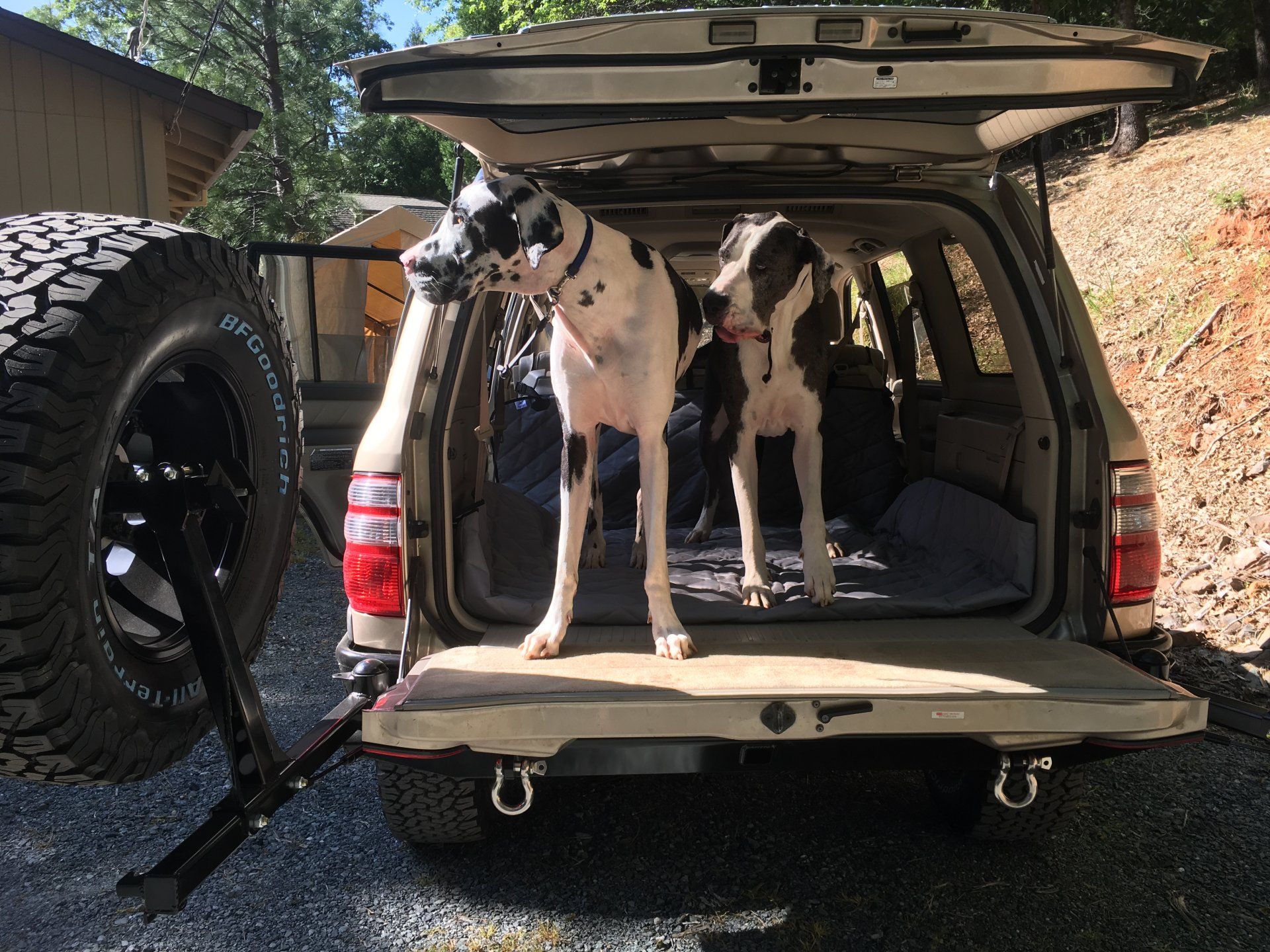

Also, note the liner in the back. Just got it from Amazon today. (Amazon.com : Plush Paws Waterproof Cargo Liner, Bumper Flap, Machine Washable, Durable - XL GREY : Pet Supplies)
It's long enough to cover the entire back when the middle seats are folded up. With two Danes, and the kids moved out...that's most of the time. In in the pic I have it folded under at the tailgate. It is long enough to cover the tailgate and hang over. Seems pretty solid. Washable. I ordered Weathertech liners for the middle seat floor and the fronts, but I needed something else that would cover the entire cargo area.

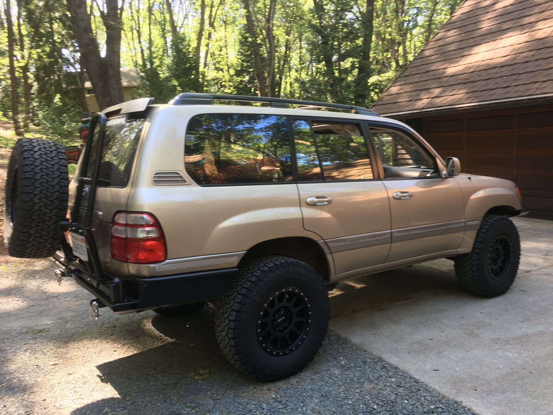

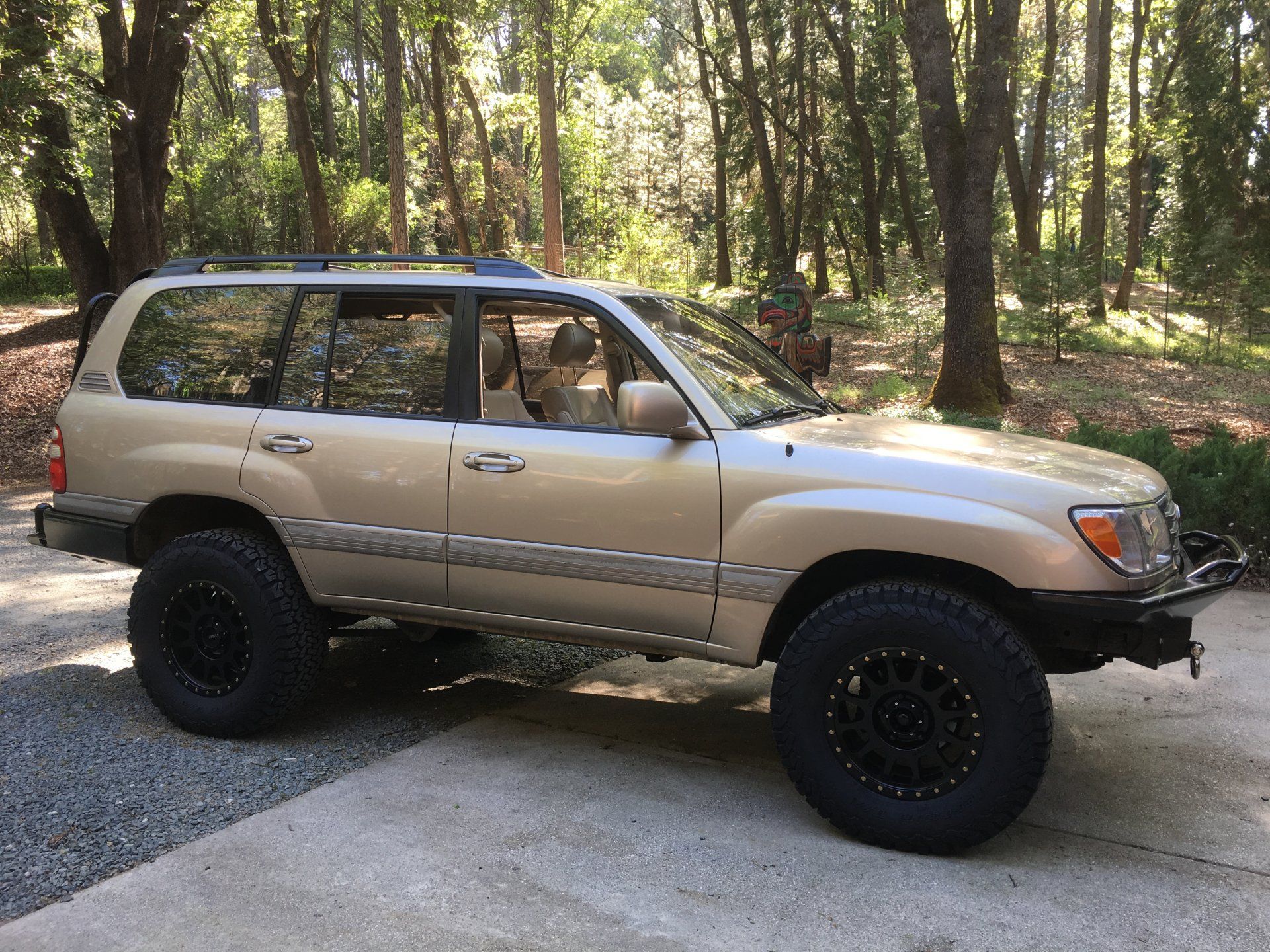

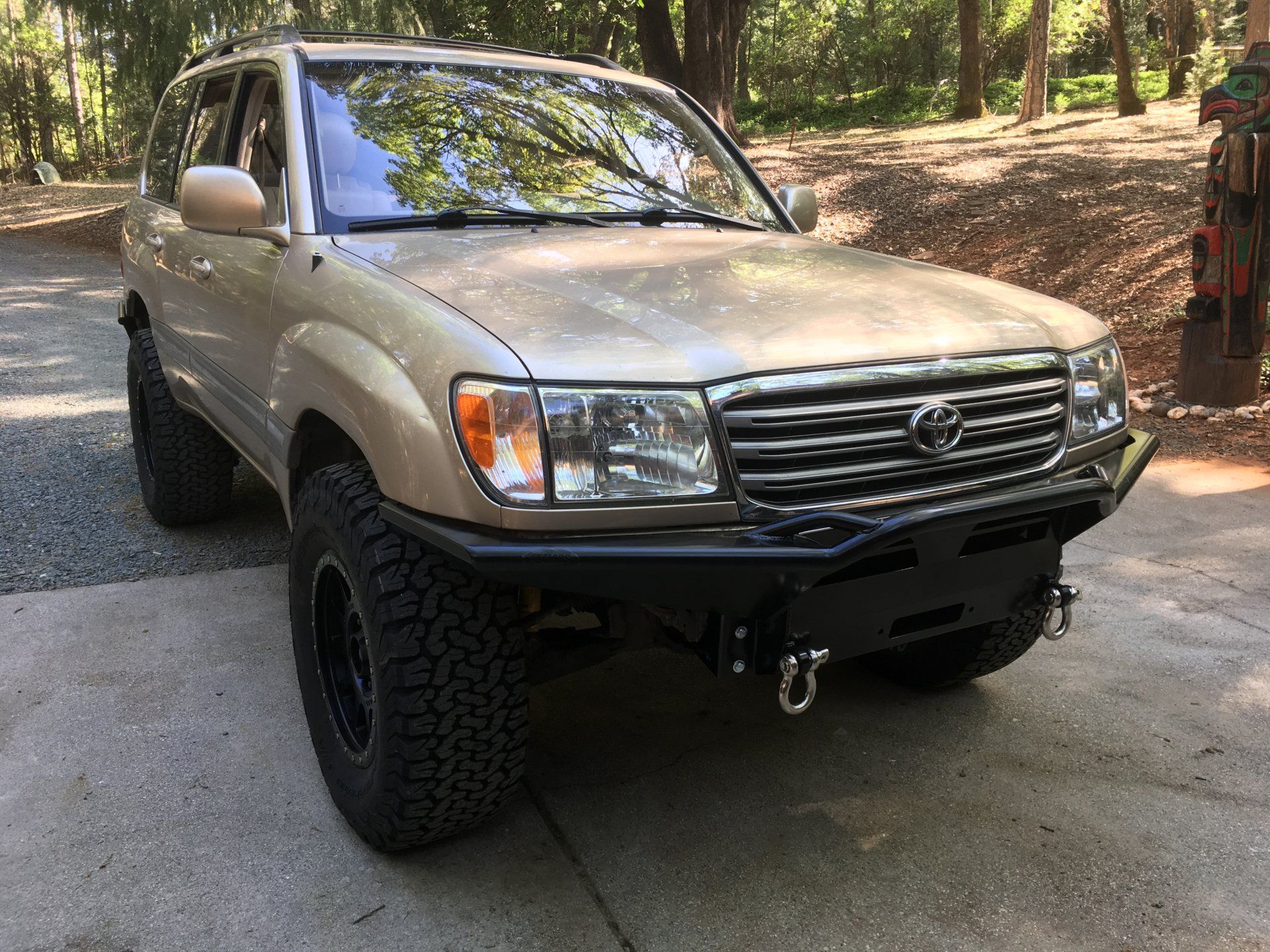

4x4Labs did an awesome job! Sliders not on yet (getting powder coated) but OME lift, bumpers, wheels and tires all on. Couldn't be happier with it.
Specs:
OME Heavy 2.5"
4x4Labs Custom Front Bumper
4x4Labs Cusrom Rear Bumper w/ spare carrier and ladder
18" Black Method Race Wheels
BFG 25x12.5-15s
4x4Labs sliders- (not installed)

How do those 35s fit? Any rubbing while flexed or anything? Gorgeous looking truck!!
When the 35s were first installed there was some rubbing at full turn. Had to trim out a bunch of the plastic from the wheel wells. Seems to clear well now. Haven't been off-road, so can't say on that yet. I'll keep y'all posted as we shake out any bugs.

Didn't know Luke made sliders or a front bumper for our rigs. I'm going to get his rear bumper soon. Mind me asking how much his sliders are?
