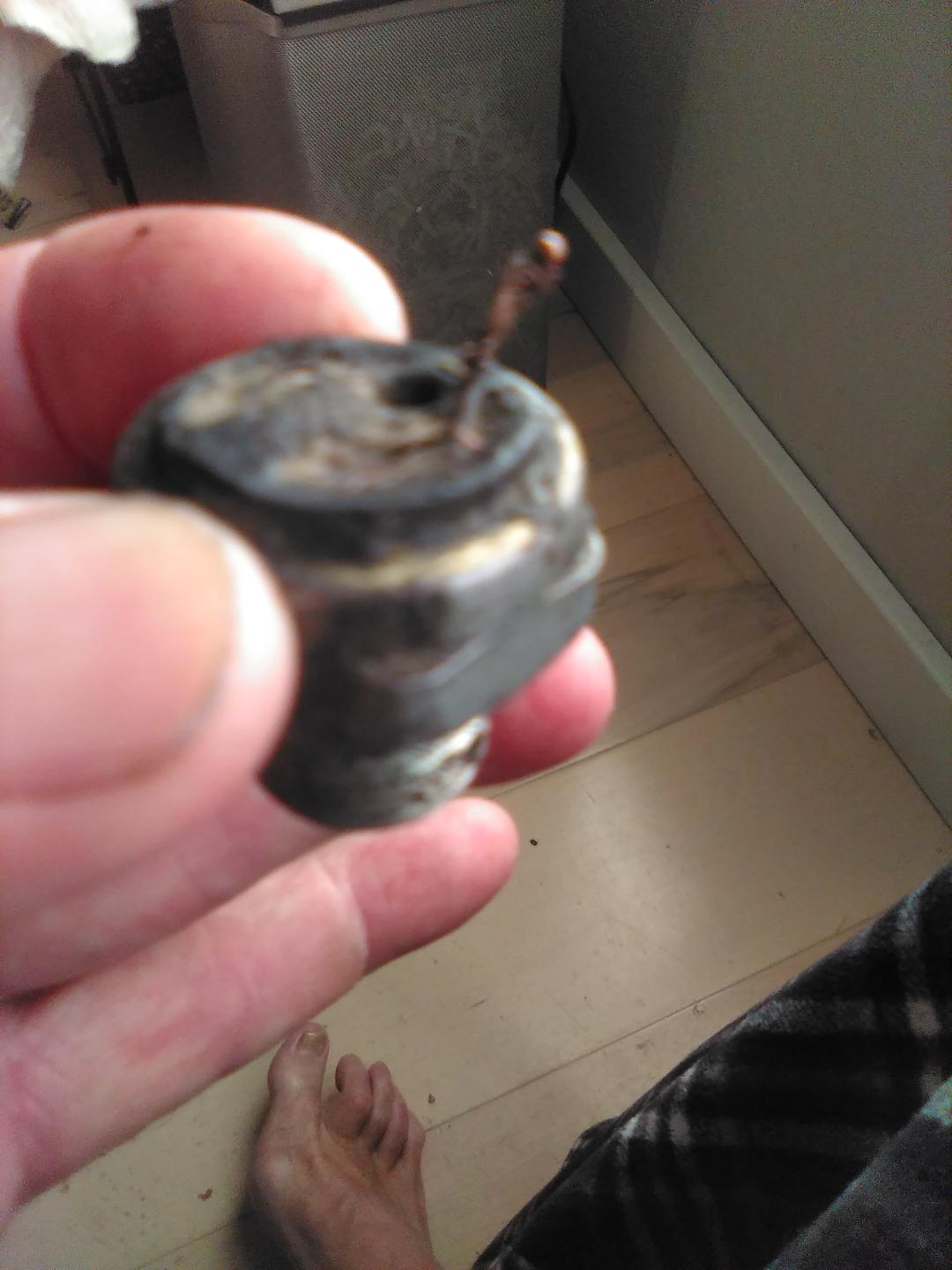

It is a mystery. Other than a few references here and there no one seems to know about it. I have the switch on my transmission but it is too mangled to get a good picture of it, it is just an oil plug at this point.

Thanks, I think I will try that, do you know if just one wire is on the switch? I have a small piece of one (wire) sticking out of the epoxy but it doesn't show continuity if I push the button on the bottom of the switch in. I will have to tear the whole switch apart.

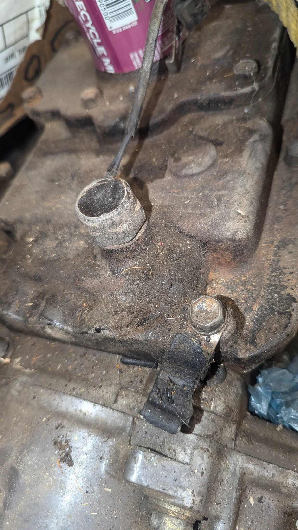

Here is the 78 transmission I pulled from a 71 I parted out thirty years ago.
I find it interesting the cover has the boss on where the reverse light switch is used with a split transfer case.
Thanks! It looks like 2 wires coming out which would explain why the one wire I have does not ground when the switch activates. The switch must ground the wire I'm missing...Right?

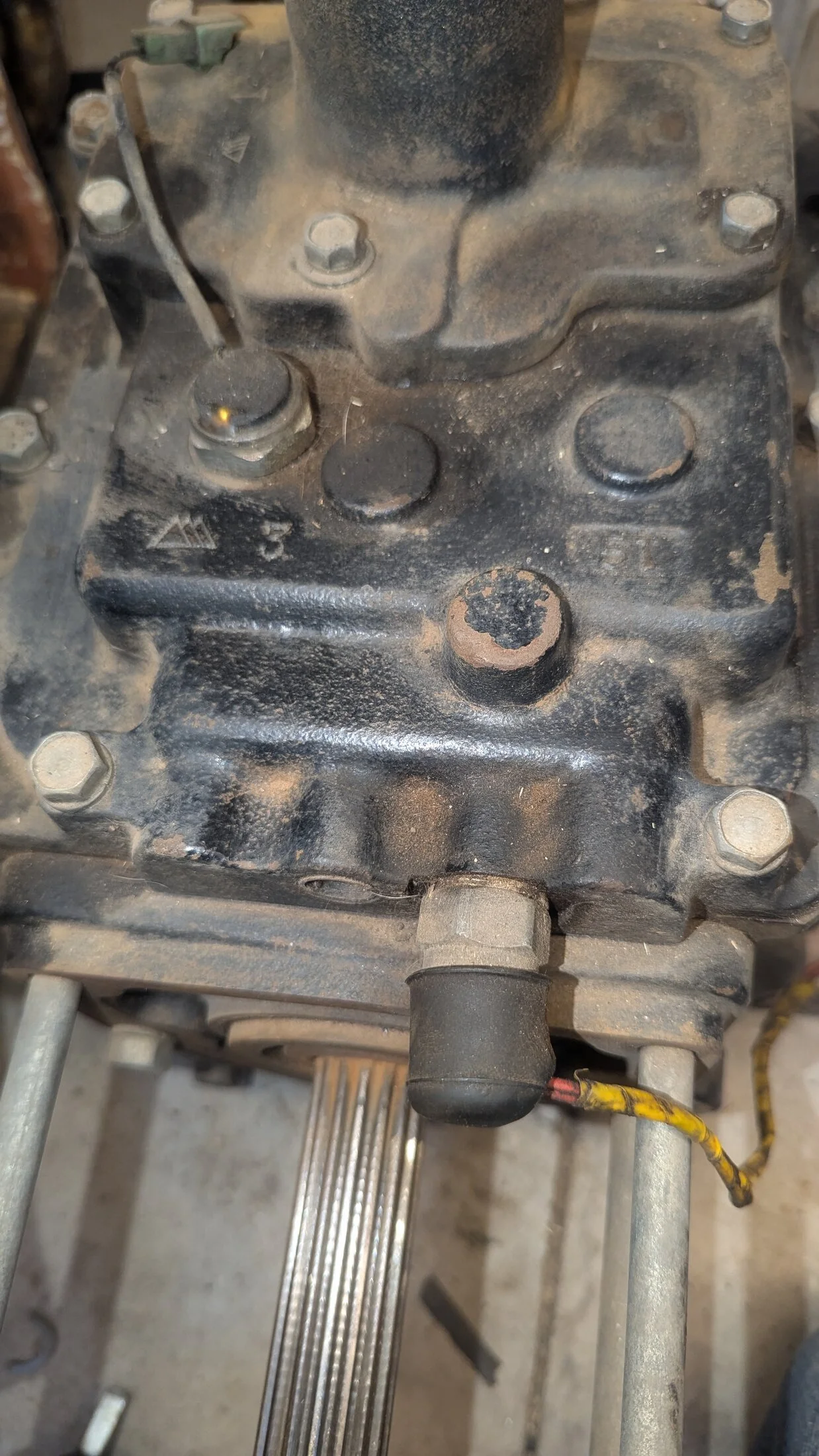

Second picture is of a H41 out of a 84 HJ47RV from Australia. The switch on top is a reverse light switch..it moved from the back to the top to clear the split transfer case. Thought it was interesting the early four speed cover for the 40 series (cast iron versus aluminum) has the boss the could be drilled and tapped for the reverse light. That could come in handy if installing a 60 seriss four speed into a 40 series. Keeps the transmission shifter in the same location.
