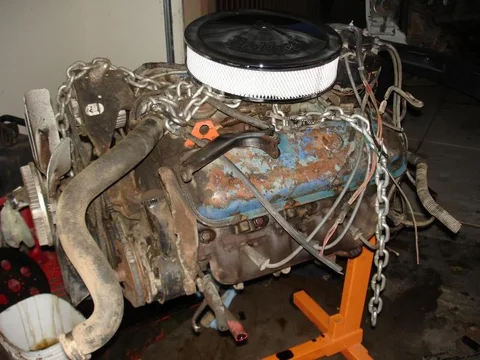

I also got the motor on the stand finally so that I can start going through it and resealing everything. Mind you this picture is AFTER pressure washing the motor for about an hour. I still have a lot of cleaning to do before I can reseal and repaint. Now that I have the motor on the stand I can clean up the mess I made and continue on with the project.

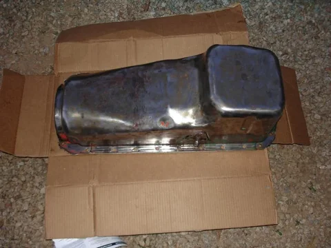

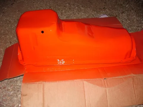

I was planning on working on the motor all weekend but ended up taking an impromptu trip up to utah for the weekend with the wife. So tonight I worked on it some more, got some more stuff off the motor and started cleaning the whole thing up to repaint it all. I got the oil pan completely stripped and repainted too.
