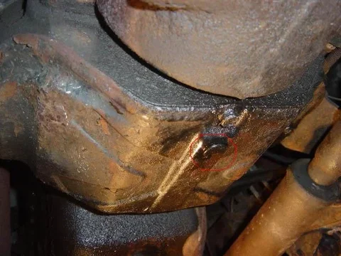

i was just looking at the motor to tranny and how it was set up, i think it was a crappy job who ever did it. can someone post pictures of what there engine to transmission plate looks like mounted on the rig. i can see my flywheel and see about 6" of a gasket where something is supposed to go there. ill get pics up in a bit and all i am thinking is thats a quick way to destroy stuff going down a trail.
35"s should probably have disk.
That red circle is just a plug not there to keep oil in.
heres what im talking about
