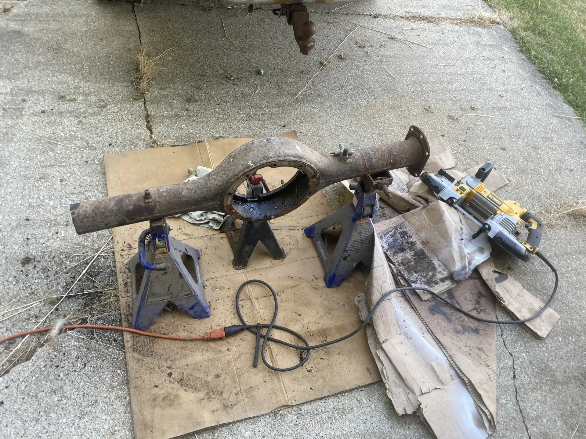

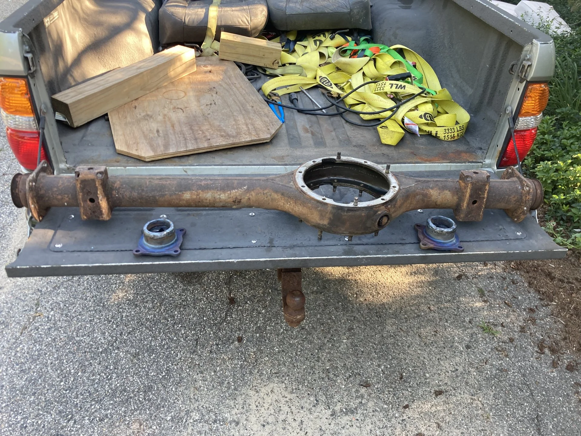

My current project is a wider centered 40 rear.

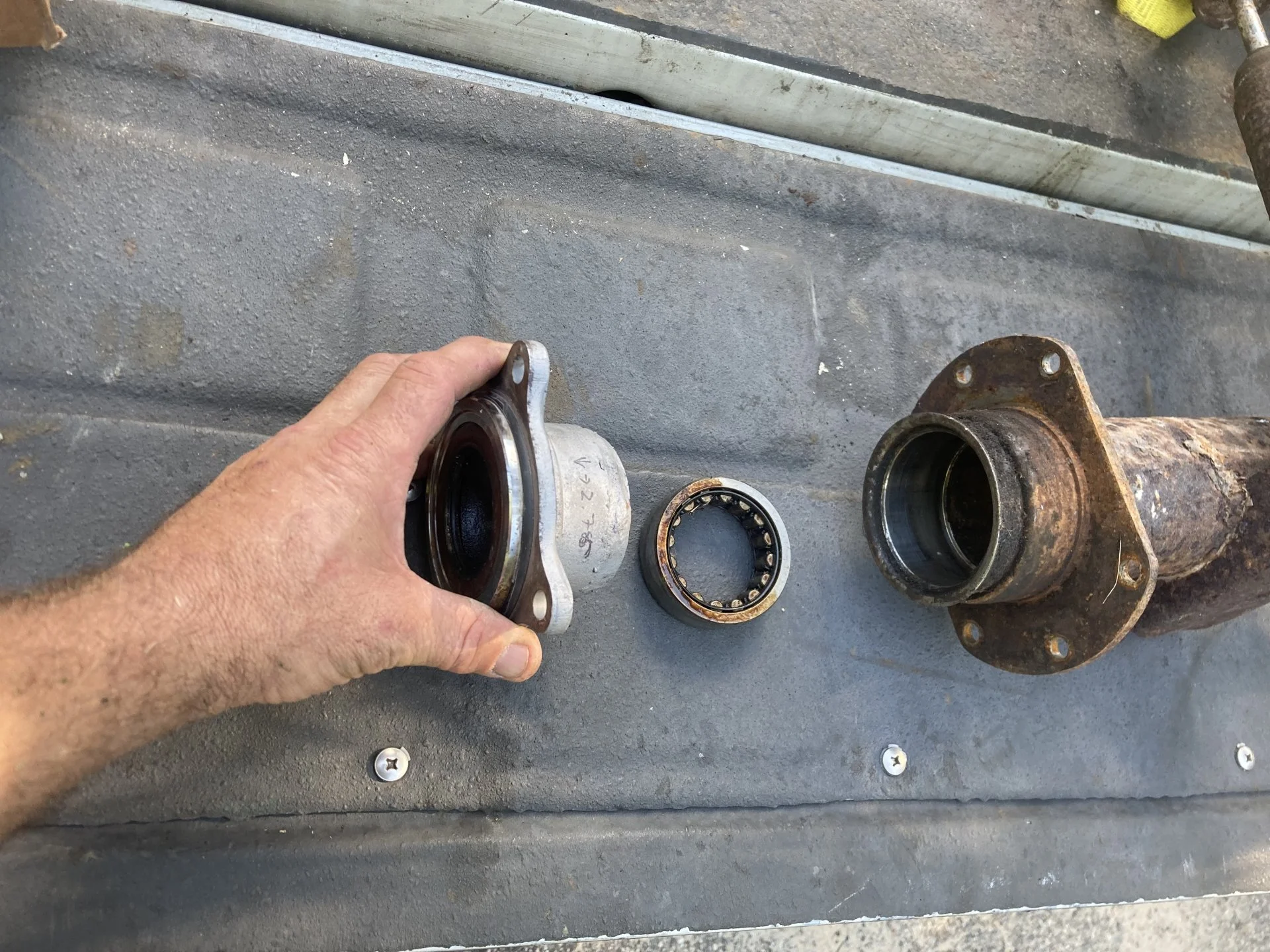

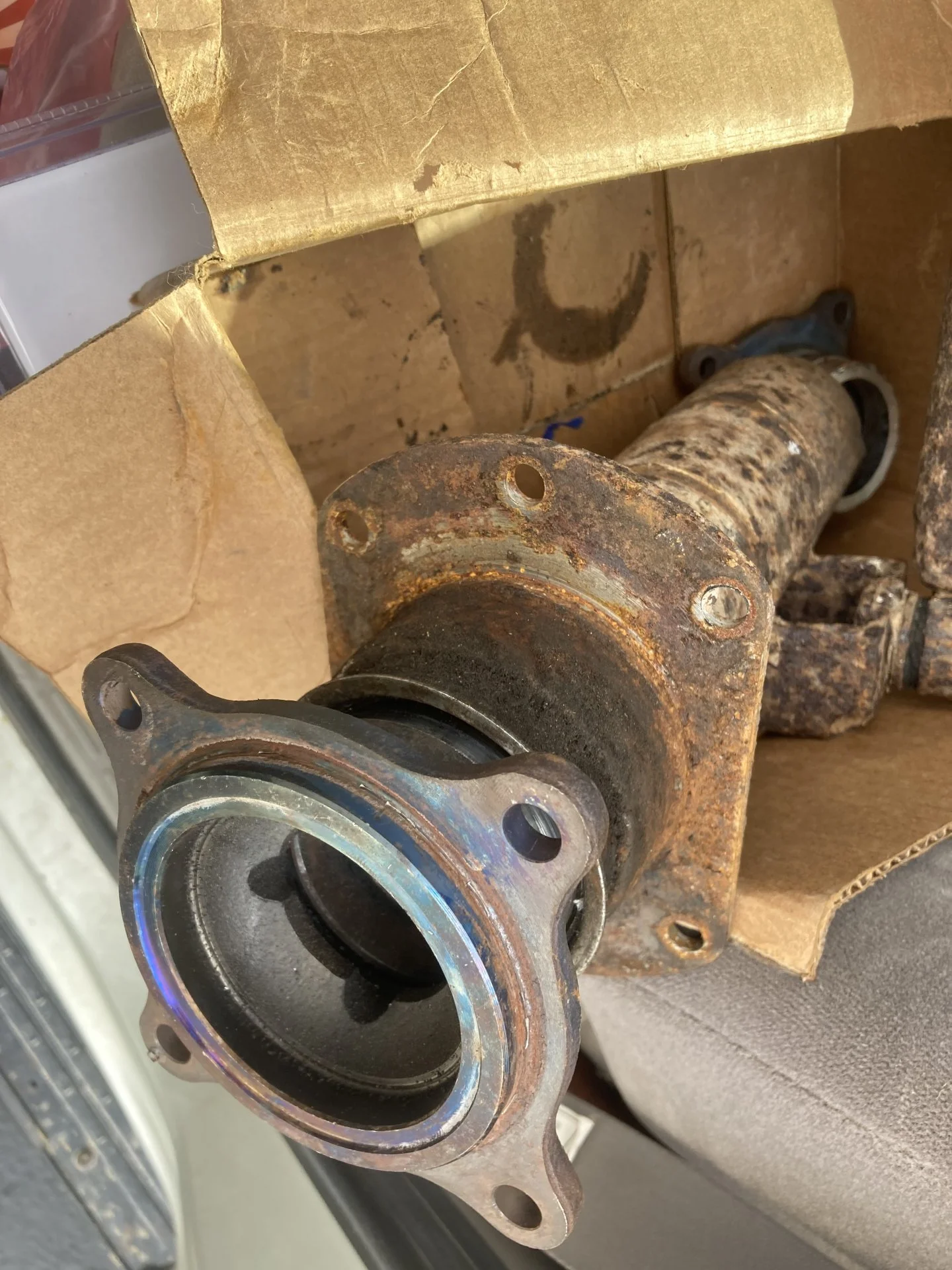

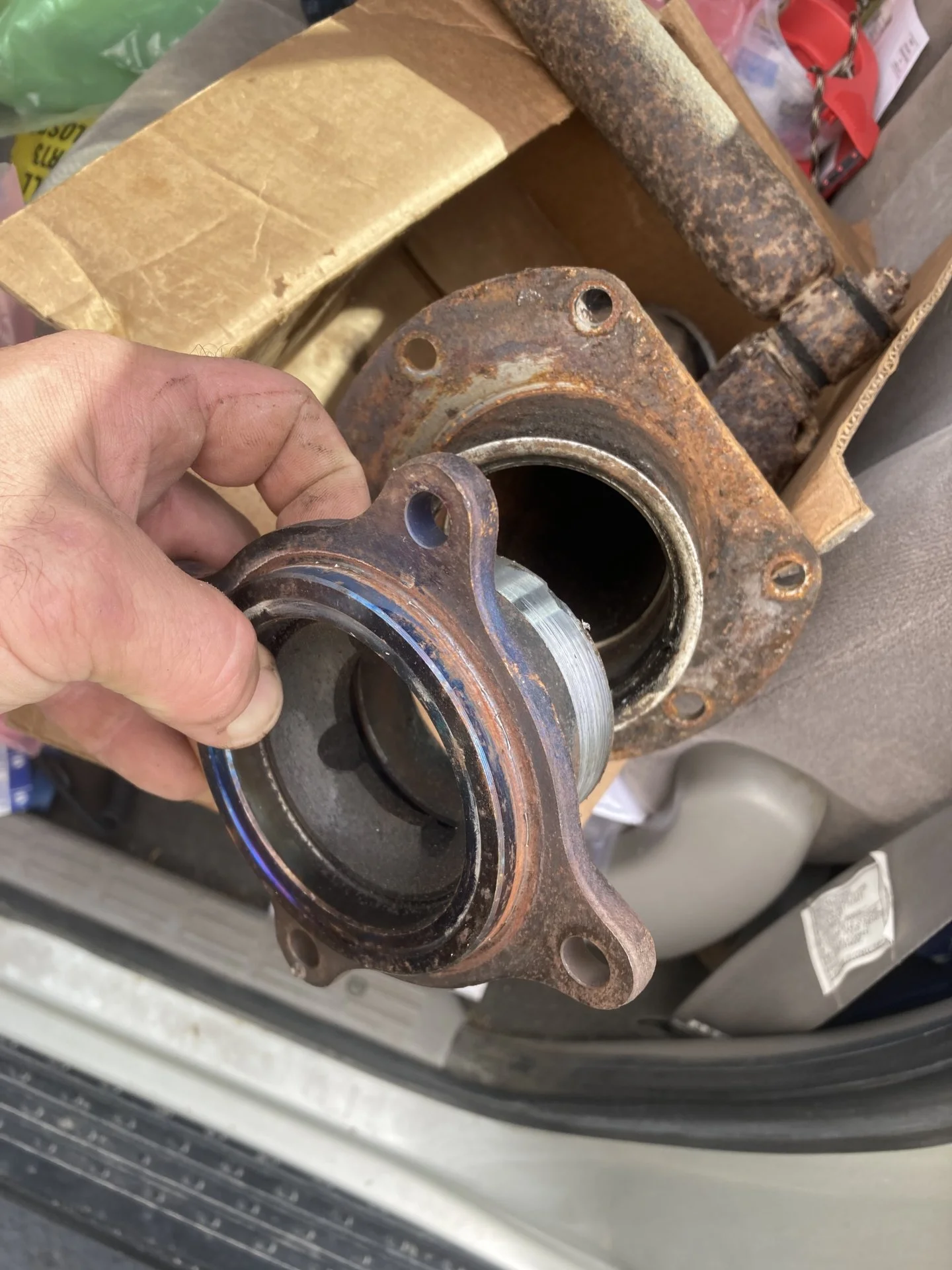

I had a 40 rear housing (free) laying around and cut it as wide as possible anticipating finding a 80-85 mini truck rear ($300) to slide the tubes into and weld together like many threads have shown. The 83 MT housing I bought was swedged weird and the tubes couldn’t slide into the 40 tubes.

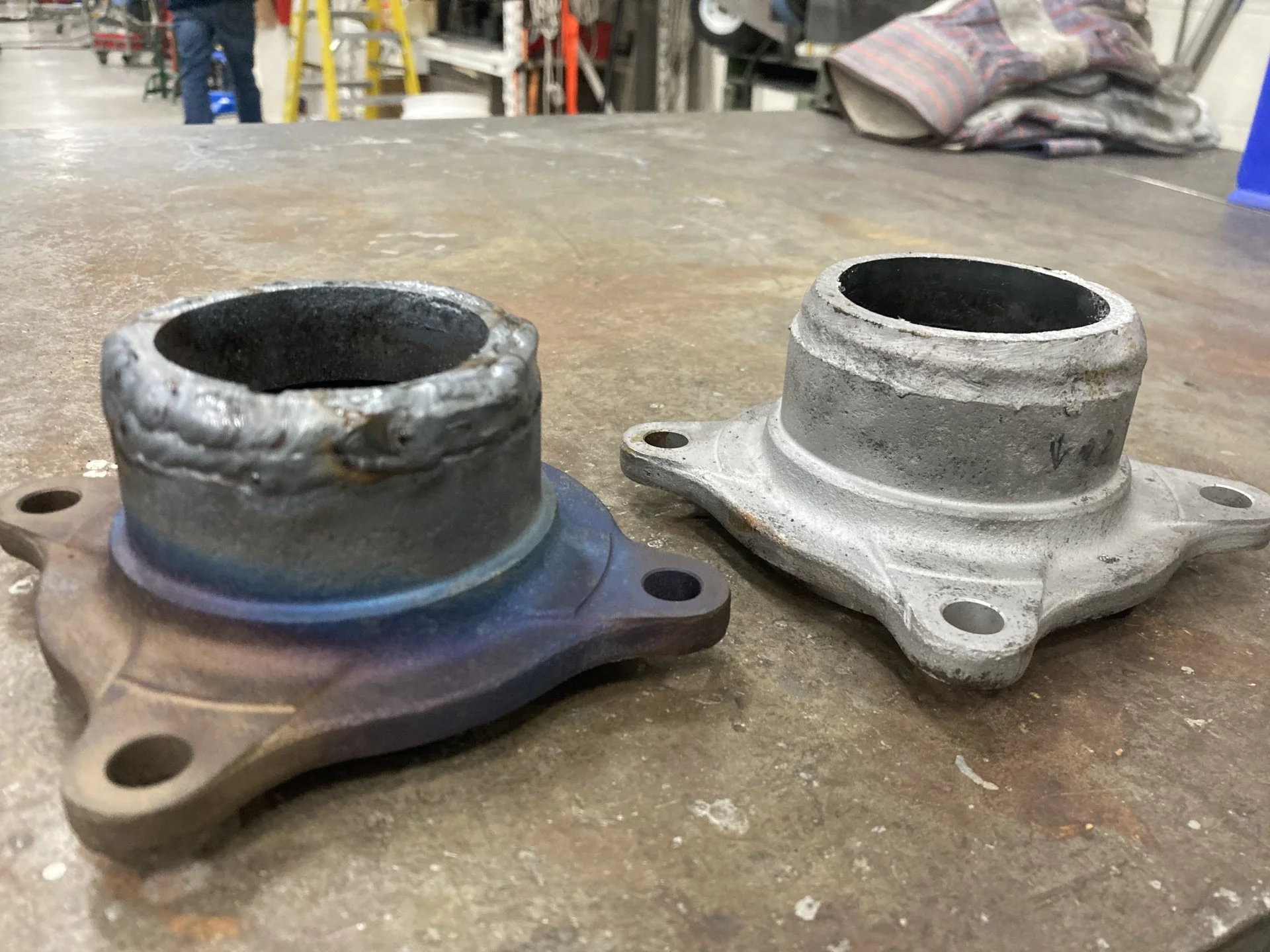

What I figured out is that I can lathe turn the ends of the MT axle to press into the 40 bearing ends, then determine my overall housing assembly with the 96 4Runner shafts ($25).
I’ll try to update this with my progress.
