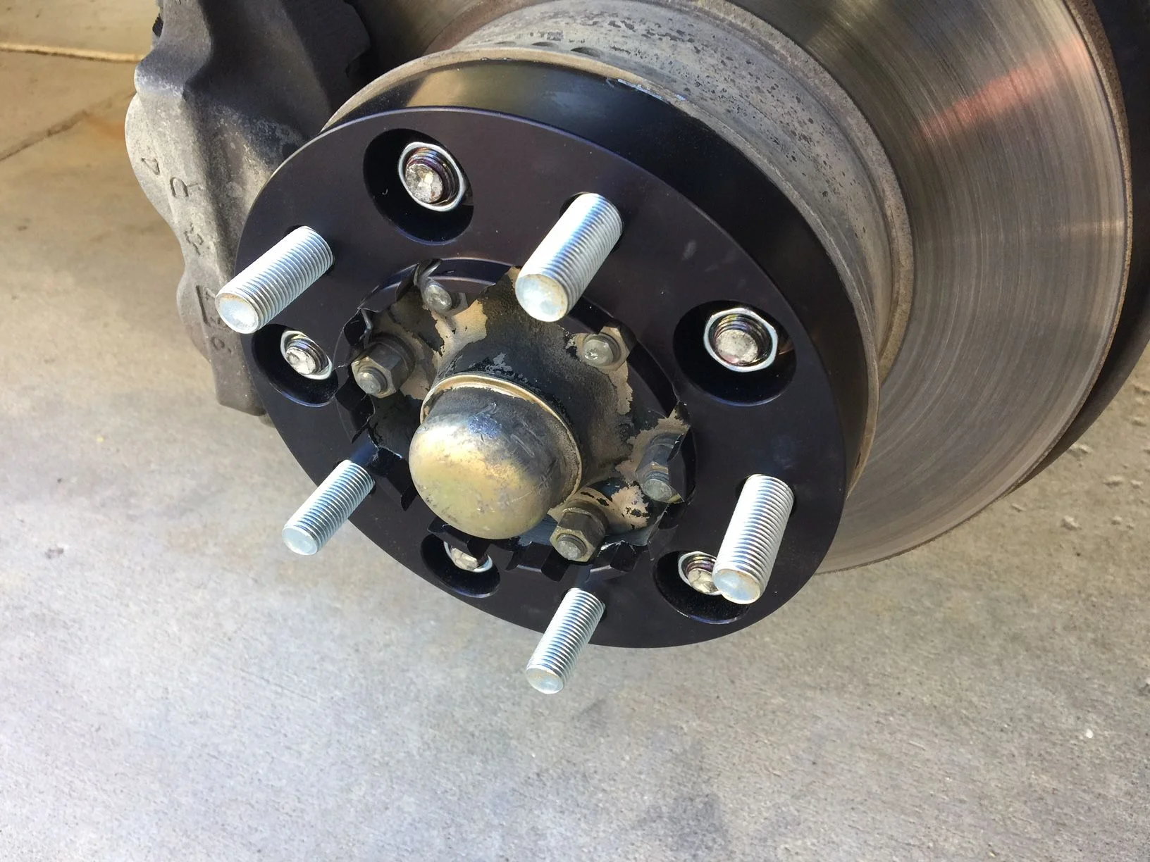

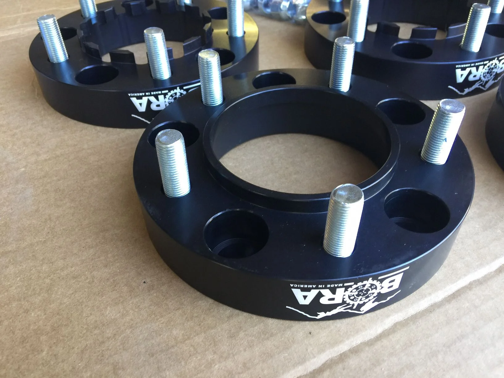

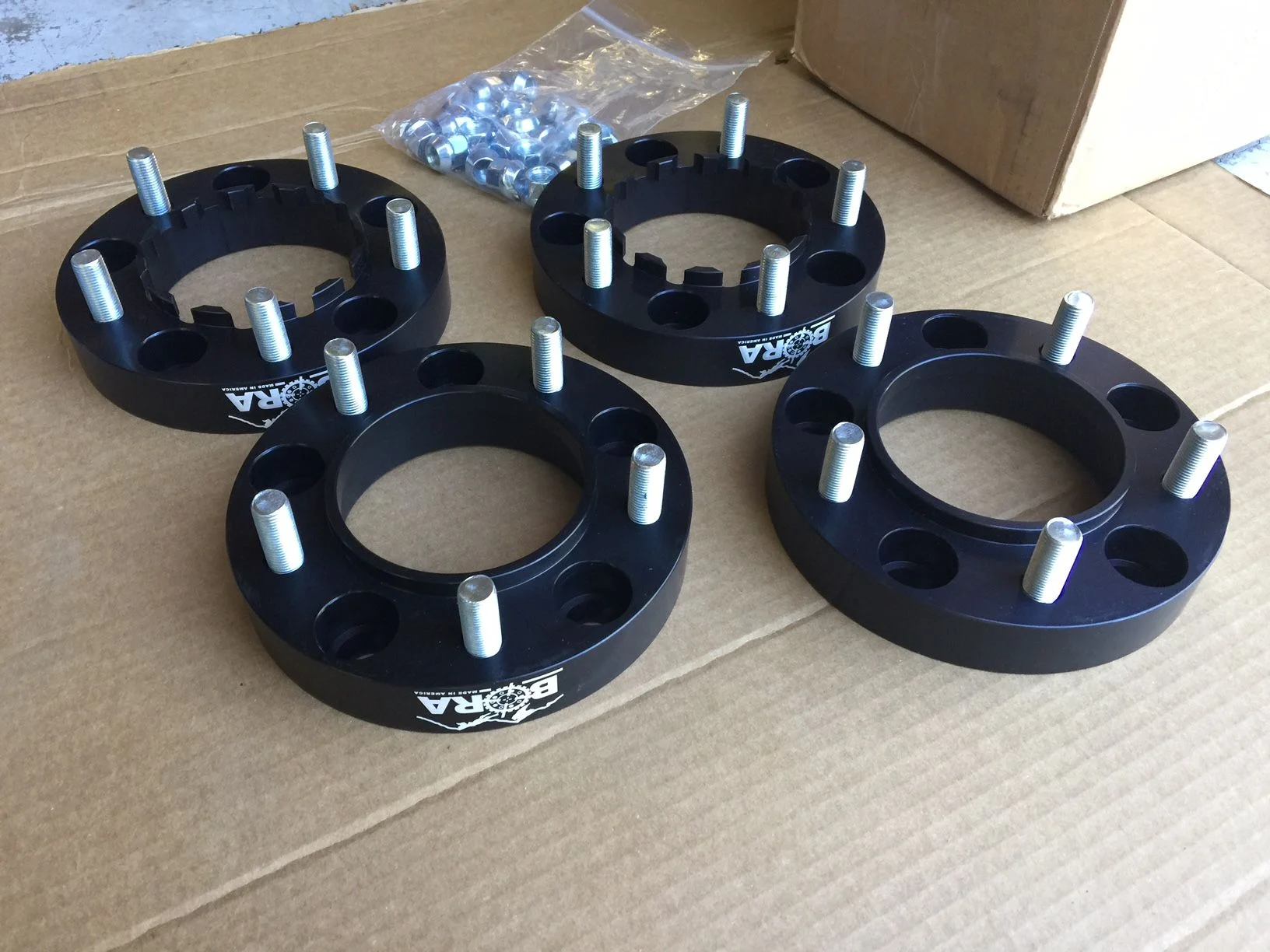

I installed (sort of, more on that later) a set of Bora Motor Sports wheel spacers for the 100 today. Man, the quality of these spacers is simply awesome. The fitment was perfect, no machining marks, individually serialized, quality all around. I got mine in the 1.25" thickness but they are made to order so you can spec any size you'd like. They took a few weeks to ship but they seem worth the wait. They come with a lifetime warranty and I am stoked about that since I believe they'll stand behind the product so you know they are making a product they are proud of.
Nicely machined... includes the set of acorn nuts.
You can see the fronts on top in this pic have been milled to accept and fit the front drive flange on the hub. The rears have the hub centric lips milled into them. The fit was outstanding when mounted up.
Serial number... nice hard anodizing.
The fronts really are a work of art. Lots going on here if you look at the details, wall thickness, undercuts, material removal... now to find a thin walled socket to pull the drive flanges without removing the spacers (think trail fix for a blown diff).
Cleaned the mating surface of the brake rotor, applied a super thin coat of anti-seize against the mating surface and along the hub flange just to eliminate any corrosion/bonding between the two. I am not sure how our Colorado chemicals used for snow will react with the aluminum so this was a precaution and I am not sure it is necessary. Then I added a drop of red thread locker onto the wheel studs and torqued them down, re-torqued them again, and I will again after I get some miles on them.
Here is where the before and after pics come in. However, I broke 2! of the wheel studs off the rear of the 100's rear axle on the drivers side... :rant: I swear I am going to have all of them replaced before too long! I have them coming in tonight and I should be able to wrap up in the morning.

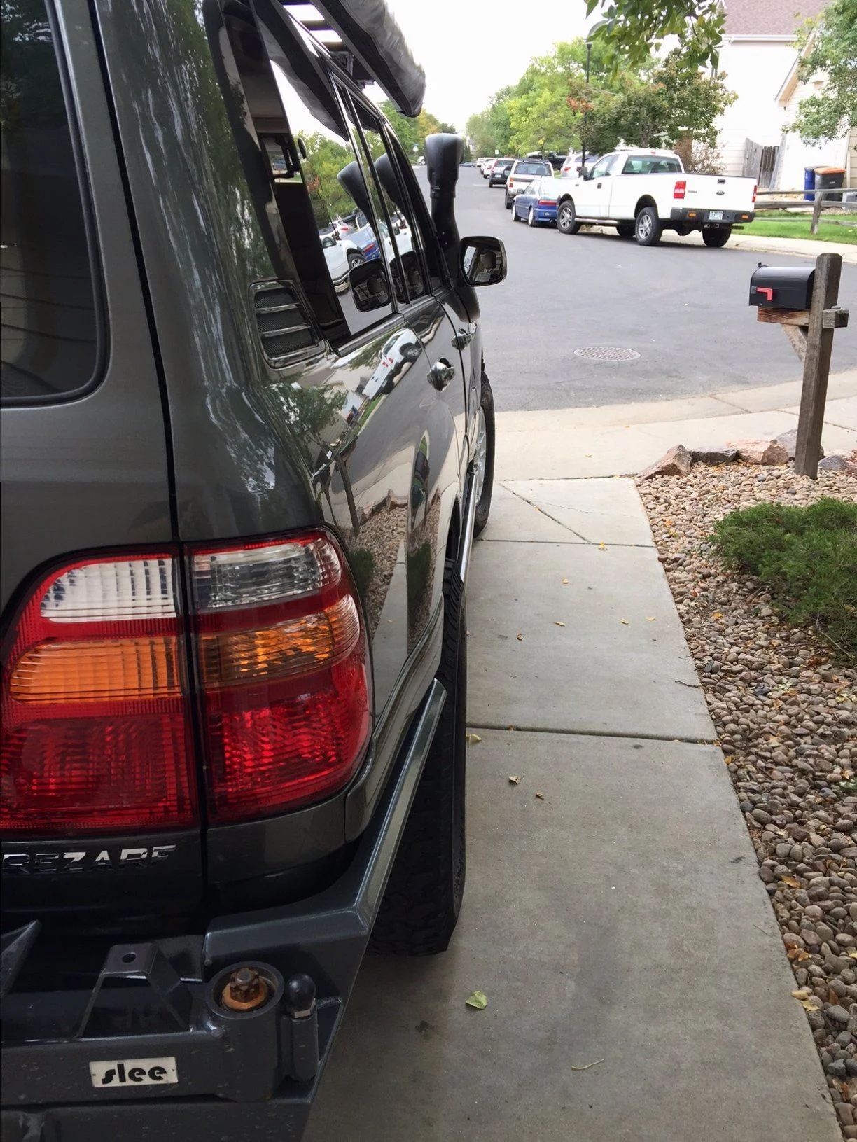

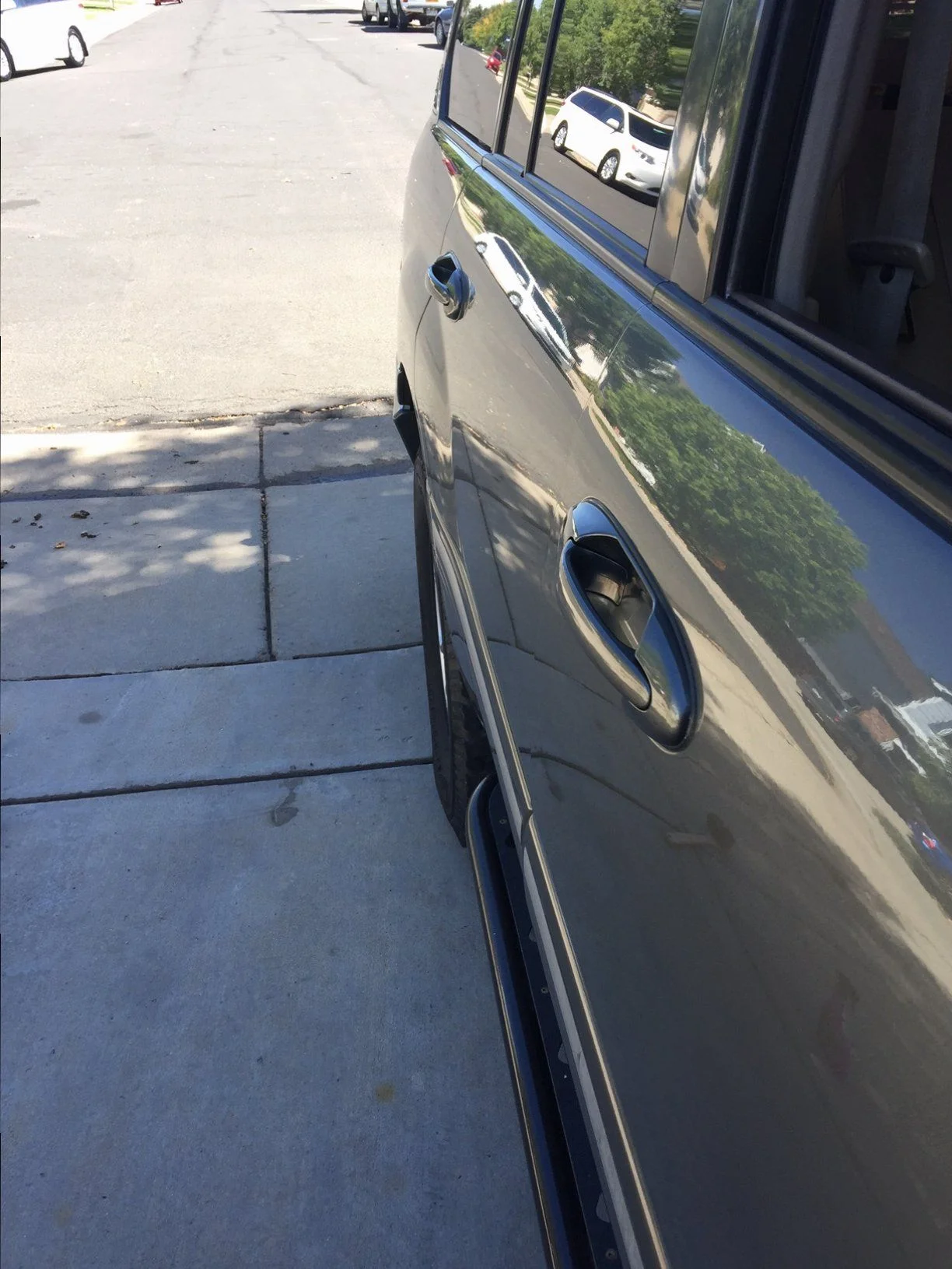

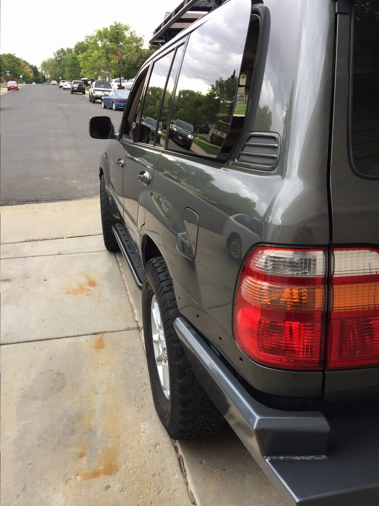

Here are a few pics of before and after...
Before...
And After...
My iPhone has too much "fish-eye" to make a good comparison in the pics but it does change the overall look. I wouldn't hesitate to go 1.5" if you are adding a lift but again i'll have to confirm post lift to see if I get into the fenders at all. The stance width is most noticeable and different looking from the front and rear when looking dead on. I always felt the 100 had too much of a freight train look to it with a wide body and the wheels tucked up too narrow underneath... this is a good mod to alleviate the rubbing but I gain some preferred aesthetics as well. YMMV.
Again a little more tire poking out...

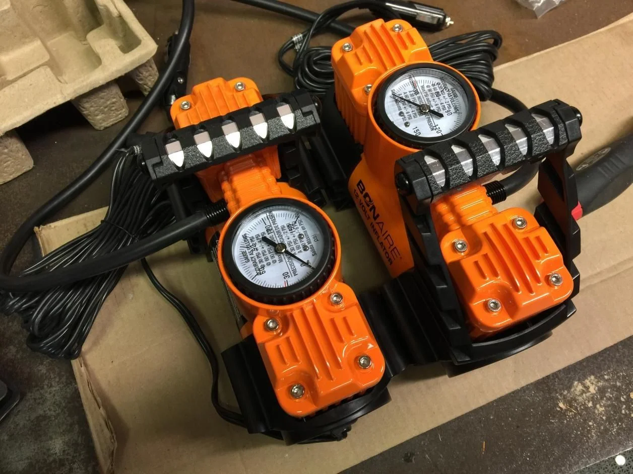

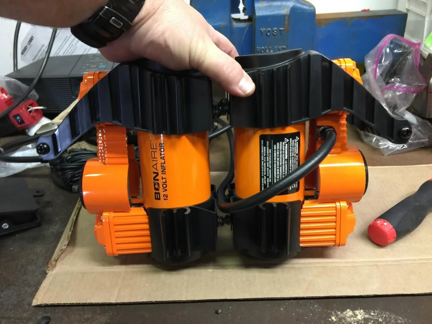

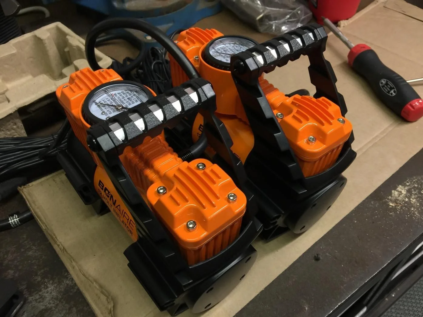

I had a hair-brained idea to take 2 twin cylinder air compressors from Costco and make one QUAD-Cylinder compressor for my 100. I don't want to clutter this thread and I'll do a summary write up thread but here's a link to the build thread on my local forum... My quad compressor build... - Rising Sun Member Forums
Here's a few pics for you guys...
