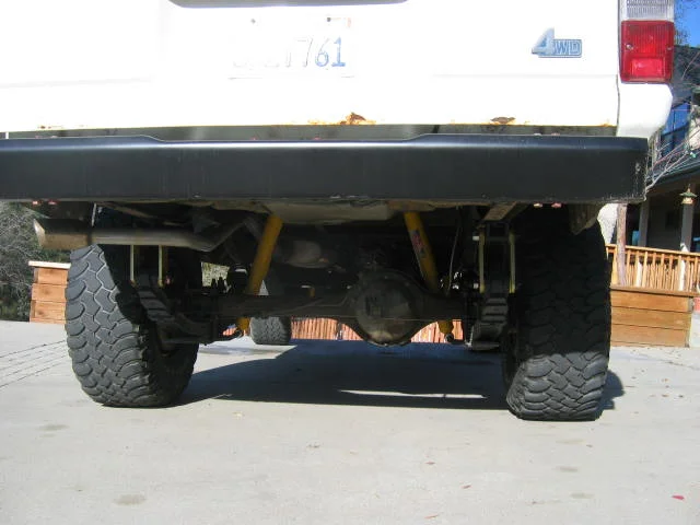

Here is a pic. I like the way it looks so much cleaner under the vehicle.
I like mine too, although they have bent like Dave-T's and the shock mounts are a little sketchy - IMO.

Do I need to take a better pic of mine?
I guess you better, my '82 60 has nothing on the top of the axle tube. It uses round u-bolts over the top of the tube.
