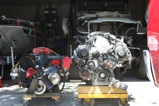

We have another member (@jesus888) who has a LS and H55 five-speed, and it's great. I have driven it and love it. People have been putting small block Chevys in these vehicles for years. The 2UZ 4.7 engine produces between 235 and 282 horsepower, which is comparable to a small block. I love the idea of using all Toyota parts. You'll have plenty of power and reliability.

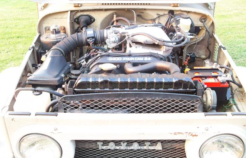

I've also seen some with the 3.4 and that is a solid engine as well. Super relialbe but not as much power as the 2UZ I don't think you could go wrong with either of these but I would go with the 4.7 if it were me.

The main consideration is how much work you're willing to put in and how original you want your build to be. I haven't done extensive research, but my instinct tells me that the 3FE engine would likely be the easiest option. You could probably use the same motor mounts and possibly even the same transmission bellhousing. That being said, it seems like a lot of work for not that much gain.
The other two options would require new motor mounts and likely a new transmission and transfer case, or at least some sort of adapter for compatibility. You also would have some serious wiring mods to do as well. Be sure to do your research, clarify your goals, and avoid overestimating your budget, skills, and timeline. I would hate for you to take apart your Land Cruiser and not get it back on the road, especially if it is "running like a champ" right now.
