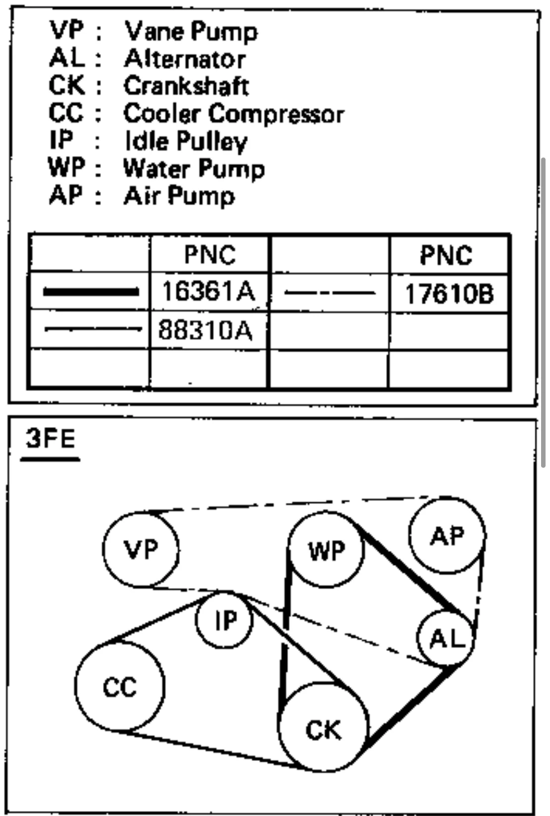

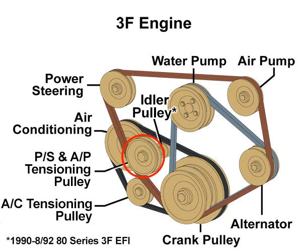

Anyone have a PN or know of a suitable replacement for the bolt that goes through the bearing plate and bearing on the power steering idler pulley? I was replacing my belts the other day and had a hell of a time loosening that bolt due to how rounded off the head is. My 14mm socket kept popping off and I just about lost my cool after the 12th time hitting my knuckles on the fan shroud. Now its gnawing at my OCD and must be replaced...This is the pulley that has a bolt going through the face of it, not the AC idler which has a nut on the outboard side to retain it.
