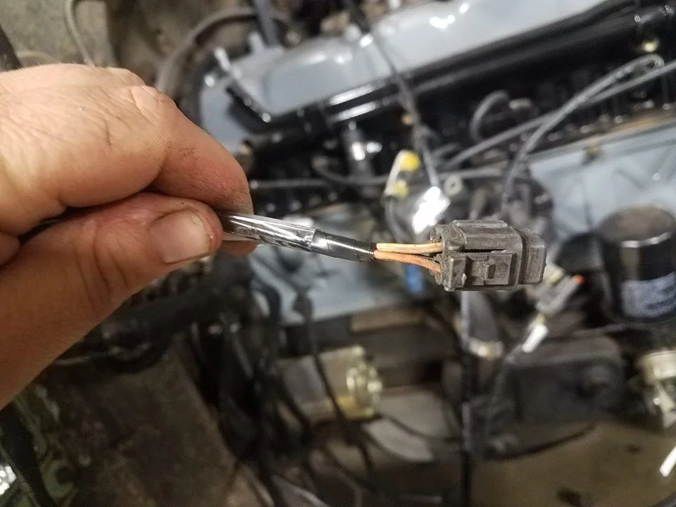

Cowl side 02 sensor.. no problem here.

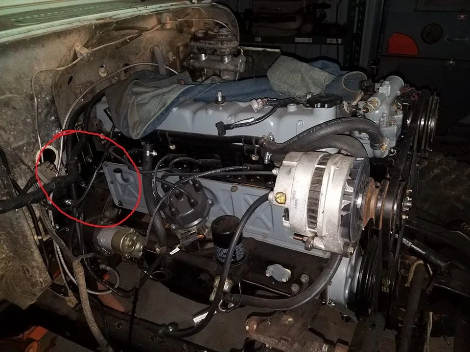

The engine harness one, comes out near where I've got the red circle in the next photo, and is short, but needs to go across to the exhaust side.. but I'm missing that part of the harness. What can I do!
