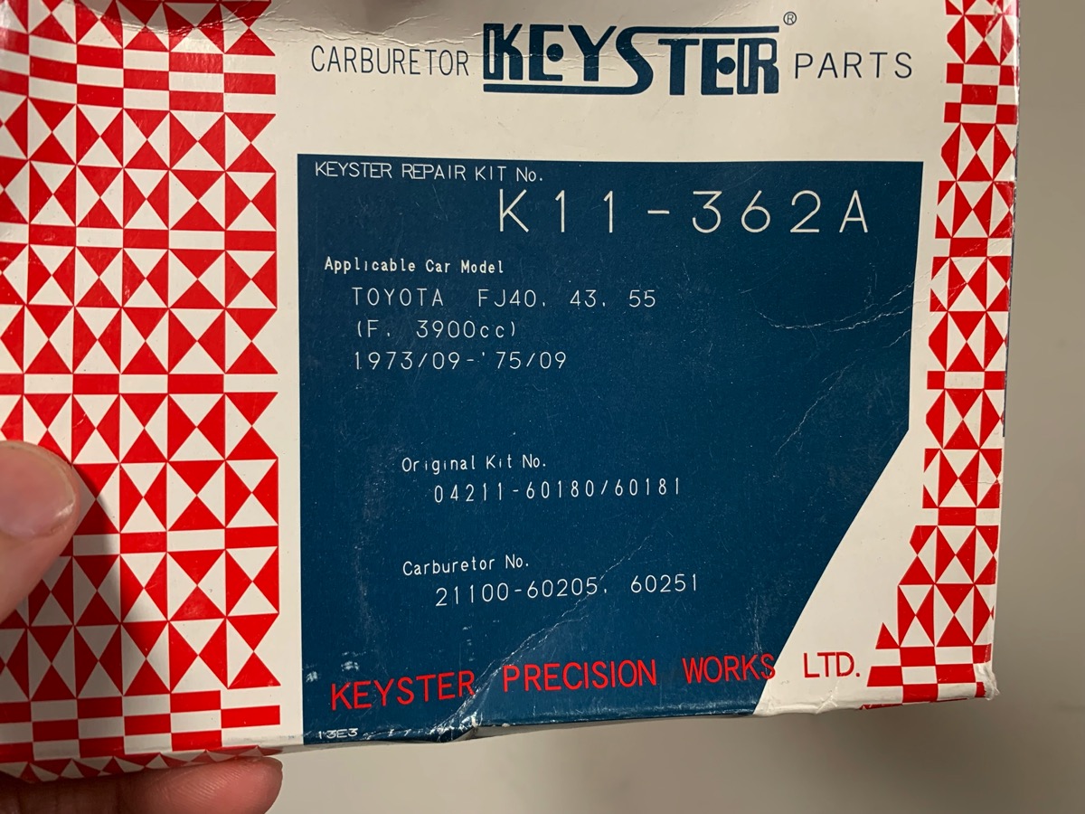

I started with this Keyster kit. The gent who's 3F had gone south and gave me the Chicom carb also gave me this kit. He said that @cruiseroutfit had supplied it, so that's your best place to find it I'm sure.
I snagged the Hygrade 791B kit as well for the better air horn gasket as well as the secondary diaphragm. This came from Rockauto.
I'm not sure why you use 1974 F carb kits for your rebuild?
Just looking quickly to the PN it even seems the OEM carb kits are still listed available for the 3F.
I'm not entirely sure either, except that it was given to me a free and the explanation given was that it was recommended by @cruiseroutfit for this application. That may or may not be the case, but I'm sure the kit came from them.
I have not been able to source an OEM carb kit. Curious where you've managed to find one.
Once I reinstall I'll report back here with my findings on performance/improvement.
Do you know when/where that recommendation happened. Certainly something I may have looked up or recommended but I don't recall it. :D
We generally match the OE carb# to the Keyster application guide we have developed for carb kits. Oddly the box label and actual applications are not often the exact same, particularly for US spec Cruisers.
I have no idea... likely 3 or more years ago. Like I said, it was generously given to me with a brief explanation.
All parts in the kit worked perfectly for my 3F rebuild. The jets were the only part that didn't "match up" so to speak, so I installed the original jets. The jets that came with the kit would certainly have fit the carb if I'd used them. I test fit a few to verify.
