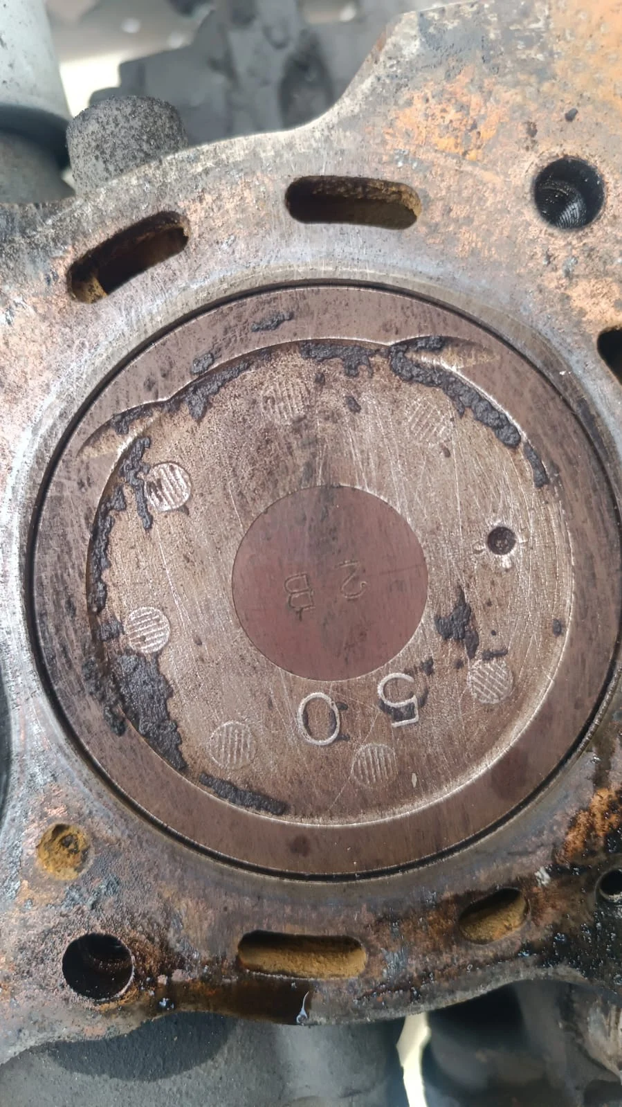

So, my initial plan was to just freshen up my top end, but after removing the head, it looks like I should replace my pistons/rings/crank bearings. My pistons have '50' stamped on top, so they may be 0.50mm over?
The pistons seem to have slop only in one direction, so I'm thinking they need bore. Question is, do I bore and put larger pistons, or do I put sleeves and std pistons?

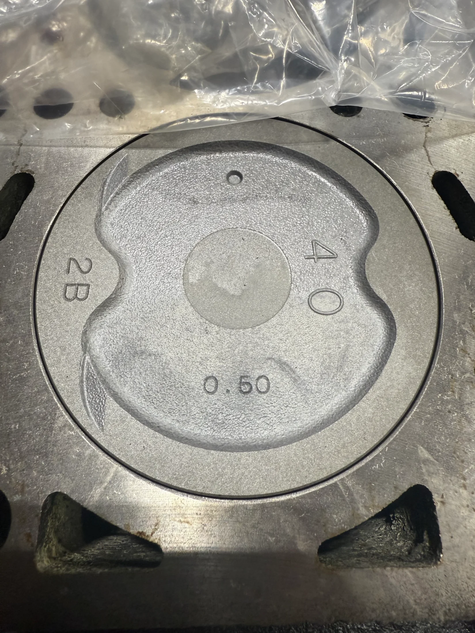

What year model is your 1fz? I have never seen Toyota pistons with those little circle stamp marks. You can buy new Toyota pistons .50 or 1.0mm over. You can’t buy sleeves for a 1fz that I am aware of. This is a picture of a OEM .50mm over piston.

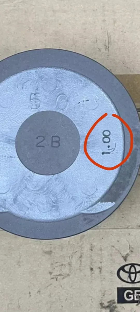

I found it down here in Ecuador. Also, I'm beginning to think that the "50" stamp does not mean it's bored 0.50mm over, because of the "40" stamp you shared. Also, a mechanic friend shared this picture of an 1FZ piston bored 1.00 over.

It would be best to get the bore wear measured to see if the wear is within spec or not before you jump into reboring or re-sleeving it, if the 50 is 50 oversize there's probably not much left to rebore
So, from the machine shop, the pistons are original, but the cylinders aren't round. It will be bored +20, and I've ordered pistons/rings to match (as well as crank bearings, oil pump, timing chain, rod bearings). All parts will be around $850
