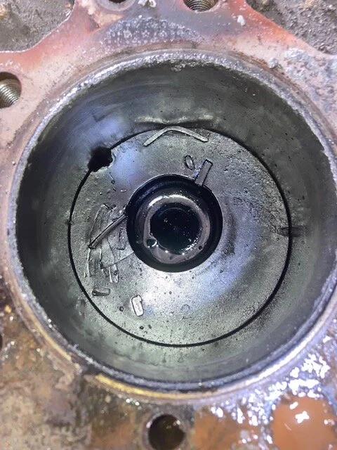

I recently pulled my 13B (with after market turbo from previous owner) from my 81 BJ42 because I heard a concerning noise. Blew a hole in my piston and there were metal pieces on top of my piston. Had a shop assess the injectors and 1 of 4 were operating normally.

as you very well know even a 13bt can make holes in its pistons sooooo....... its just an outcome thats in play with any turbo engine.
retard timing to keep paek cylinder pressure low, keep iat low ( intercool), keep egts low, higher boost helps lower egt to a point
