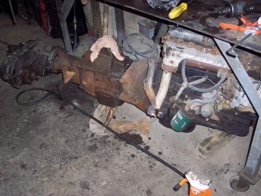

look closer! the pic ,to my best judgement is a 3b diesel mated to a sm 465 granny tranny with a np 208 t-case ! how is this possible?asked here last year for very same set-up and was told it was impossible. what are you referring to as a big block? 3b diesel is a 3.4l 4cyl.isn't it ? diesel forum and a diesel can't be reconized in a picture ... what gives?
this is a 3b diesel in a jeep mated to a bull-low chevy 4spd and then coupled to a clocked np208 t-case ! question is what bellhousing is this and how was it mated to the 3b diesel engine ? anyone know? why would that picture of the engine ever be perceived as a big block anything ? going from gas to diesel is exactly what I did.:bounce:

I would think you'd need a custom bellhousing since the input on the 465 would be long enough to be used with a 3B bell. Or maybe a custom spud shaft adapter with the 10 spline female end and 21 spline male end?

post up some more pictures, is there any adpaterplates in there?
proof it works ! I guess. no criticism for not being in an LC please. awesome little engines ...ready for a turbo now.

Looks like a regular "B" series bellhousing to me. Why not just use an H41 low range 4 speed? Same 1st gear as in the H55F but without the perceived weakness of the overdrive. It's a non-USA tranny.

because I needed something more common and without all the t-case adapters ! also the chevy dana 60's frt and rear req'd the 208 or a 205 to be behind the tranny ! didn't want offset 60 rear , not common when you bust rear axle in the bush . Plus 6.55:1 to modified 3.2:1 to 5.86:1 equals crawling . and yes to the others , 3b definately improves a jeep. best mod ever .
