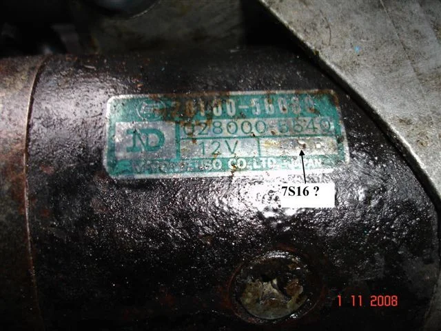

This is all that my starter motor tells me (and I have been careful over the years to avoid damaging that sticker):
There's no mention of the power rating on my starter and as far as I can make out, those letters are "7S16" or perhaps "TS16".

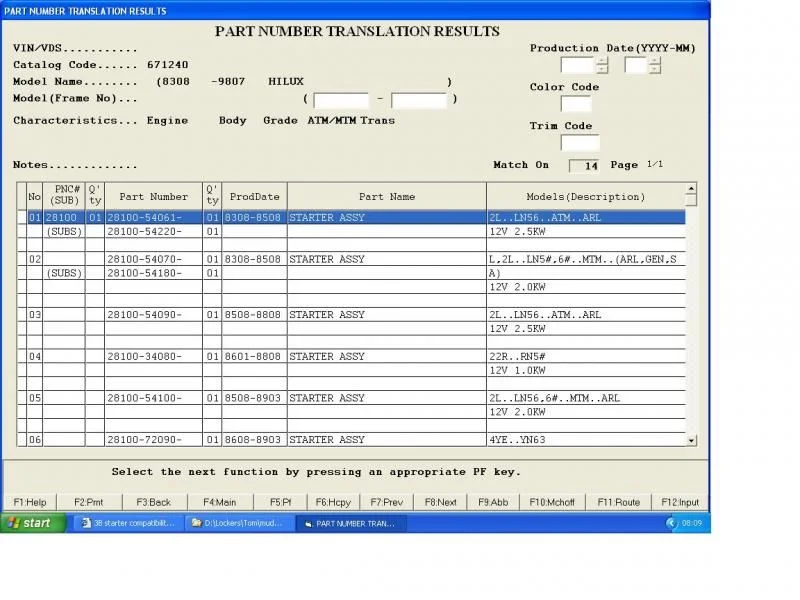

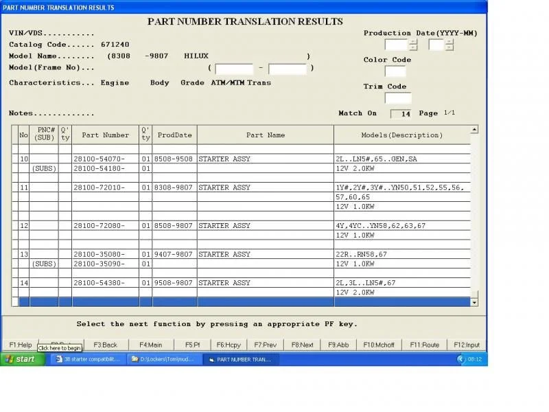

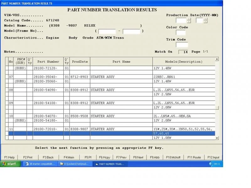

:idea:Had another thought here Thomas
Had a squizz at the EPC:
This tells me that there is a trap in that various Hiluxes employ 0.8kW, 1.0kW, 1.4kW, 2.0kW and 2.5kW etc starters. (Not sure if they're all the "gear-reduction" type.) So perhaps you should find one with a sticker that says either
  • 28100-54061
  • 28100-54220 or
  • 28100-54090
Because the EPC says these are all 2.5kW
Edit later: PS. This last number is likely to be the one I'd go for Thomas. That's because I see it is the same part number that a member has quoted as having done a successful nose-transplant on. (They said "28100-54090-84" and I'm guessing the "84" means it was 1984 vintage.) Edit much later: 84 means "remanufactured"
PPS. I see the 1980's HIACE line also employed "2L" and "3L" engine models with 2.5kW starters having model numbers 28100-54052 and 28100-54220. Perhaps these are candidates for nose transplants too?
:cheers:

I've spent "all morning" on the EPC now and I think I was wrong earlier in suspecting that Toyota tended to standardise on certain "starter motor power ratings". I'm now finding Hilux/Surf/4runner models (all of them are the SAME to me which shows how little I know about them) with an almost infinite variation is starter motor power specifications. (I've even found some that are 2.7kW!)
So I think if I was Thomas, I'd have a good look at the EPC myself and find a starter motor off one of those "minitrucks" (whatever you like to call them) that has a sticker intact enough to show its part number. And I'd go for a part number that relates to a 2.5kW motor. And as a safeguard, I wouldn't probably stray too far away from my own vehicle's age (in case they changed the "nose-cone to starter-motor/relay bolt/screw pattern" in latter years).
