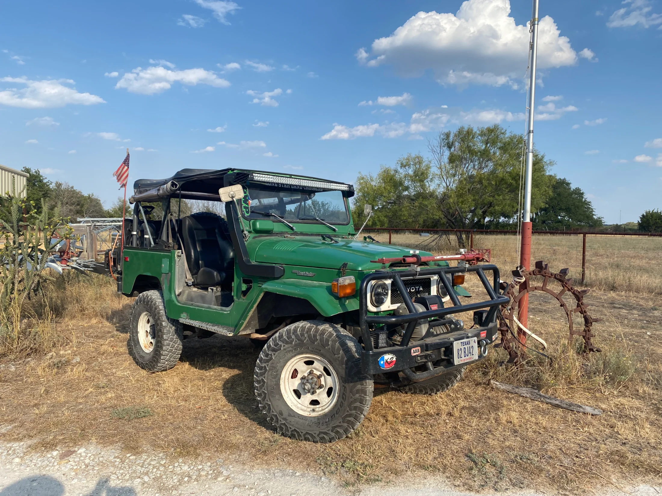

Anyone know of a good place to get a rebuilt 3B my 82 BJ42 has has had low oil pressure for years and it starting to loose power… and it doesn’t have power to loose 🤪. Also anyone swapped a 6.5 GM… I think the HUMMWV is 24volt as well 🤔… don’t know shy to do next
