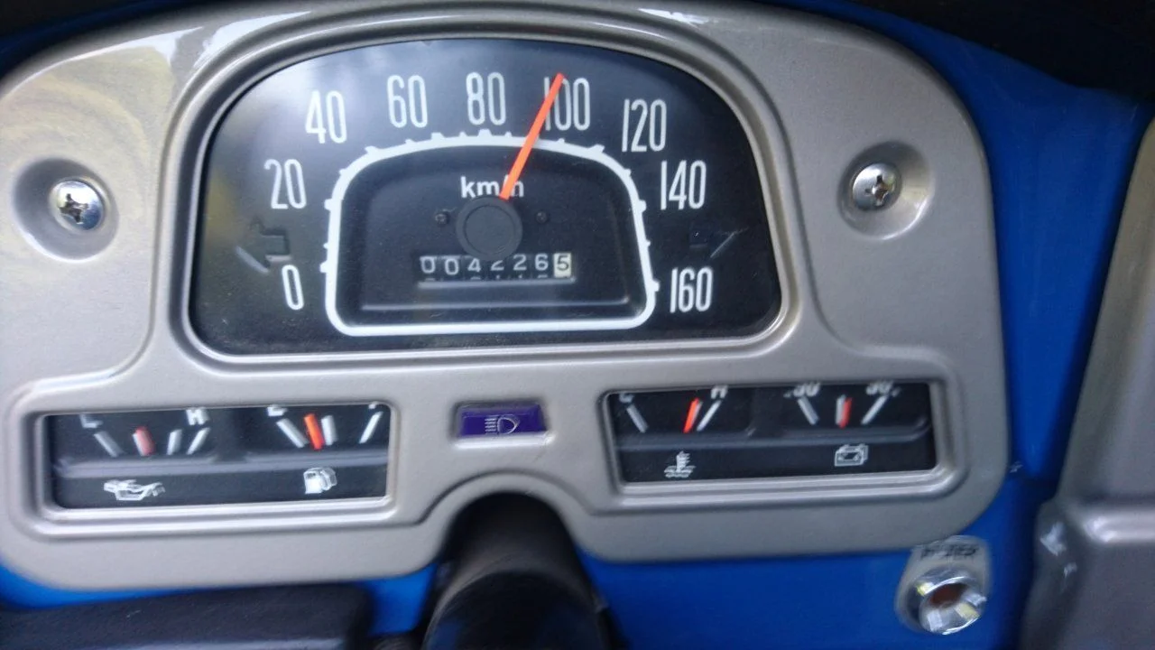

Yes I know that the meter is not very accurate.
But this is where mine climbs to at highway cruising speed.
Is it to high? Dosent seem to go higher than that.
If I am going to put a probe in the coolant hose for an accurate measure, whitch temperature is then ok?

yah for a toyota gauge that looks about right. My 3B gets the temp to about that much deflection on the gauge when on the highway.
If you have a hand held temp gauge (infrared) you could pull over and see what it is on a few locations like the water pump housing, the thermostat etc.

I do have an infrared thermometer, will try to measure in the weekend. But what temp should i expect as the max? 98C?
Oddly I am used to F, not C for engine temp. As everything I owned with numerical gauges is in F.
Operating around 200 is normal., Going up to 230 i've seen and is okay. Hitting 250 is bad. Boil over is imminent. With steam and other potential failures.
220 degrees Fahrenheit = 104 degrees Celsius
210 degrees Fahrenheit = 98 degrees Celsius
Got to remember boiling temp is not 100 C in a rad, it's higher. it's under pressure.

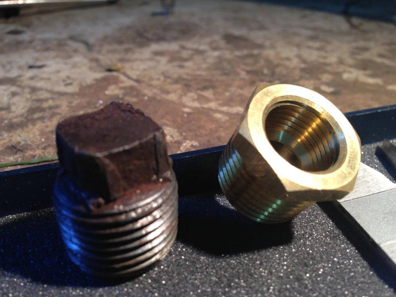

To be honest, I do not recall the thread pattern.
What I know is that : I bought the gauge kit in a local auto part supplier and in this kit, I found few adaptor that we can put on the temperature sensor thread pattern. One of these adaptors has the correct thread pattern for the houssing. I bought 2 kit from 2 different brands (Sunpro – Autometer) and both of them have the correct adaptor.
I have few mech gauge hardware at home. I’ll try to find if I have another adaptor that I can check.
I pretty confident that «most» of the gauge kit comes with several adaptors with the correct one among them.
The forward most sender plug on mine was 1/2" BSP.
I put an aftermarket gauge on mine and that, above all else allowed me to manage my overheating problem on a trip a long way from home. The factory gauge was inconsistent, inaccurate and slow to react. By the time it moved it was boiling over! That was a 70 series though.
I've got an alloy HDJ7x radiator now and an 82°c thermostat. On the road it runs between 82(normal driving) and 87°c (very big hills) (179-189°f) but my system holds no pressure due to a damaged sealing surface for the radiator cap. I'm hoping to be sand dune proof in summer once I get a new thermostat housing/the system holds pressure. It doesn't overheat now but I do need the heater sometimes.
Do no know the thread patern but I do know the size of this plug and adaptor is 21mm
1/2 BSP it is! Thanks guys!
