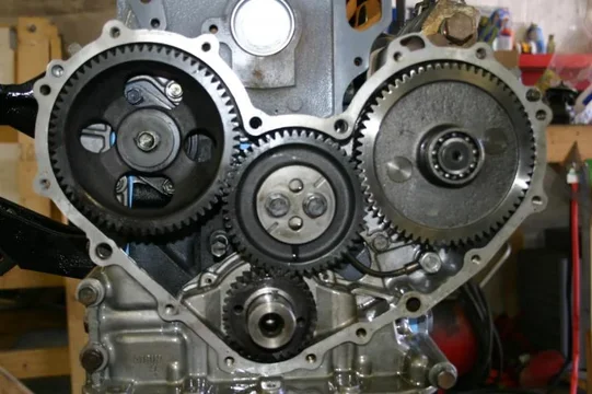

I didn't realize that the 3B does not have a timing belt or chain assembly so that makes me feel better.
This should make you feel even better.
They aren't exactly wimpy gears, either. ;) If you did something bad enough to have to worry about it being an interference engine, you're going to be buying a new one anyway....
