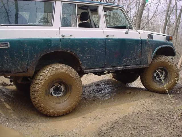

I was looking at mine and I think a q78 is about the perfect size for a 55. If you go any taller than that the tires get so wide that you will rub. You can't trim between the rear door and the wheel well (less that an inch)
SO on 37" MTR's
Doesn't rub sitting in the driveway at all!
Actually, it has been drivin a little and taken to the river for a little flex (not nearly how far it can go), and there were no rubbing issues..... so far.
I'm with you, I'll trim anything that gets in the way, but so far there has been nothing.

Pretty happy with my 35" MT/R's, except they suck on hard snow, especially with a rear lunchbox locker...low SOA, no rubbing despite pretty extreme wheeling. 37's with a higher lift would probably be fine.
This was my old rig and in the pic i have 36x14.5 on it but it was capable of fitting 38's easy...Had saggy springs and ALOT of fender(rust) trimming...With a real set of springs would have easily handled 44's but had to sell her and damn do i miss her...
But got me a new one now so all is good....
BTW.. the fender flares were TOTALLY custom...lawl
It's my pig, sprung over on 37" MTR's. I was buying tires, and when I priced them at Walmart, the guy told me it would only be like $3.00 more per tire to get 37's instead of 35's. So of course, I did.
The springs are getting pretty flat, so there is a little rubbing- but only in front- the wheel wells have that lip in front, and the tires have straightened that out a bit. Nothing bad. I plan on re-arching the springs, or maybe a minimal body lift for proper clearance- but it's not really that big of a problem.
I wouldn't have it any other way. Get the 37's, you will love them. End of story.
