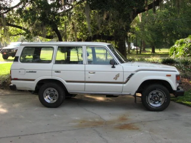

I am getting ready to buy another 60 I am planning to run 37s on it. I wanted to know what needs to be done to run these. I am planning on doing an SOA does there need to be a lift on top of this? 2.5"? I know these tires are a little big for the stock axles but they will stay there for now untill I do a 4BT swap and new axles. Also I have 37x1250x17's on 17x8 rims with 4.5" backspacing. They are 8 lug rims. Will these work with a 2" adapter or do I just need to look for some different rims? I did not want to get new rims for the time because I will be putting 1 tons under it with the swap. thanks for the info guys.

Hi dude .. nice to hear someone have great plans for other lovely 60 series ..

Would be pretty nice to see this 60 with the 4BT ..
