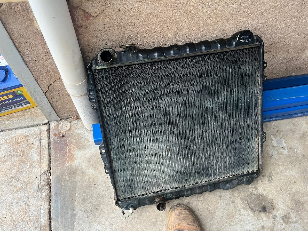

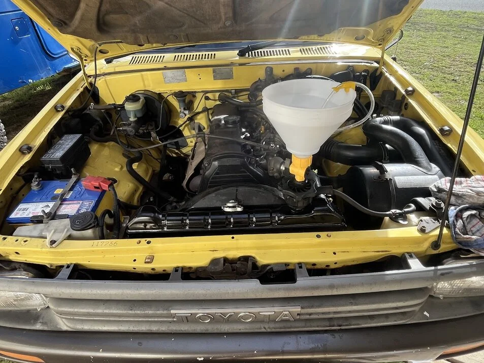

I changed out the radiator in my 2L powered LN85 Hilux today. The factory unit did 36years of service. Impressive!
A brand new brass/copper radiator has gone in, along with new hoses. For those in Australia the new unit was an Adrad radiator, $750.
The old one was weeping coolant along the top tank seam.
