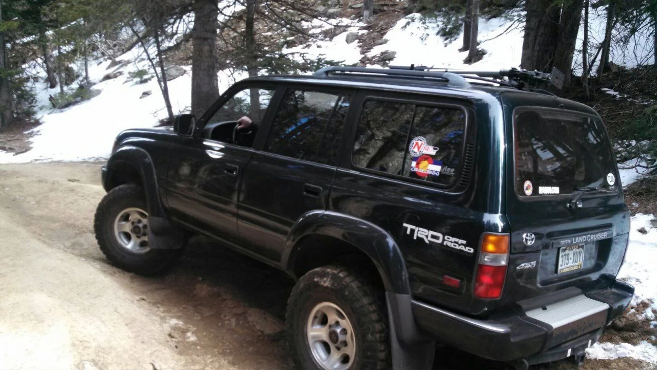

315 dura tracks on stock rims and 4 inch slee lift.

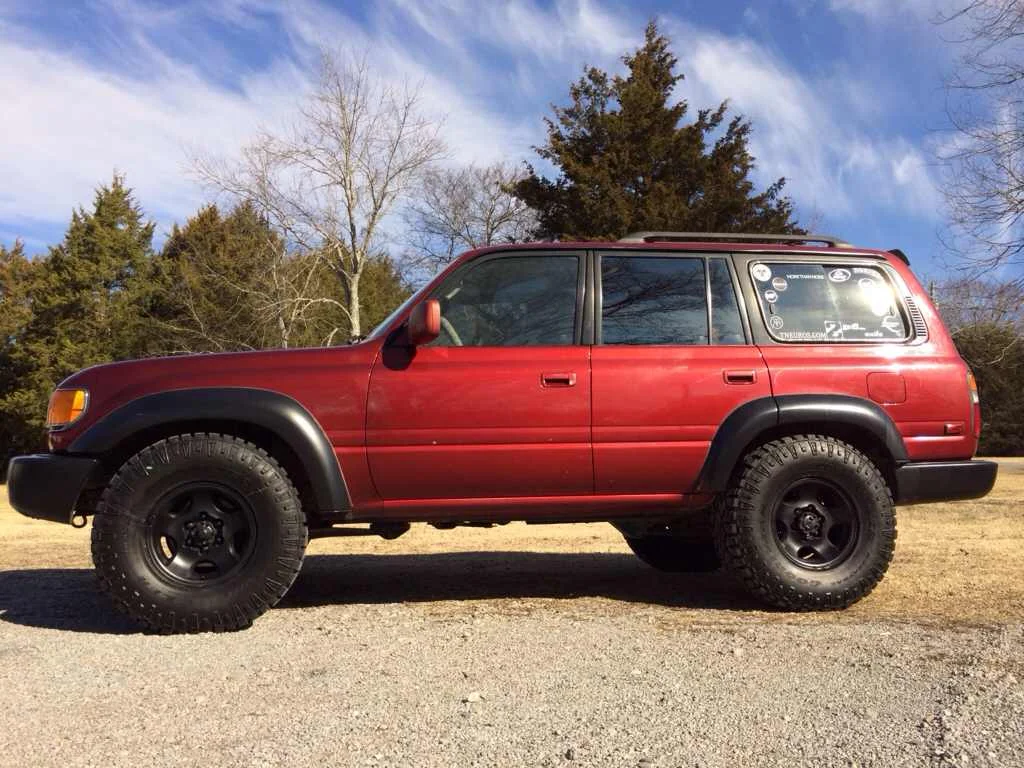

No hitch you can get a 315 75 16 under it. Hitch will push the tire towards the diff. Tire deflated and a ratchet strap you can get it to fit with the hitch.
Both my 315 Duratrac and Grabber red label would not fit under. They both contacted the panhard bar. I can no longer try but I'm confident my Toyo's would not fit under either. Maybe a BFG AT as those run small. My 295 Nitto TG barely fit.

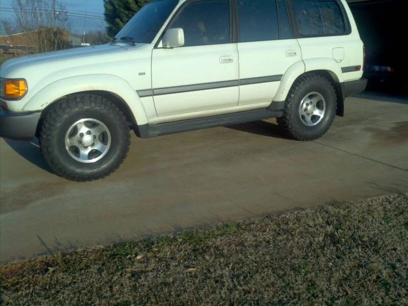

Ok let me then say it this way. The Firestone discovery 315 75 16 will fit with no hitch. With hitch I have a ratchet strap wrapped around it with it deflated to give me that inch I needed. ;)

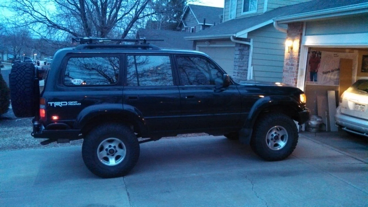

Here's mine when it had the 315s and blown shocks w/ stock springs. It was that weekend before I could put the OME suspension on.
