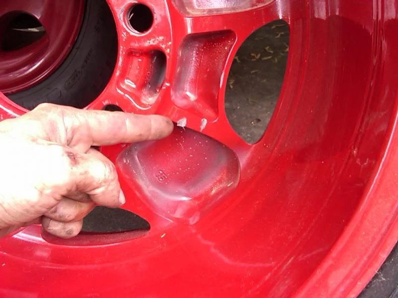

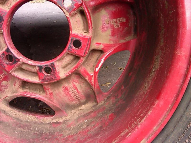

UPDATE on running 80-series wheels on the FJC...
I discovered the 4 wheels I had on the truck are different from true factory Toyota 80 series wheels. I bought the 4 wheels from one seller and they fit my truck fine, but the 5th wheel I bought that has Toyota markings on it does not clear my front calipers. It fits the rear axle without issue. I will have to shave the wheels or the calipers or both to remedy this.
I'll post pictures up soon of the differences. The front looks identical except for some serial number markings, but the back is much more different than I first thought.
If anyone can identify the manufacturer of this first wheel, it might help solve my issue. Top photo is unknown "Japan Style" alloy that looks like an 80 series wheel. The bottom photo is an actual factory 80 series wheel. You can see the mark left by the brake caliper as I tried to mount the wheel on the lugs.
