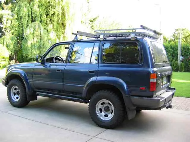

I have the med OME lift with 33" tyres. No bumpers front and rear but I do have sliders.
I think it makes a great setup for my needs. Sooner or later you'll want sliders anyway

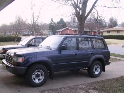

Before and after. In the first pic, I have stock set up with a "bad" shock on rear driver side. I got almost too much lift in the rear after the OME.

That's exactly the look I'm going for, thanks! Dirk, did you do anything to "correct" the too-high stance of the rear? If not, how is the ride?
