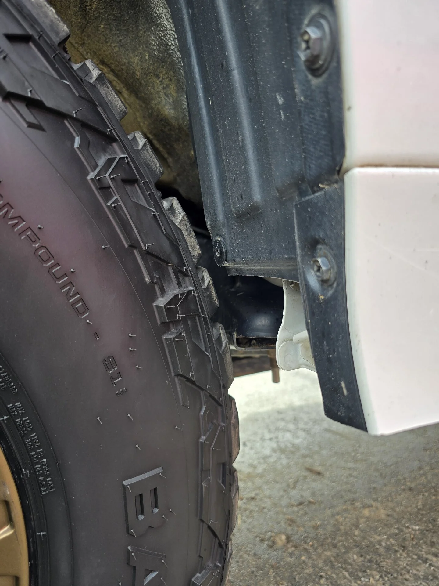

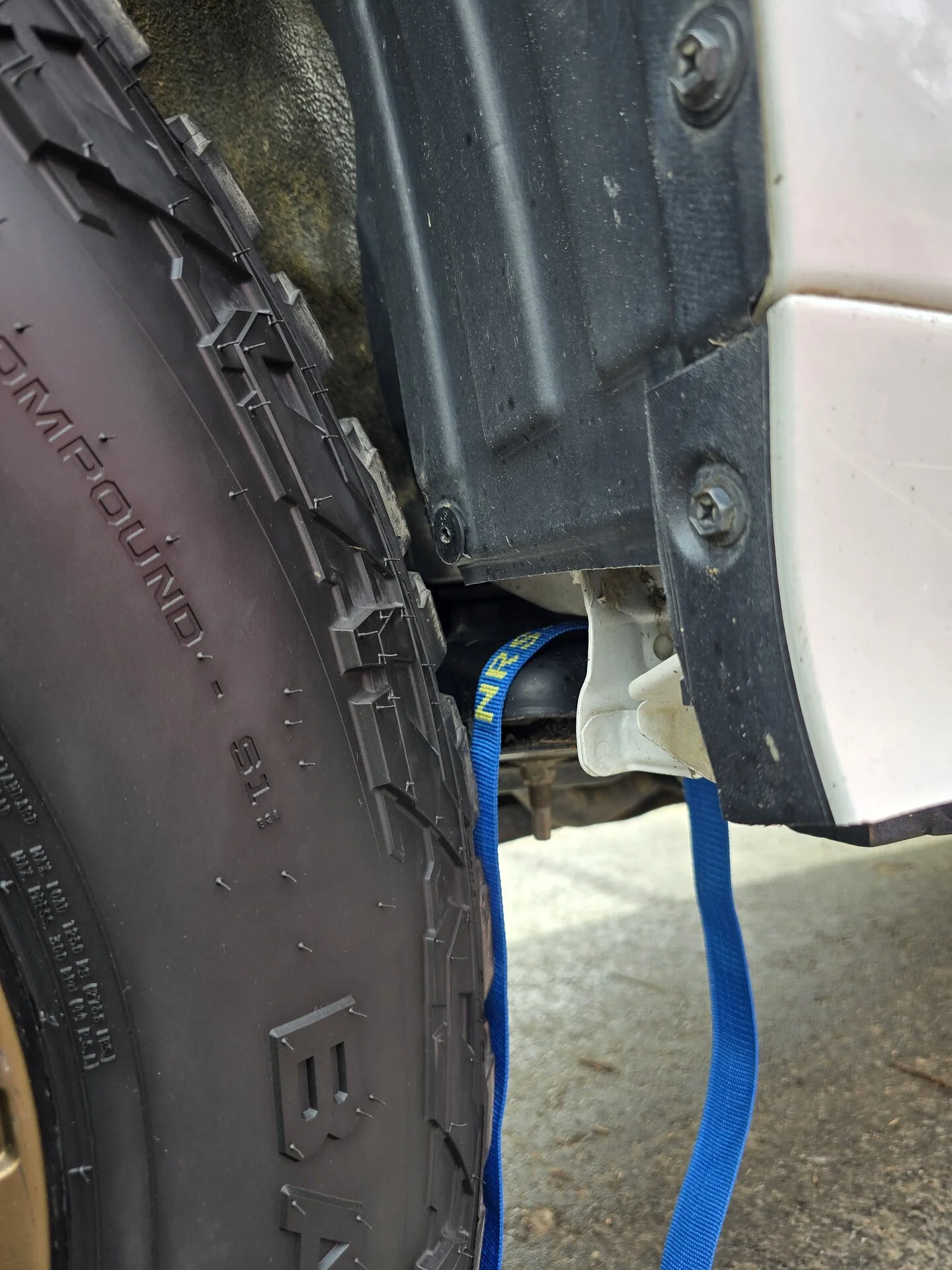

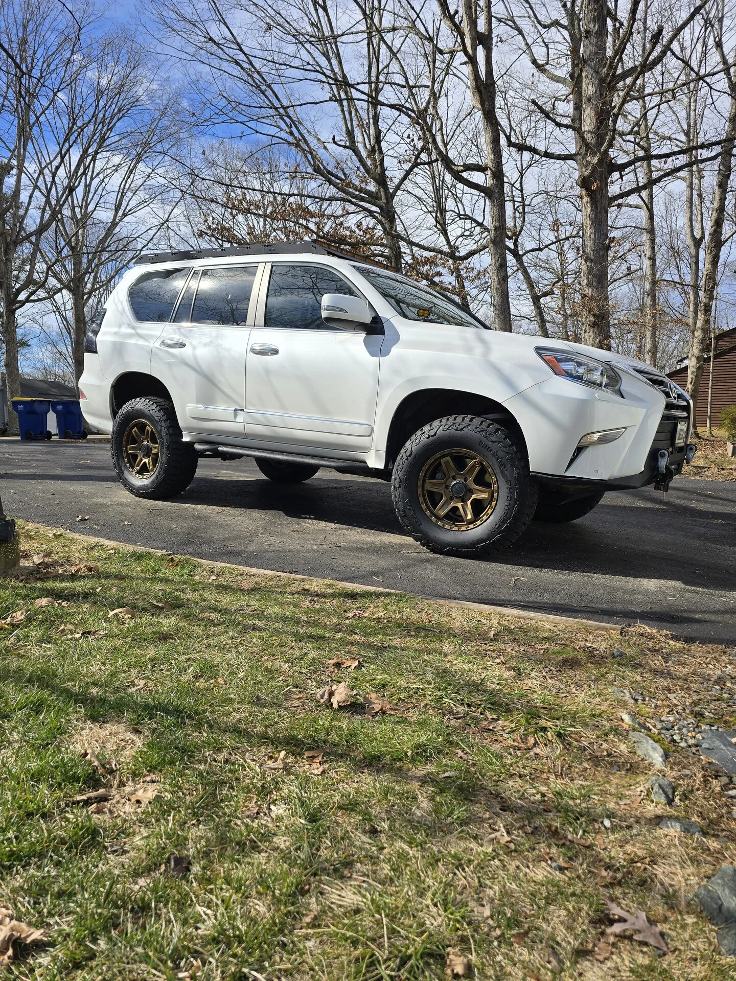

These are 285/70/17 (33s) with the trimming I did to fit 265/70/17 (32s). It doesn't rub on anything at static height, but using the world's worst plumb bob it does look like rubbing the body mount is possible when the suspension is compressed and turning. I might be able to get away with just pushing the fender liner back but it will be very very close. I have a little over a 2 inch lift (~2.2-2.3) and Ironman UCAs up front. There is plenty of clearance in the front of the fenders. It looks so good vs the 32s which were a little small after the lift.
