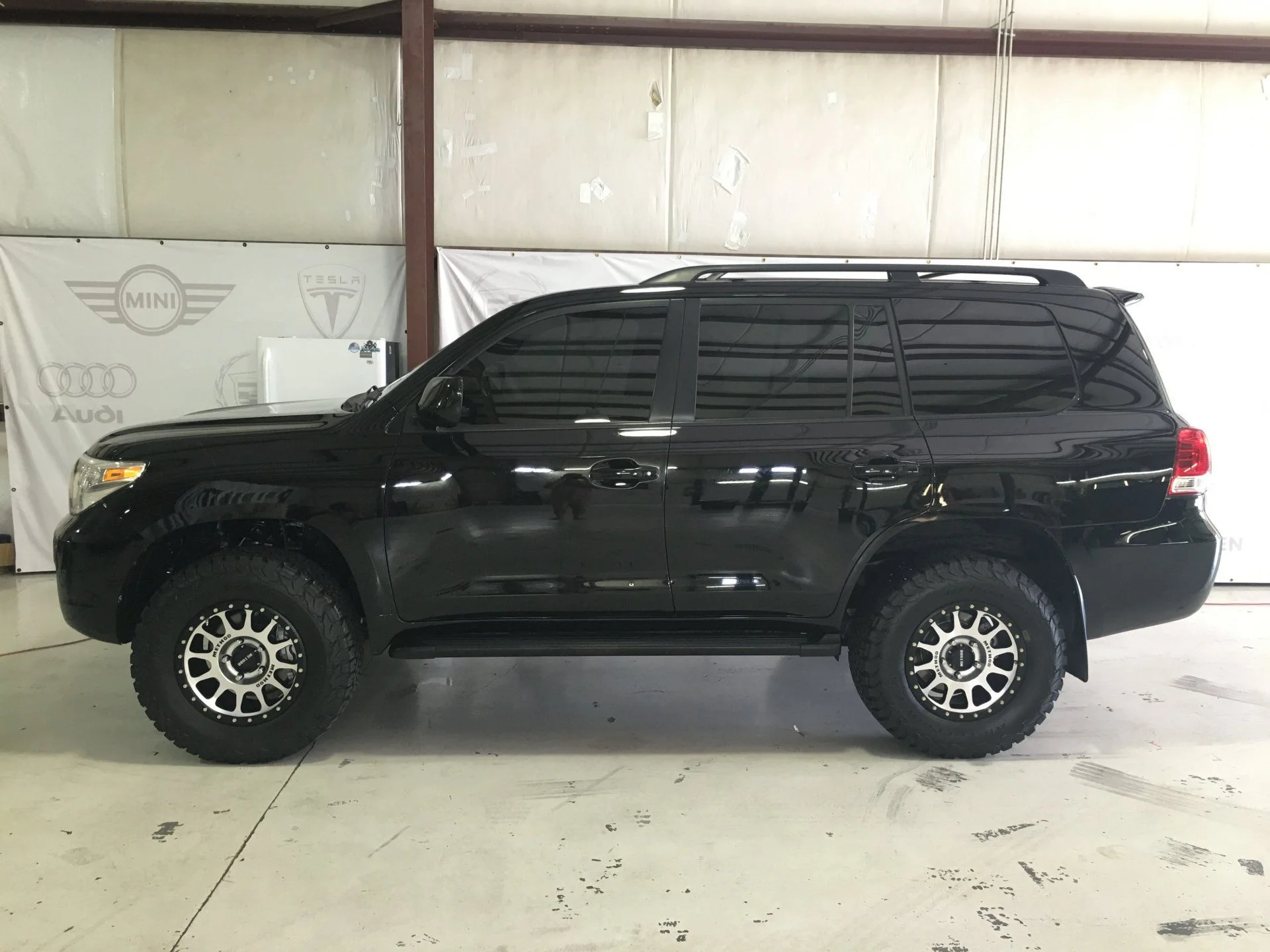

305/65/18 KO2 bust

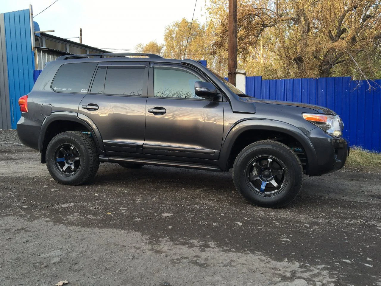

Stance with 0 offset wheels and 275/65/18 tires

My truck fits 305/65R18 Pretty well with the OME BP-51 at factory settings. Rubs at full lock in reverse, working on fixing that.

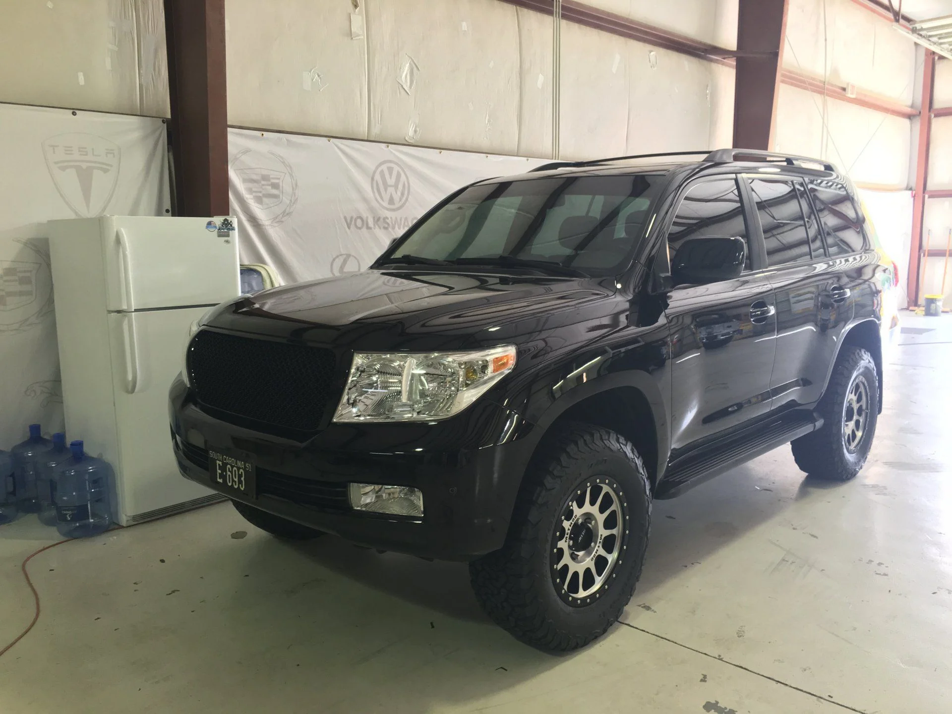

Nice rig. What tint is on your front windshield? Did you buy an aftermarket grill or black the stock out?
Have you flexed your LC with those 305's? When the shop put one on my rig that is OME lifted with Slee UCA the tire within a 1/4" of rubbing the LCA with my 20mm offset wheels.
