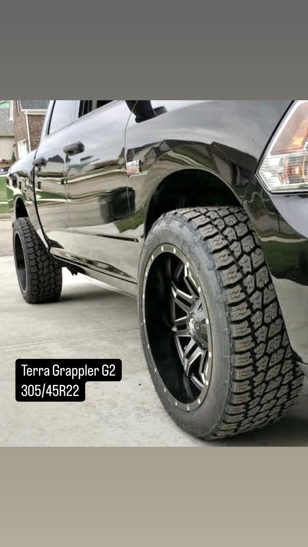

My current tires are 285/45r22 Terra Grappler G2
Im considering changing my tires
If you were to choose
Would you go with
305/45r22 Terra Grappler 118S
Or
33x12.5r22LT Ridge Grapplers 114Q
(305/45r22 Ridge is not available near my area)
305/45r22 Terra Grapplers 118S

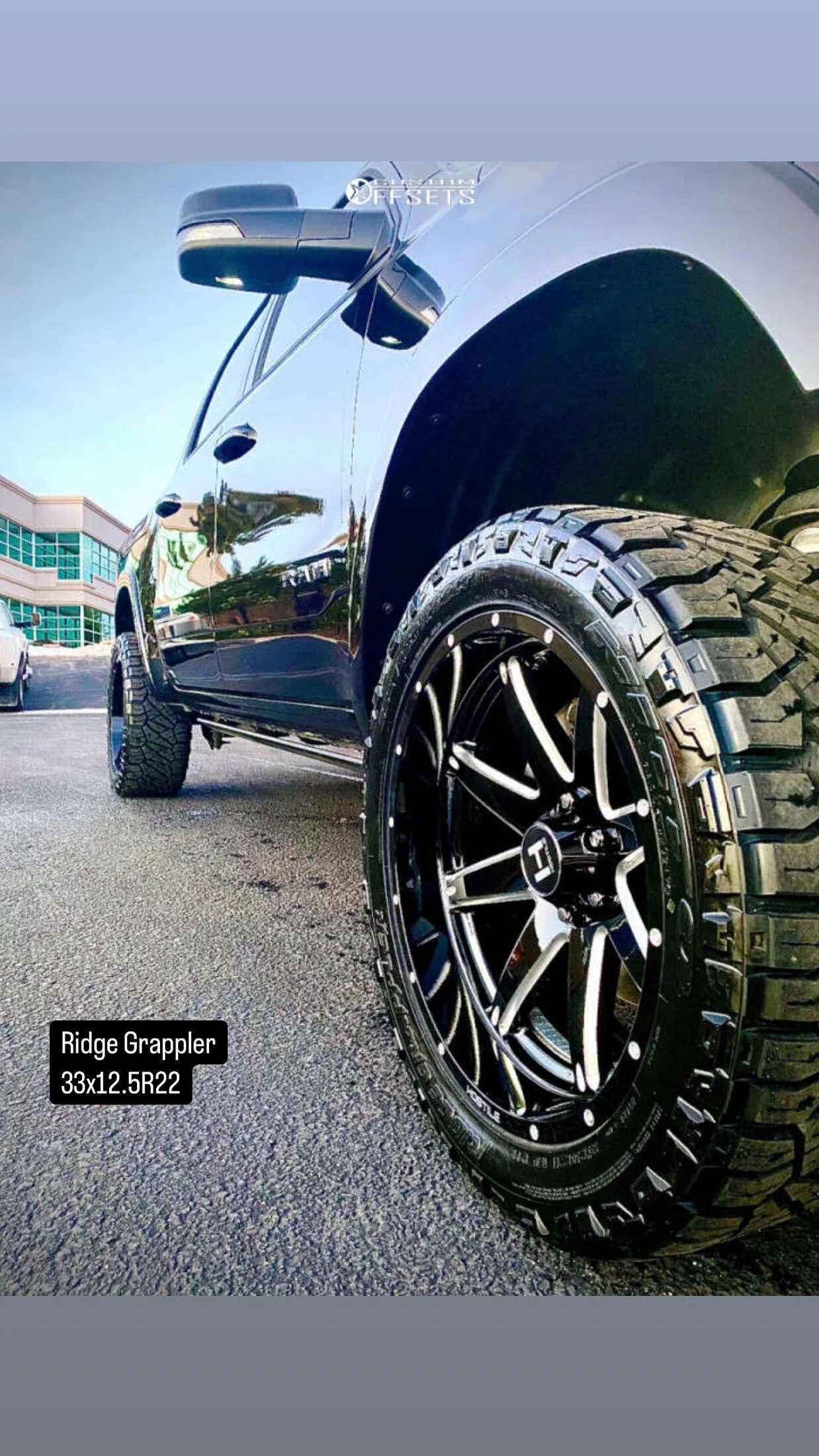

PROS
1. Looks Beefy and Wide
CONS
1. Heavy 62 lbs, will gas mileage increase significantly? might also affect acceleration/ handling
2. Lower speed rating Q
3. Lower load rating 114/2600 lbs at 80psi max (which I dont understand why, despite it being an F rated tire)

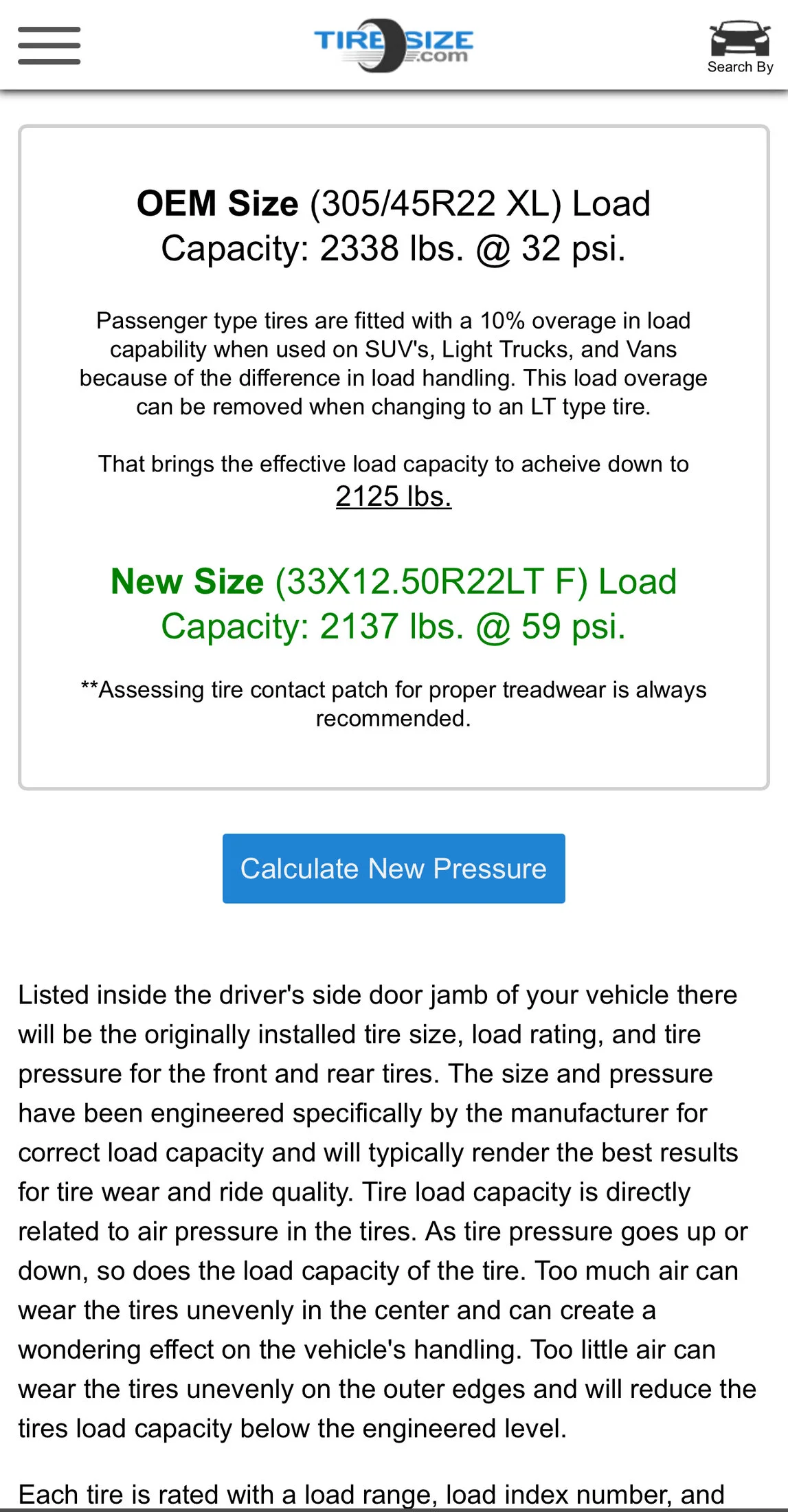

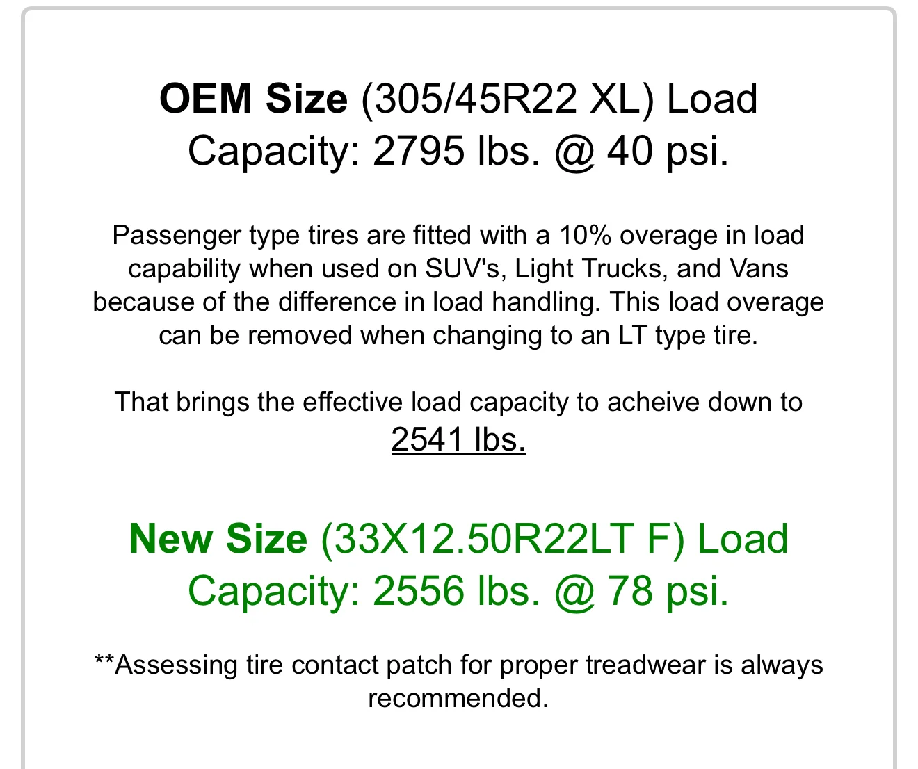

Thanks for the Toyo Article :)
I also saw this website
Which converts Passenger Tire Pressure to LT Pressure
I did a sample comparison for 305/45r22 and 33x12.5r22
Tire Pressure Calculator
For 305/45r22 hypothetically, if inflated @32psi it shows that it has a load rating of 2338/1.1 (adjusted load for suv)=2,125 lbs which is more than enough for Lc200 right? (2125*4=8,500 lbs)
Or would 35-40psi be better maybe for lesser rolling resistance?
Besides increasing load rating, Is there any advantage for running high psi Or its not really necessary?
I think you missed the most important first step in calculating Load Limits - determining the Load Limit for stock OEM tires on your vehicle.
For the LC200, that is a P285/60R18 tire @ 33psi which is a Load Limit of 2,512 lbs.
That means that P-Metric and ISO-Metric tires must meet or exceed a Load Limit of 2,512 lbs, and LT-Metric tires must meet or exceed 2,512/1.1 = 2,284 lbs.
Try your calcs again with these values.
Further, do not confuse a static load (like vehicle weight) with a dynamic load (like Load Limit). A tire must support loads greater than just the weight of the vehicle - e.g. cornering, hitting a curb,rock, pothole, etc.
HTH
Further to my last:
FYI, here's what that web site shows for the 33X12.50R22LT tires:
Which, I believe, agrees with my first recommendation.
HTH

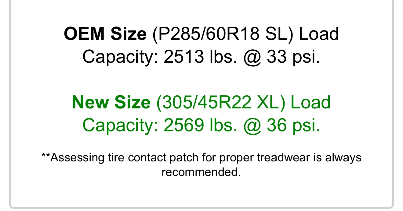

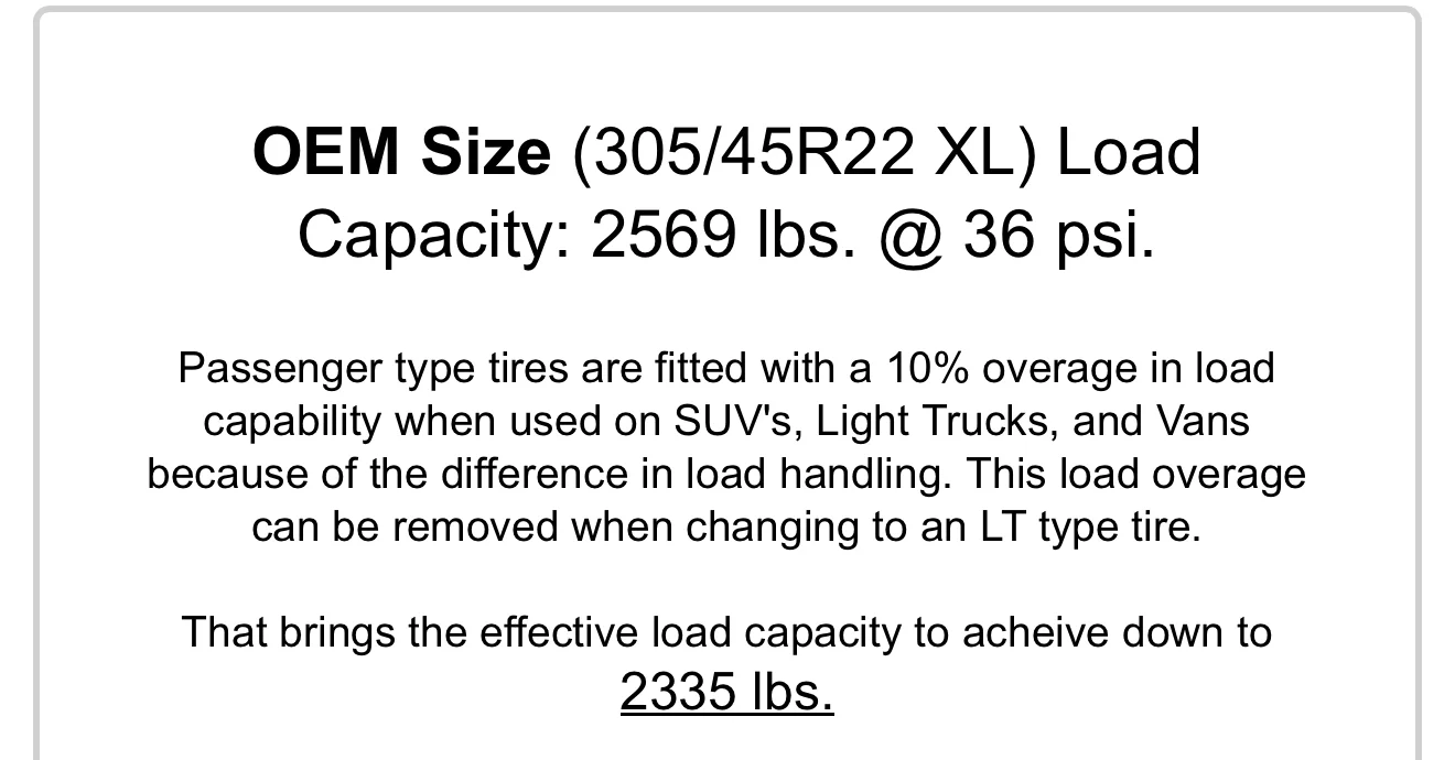

For 305/45r22 According to tire calculator I have to inflate at least 36psi To have 2569 lbs
Although I dont understand why they didn't divide the load capacity by 1.1
Because if I set the Oem size to 305/45r22 @36 psi then the website divides it by 1.1 which will become 2335 lbs only
Therefore (I’m not sure), does that mean I would need to run at least 40psi for 305/45r22
2795/1.1=2,541 lbs
And as for the 33x12.5r22LT ( it said that LT tires dont need 10% load overage)
But i think It might no longer be suitable for Land Cruiser? since 2556 @78psi and its already very near max allowable pressure of 80psi

OEM tire size is always P285/60R18 114 SL @ 33psi
Re-calculate with the correct OEM tire size.
