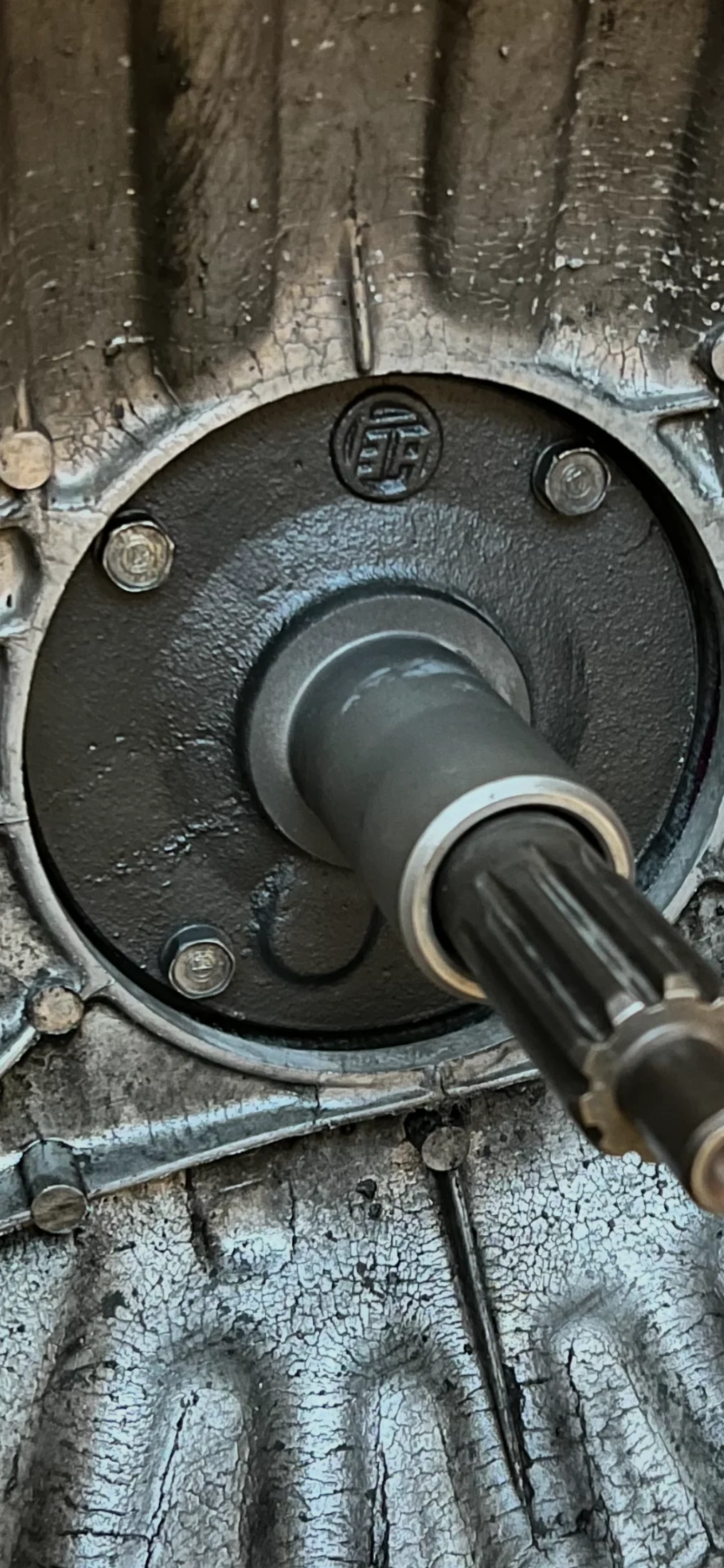

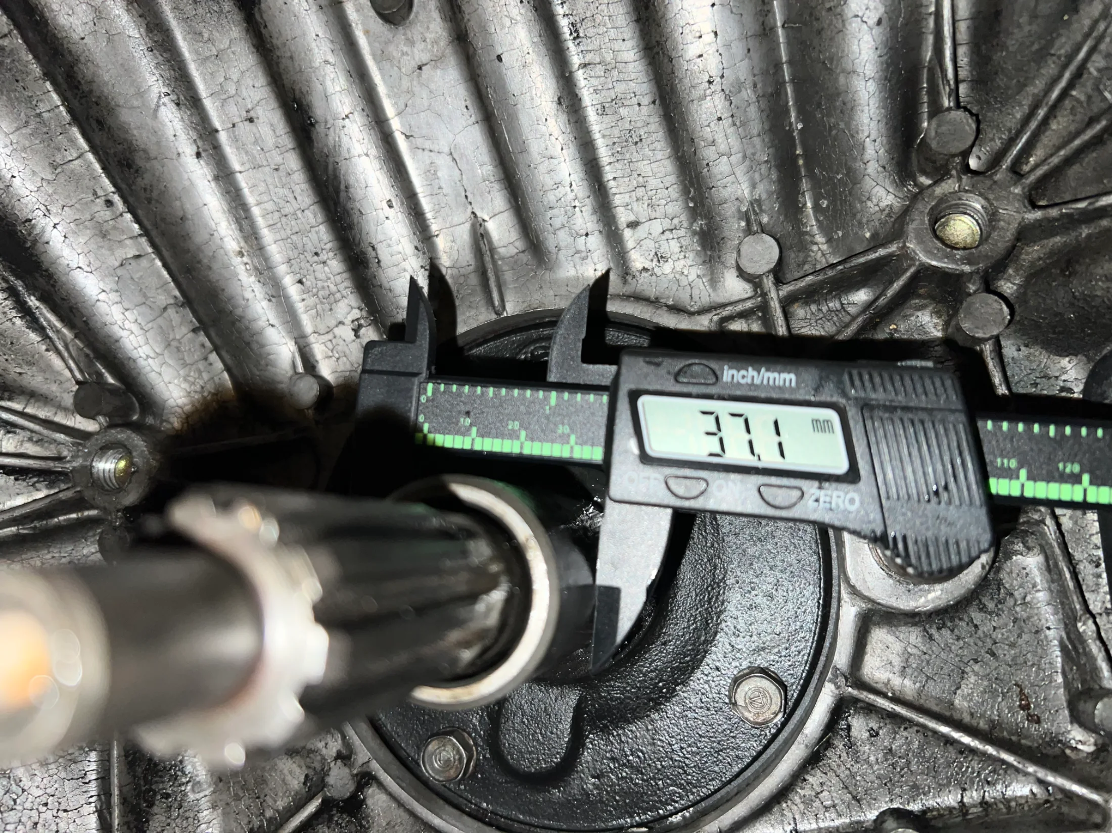

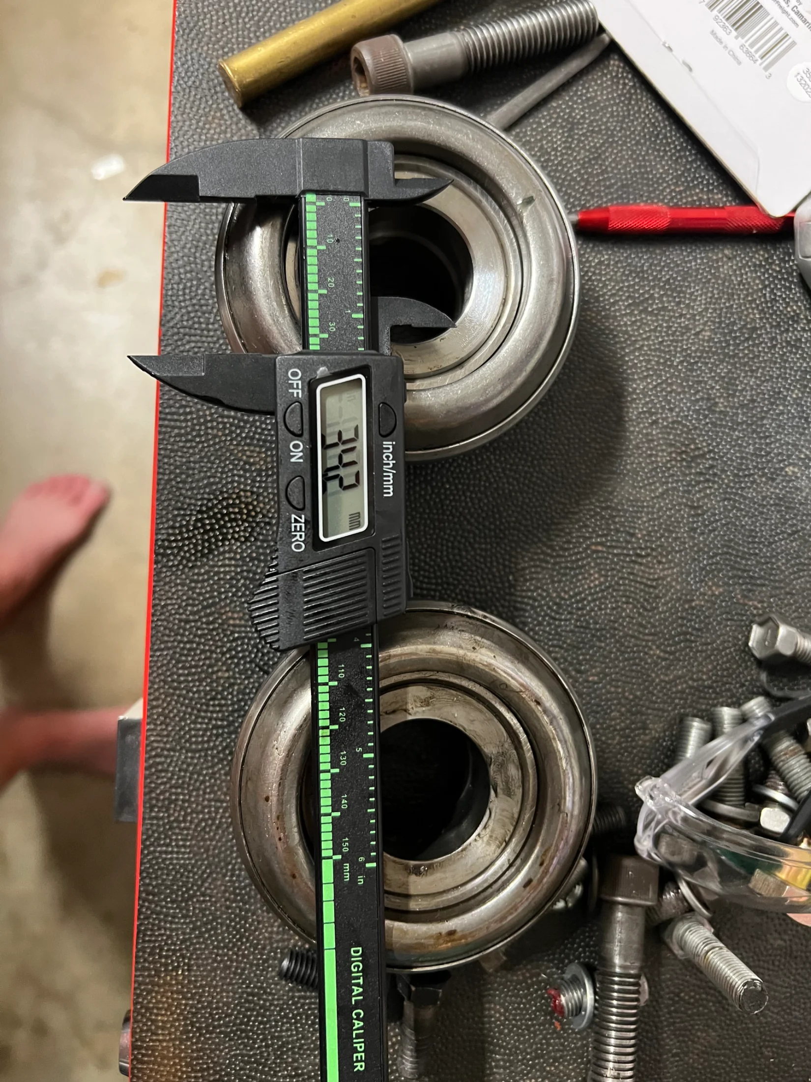

Has anyone seen this bearing retainer on 3 speed? It doesn’t have TEQ stamp, yet it was on my 3 speed? Other bearing retainers I’ve seen have the mfr. stamp.
Also the OD is bigger on stamped bearing retainer!
34.2 is OD of old one and 37.1 is OD of stamped one.
It’s a common thing with V8 conversions to turn down the OE retainer to accept a Chebby TO bearing. I have a few of them on the shelf for people who have damaged/broken snouts.
You guys are great!
Just, so I’m clear….. since I have the Chevota (V8 with Toyota 3 speed) I need to run the smaller OD retainer.?
Is the retainer easy to change as it looks. 4 bolts, new gasket and seal, then I’m good to go?
Mark, I’ll send you a PM and see if I can get one of your modified retainers on the shelf.
