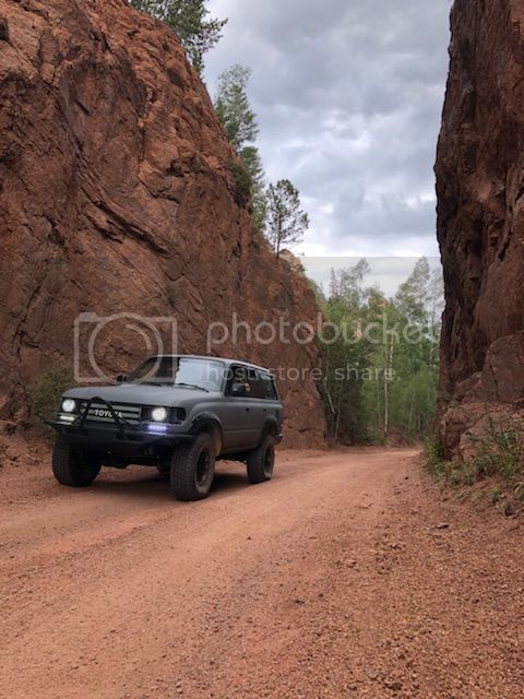

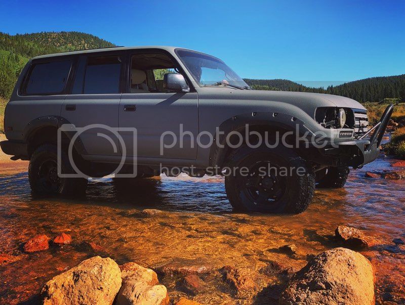

Hey guys! My current rig is a 97 fzj80 with just an old man emu 3" lift. Currently running 33's with way too much extra room. Have a friend with some toyo 385/70R16's that wants to make a trade with me to downsize. Anyone know if I can fit these comfortably? I understand I may need to do some trimming but I'm fine with that just as ling as there aren't any other issues I haven't thought of. I have stock gearing as well. Some pics to make it relevant.

Got home just fine, first impression: not nearly as rough as I was expecting .sure there's a little rubbing going in at the back of the front wheel well but overall not bad for just daily driving around town. Will need quite a bit of work before I can take it wheeling but that's no big deal. I have another 80 that needs some attention anyways.
