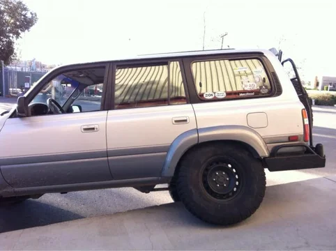

Wheel stuff pic. You can see on the rear part of the flare where it rubs.

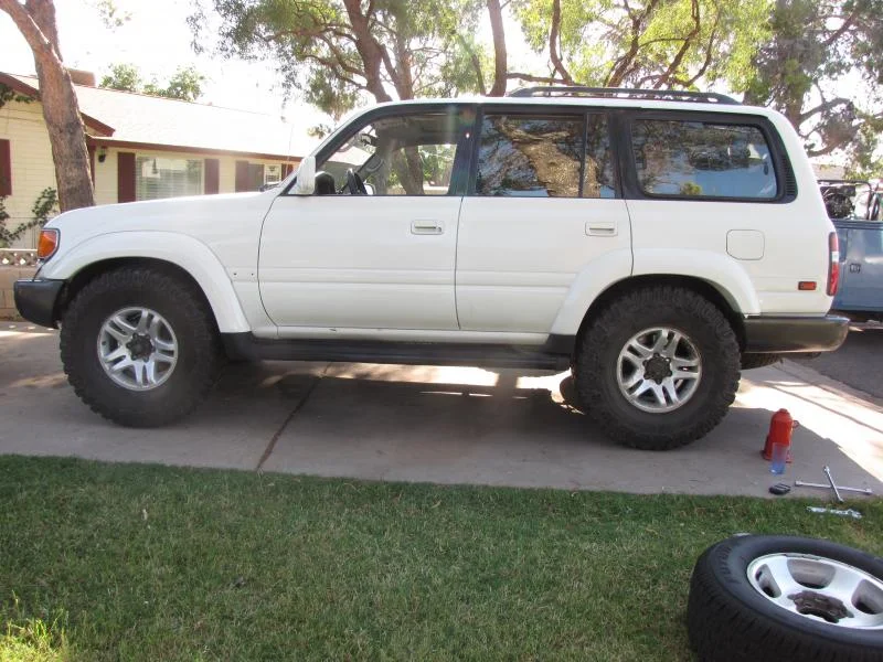

Here you go. I need to do some trimming on the rear to get more uptravel but the tires do tuck pretty nice. The front doesnt rub at all (I have left the swaybar on).
