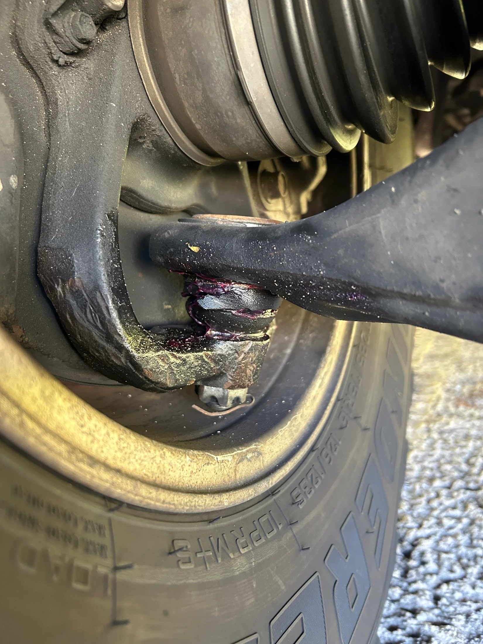

My 2002 LC had around 205,000 miles and I was getting a clunk from the LCA ball joint on the drivers side. The boot was in tact, but it was very obviously clunking on any dip, bump, turn, etc and I don't want to mess around with an LBJ popping while my wife and the kids are in the car.
With my tendency to want to always go OEM everything, but Toyota not selling just the OEM LBJ, I decided to install 555 ball joints instead of replacing the entire LCA at easily $300+ a side vs $55/side for the separate LBJ. I got the 555s from Cruiser Teq in January 2025, installed Mar 2025, failed sometime around August 2025.

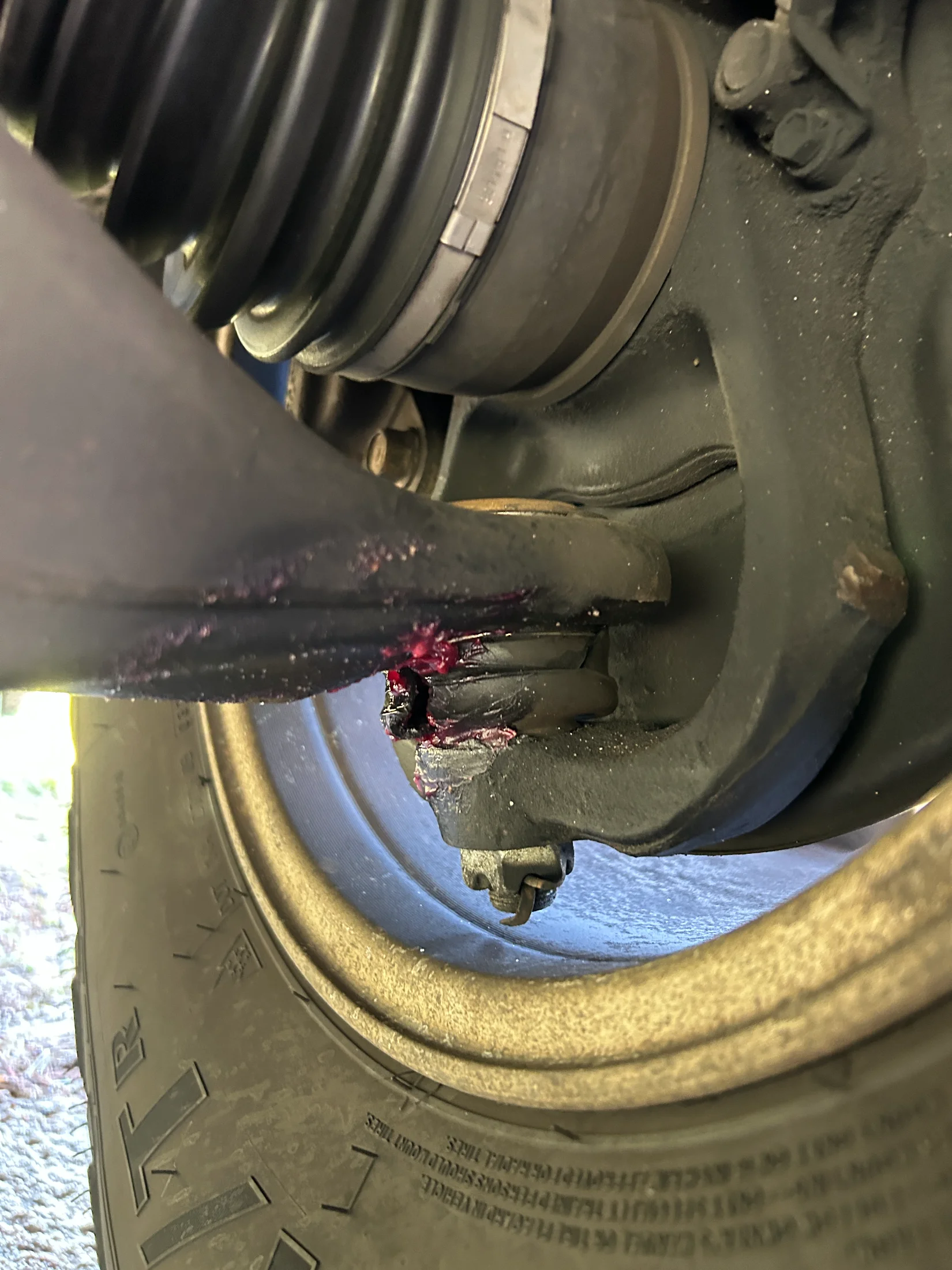

I had an independent Toyota master tech install the 555 ball joints and new bushings in the OEM arms and everything was fine, until this weekend when I was towing and heard some strange noises. I looked under the car and saw BOTH boots on each ball joint are torn, one extremely badly, and the other still quite bad. Pics below.
Being over 60 miles from home with a loaded trailer, I had no choice but to slap the only grease I had on hand in there and drive white knuckled home. It made it, but now I'm wishing I had just bought the factory Toyota complete arms with the true Toyota OEM LBJ and bushing already installed.

I'm sure many of you are gonna say your 555s have been fine, but for both sides to have failed in 3,500 miles, that seems insanely coincidental. There's no way I'm installing them again, or even bothering to re-boot them.
Was it improper installation? I don't think so. This tech is highly rated and when I reached out he said he'd never seen anything like this before.
Was it a bad batch of rubber on the 555s? Who knows!
Unlucky...
Hmm yeah but even if his tech beat up the knuckle why would that cause the boot to fail? cant imagine its bent that bad to cause both sides to fail but Idk
Not saying the hammer marks caused the failure, just that it's an indicator of someone that maybe uses force over finesse. Could be he pressed them on with the boots on and they got caught in the cup. They both looks like they're split evenly around the middle seam.
Very well could be the case. I’ll be installing the new OEM arms myself, for sure
I agree because it seems too coincidental that both failed, and if memory serves I asked if he had to pull the boots off and he said yes.
Doesn’t mean it wasn’t just forced in anyway but I’d certainly hope a shop like that isn’t doing it the wrong way

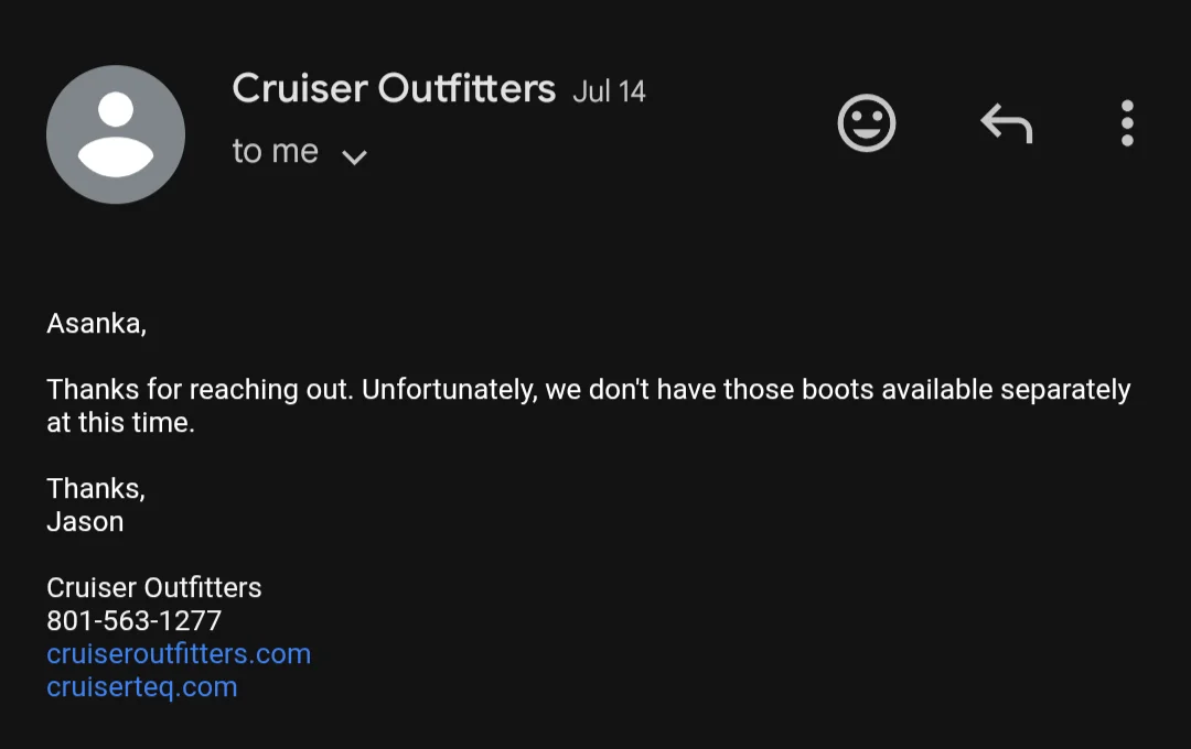

Did you look to see if you can just buy new boots? You actually can for the OEM uppers and lowers, at about $10 each. I rebooted my LX, as the boots cracked but the joints were still solid at 230k. I thought it was worth a try, and 15k later still no issues.

Another odd thing in your pic is the cotter pin on the first pic. Did you pull it before the pic for something? If not, it’s not in all the way and could have led to the nut loosening and potentially cause the failure.
